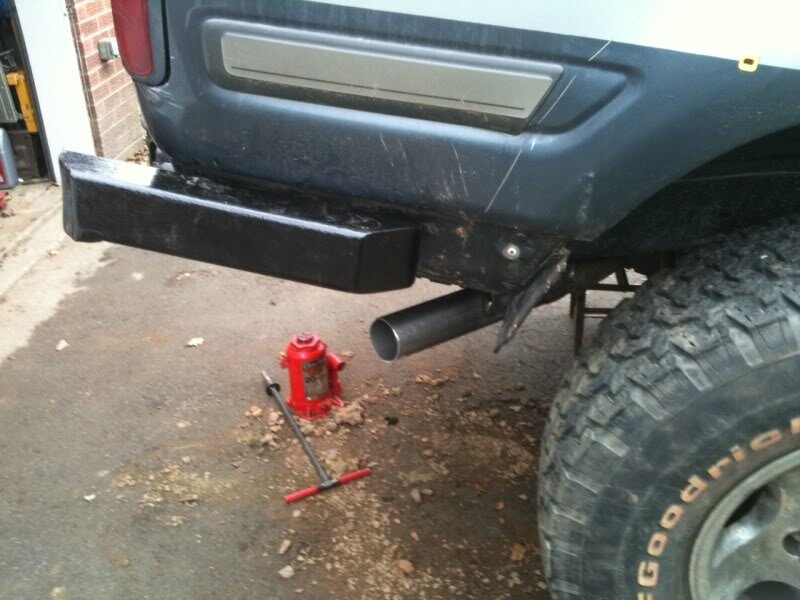

Straight through side exhaust anyone? Very solid. Sounds very nice.

Well I hope it works out better. The original just kept getting bashed and squashed. I reversed into several banks an d stuffed the end into the soil. So hopefully this will be out of the way.. I can lengthen it or put a bend on then if necessary. I used the original mounting point by unbolting it and moving it forward on the chassis, just using two of the four bolts. It's the most over-engineered tailpipe mount I have ever seen. Two bolts will be enough.

Quick edit on the exhaust. Blimey Charlie, it goes like stink. Refuse to believe that removing the last resonator box makes that much difference. But woof woof!

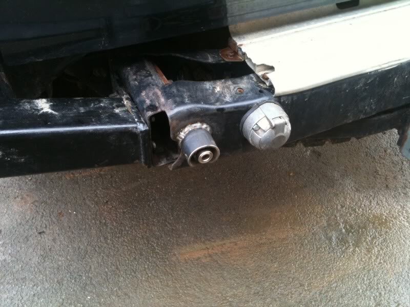

Next was to take off the towbar and fit a Dixon-Bate that I've had lying around for a while, that went smoothly but I will need a new towing socket that I can fit through the bumper at a later date. It is good for recovery just now and that's what I need.
