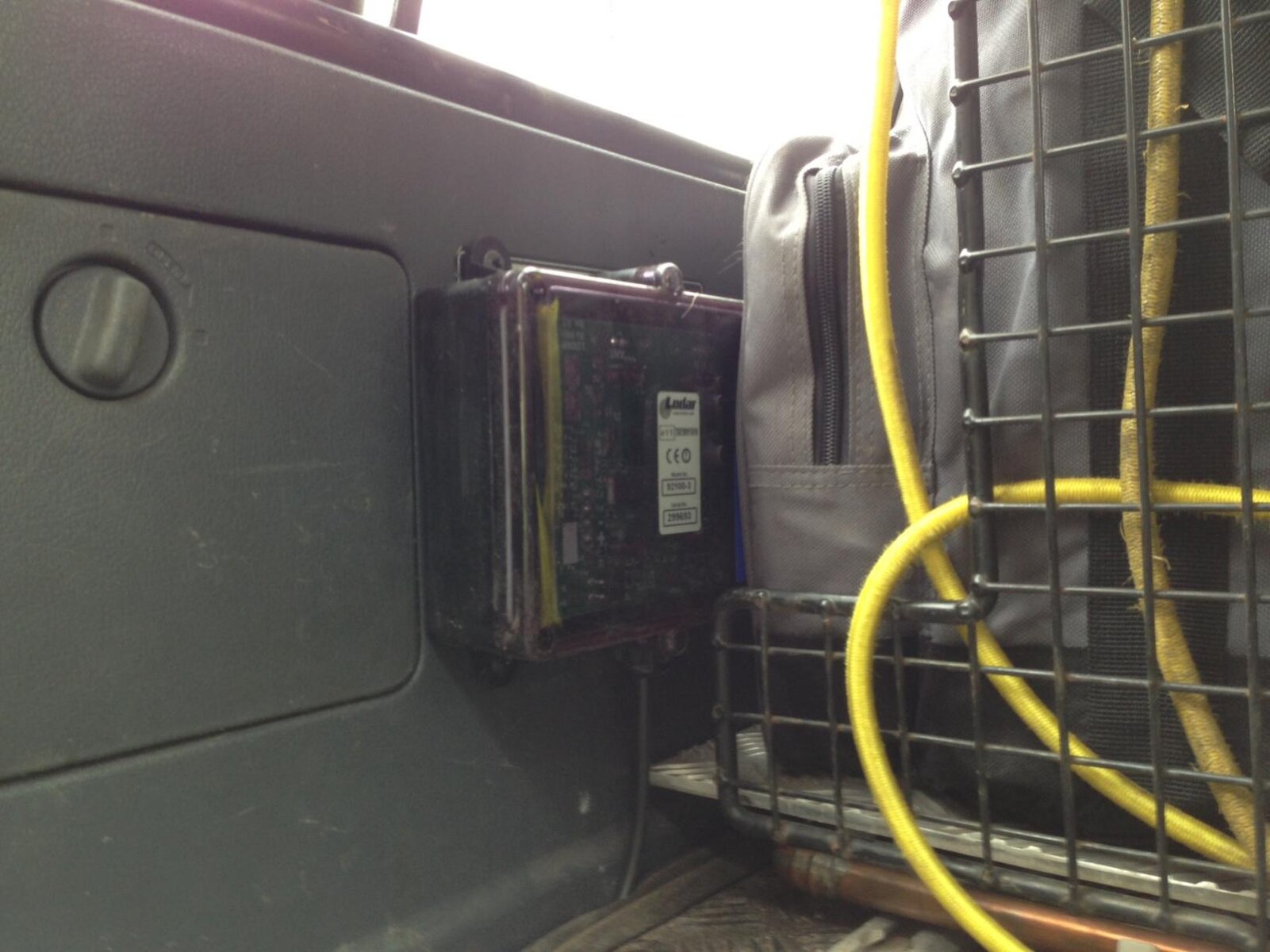

Here's one of the boxes. It's the perfect place for it in my install actually.
The front one is in the grille, facing backwards. I made up some brackets and popped it in there so it's easy to get to.
Chris
