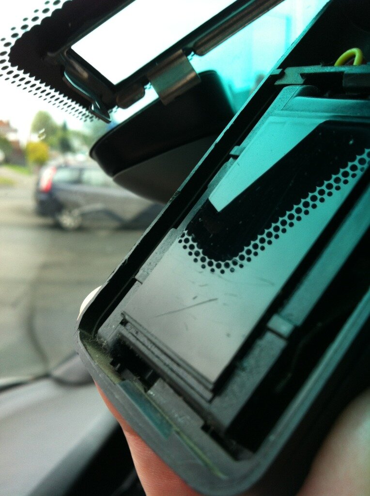

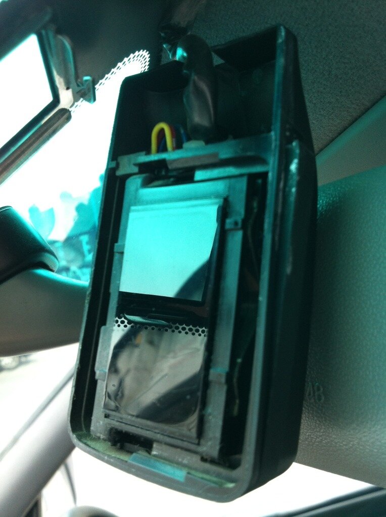

Hi all, I've been having exactly the same problem.
Here are 2 photo's of my sensor:
do you think the tape is missing? or stuck to the sensor?
There doesn't seem to be anything on the screen at all.
