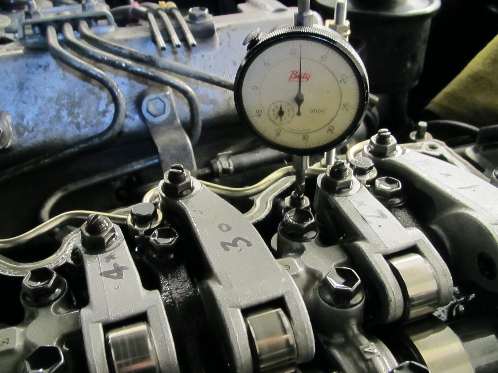

The 12 washers come in a set of 6 which each comprise 2 parallel washers joined by a link. valve overlap 002.JPG
Between the adjusting screws on rockers 4 and 5 you can see the banjo and the thin vertical link joining the two "washers" together.
