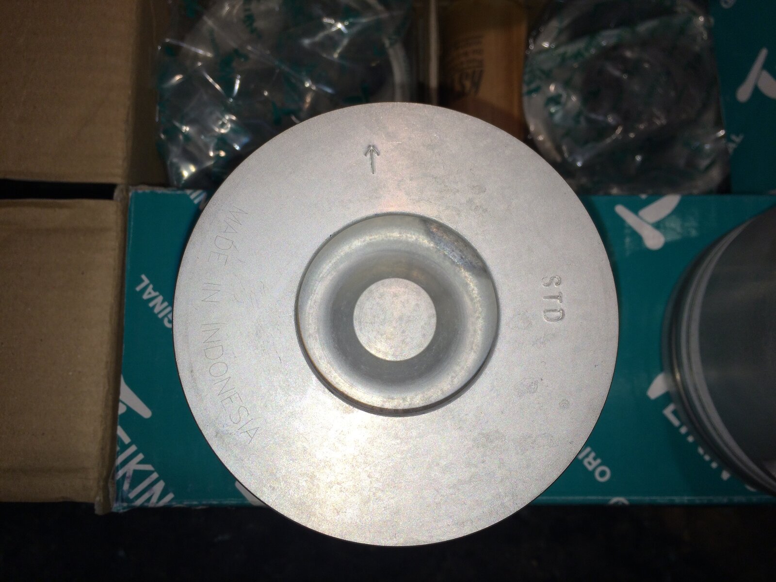

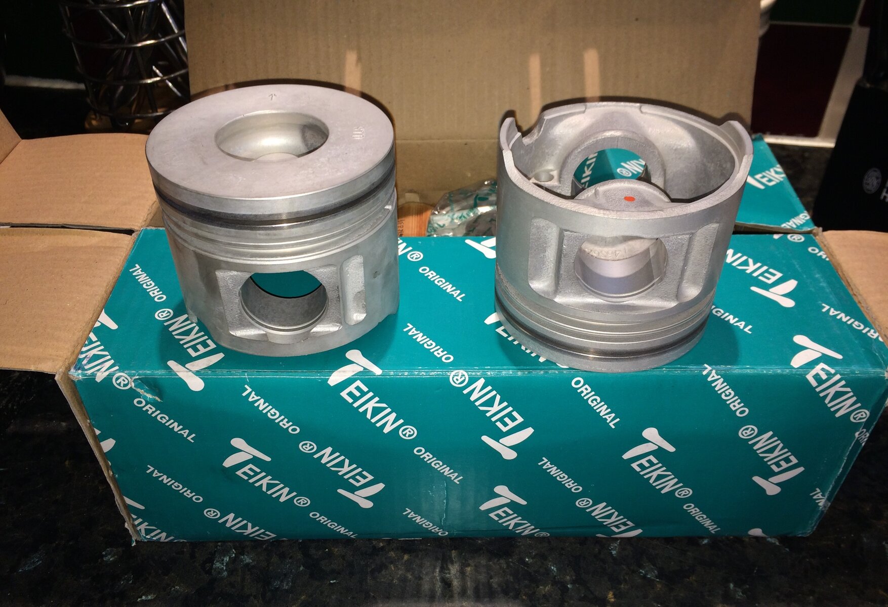

Post pictures of the new pistons Del' :icon-biggrin:.
I will do when I get them I'll put a few pictures of it going back together as well everybody loves a little bit of engine porn

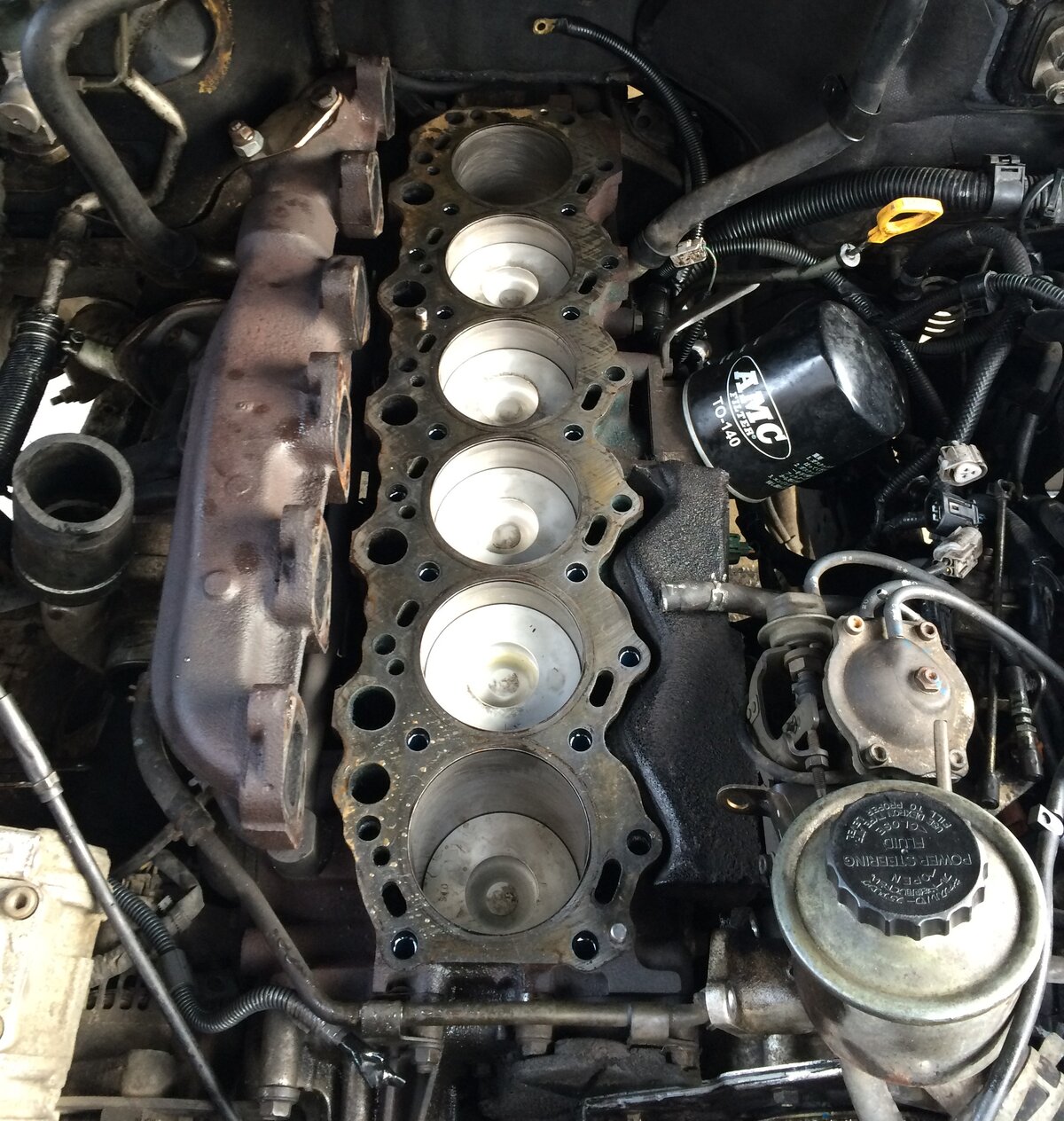

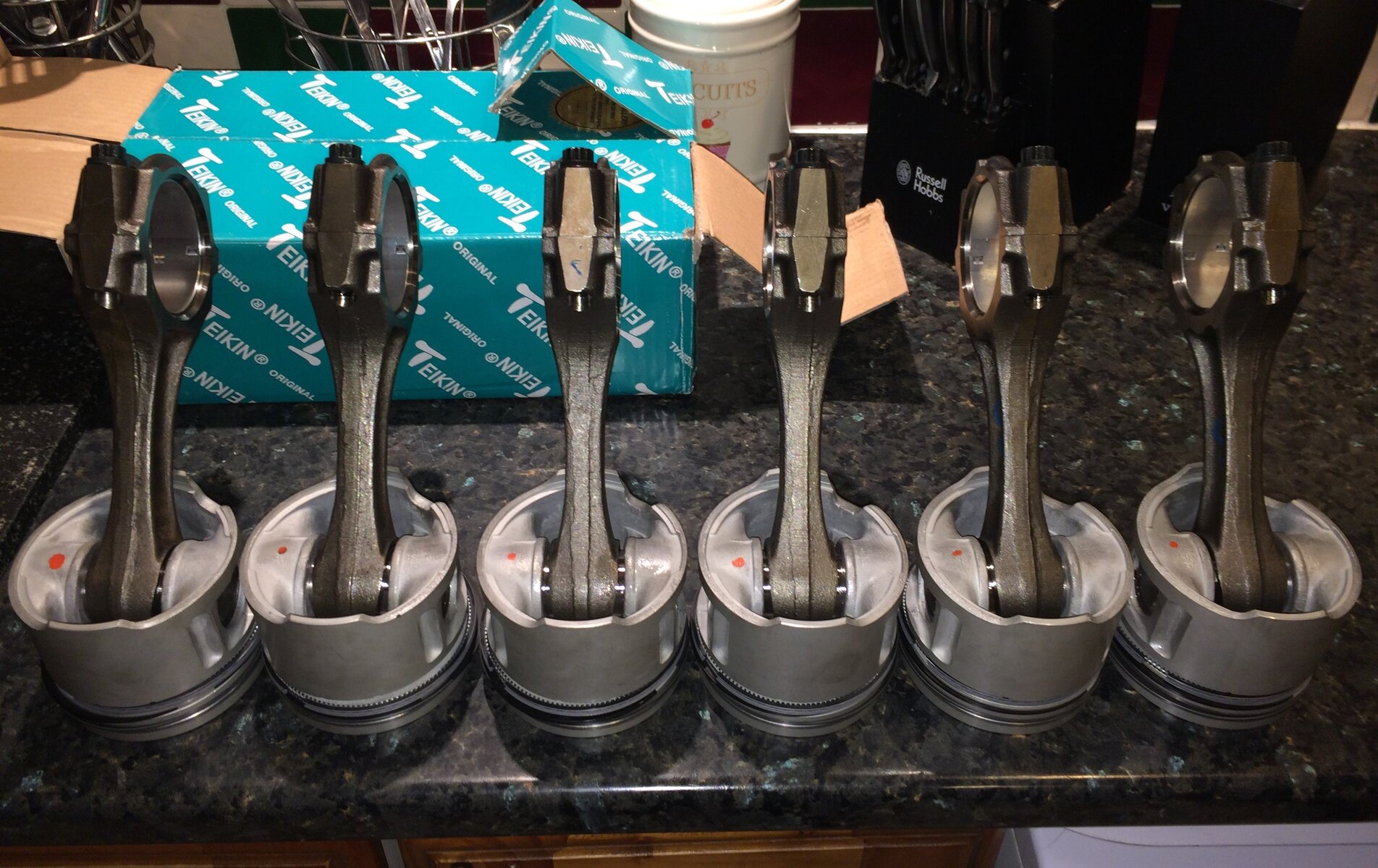

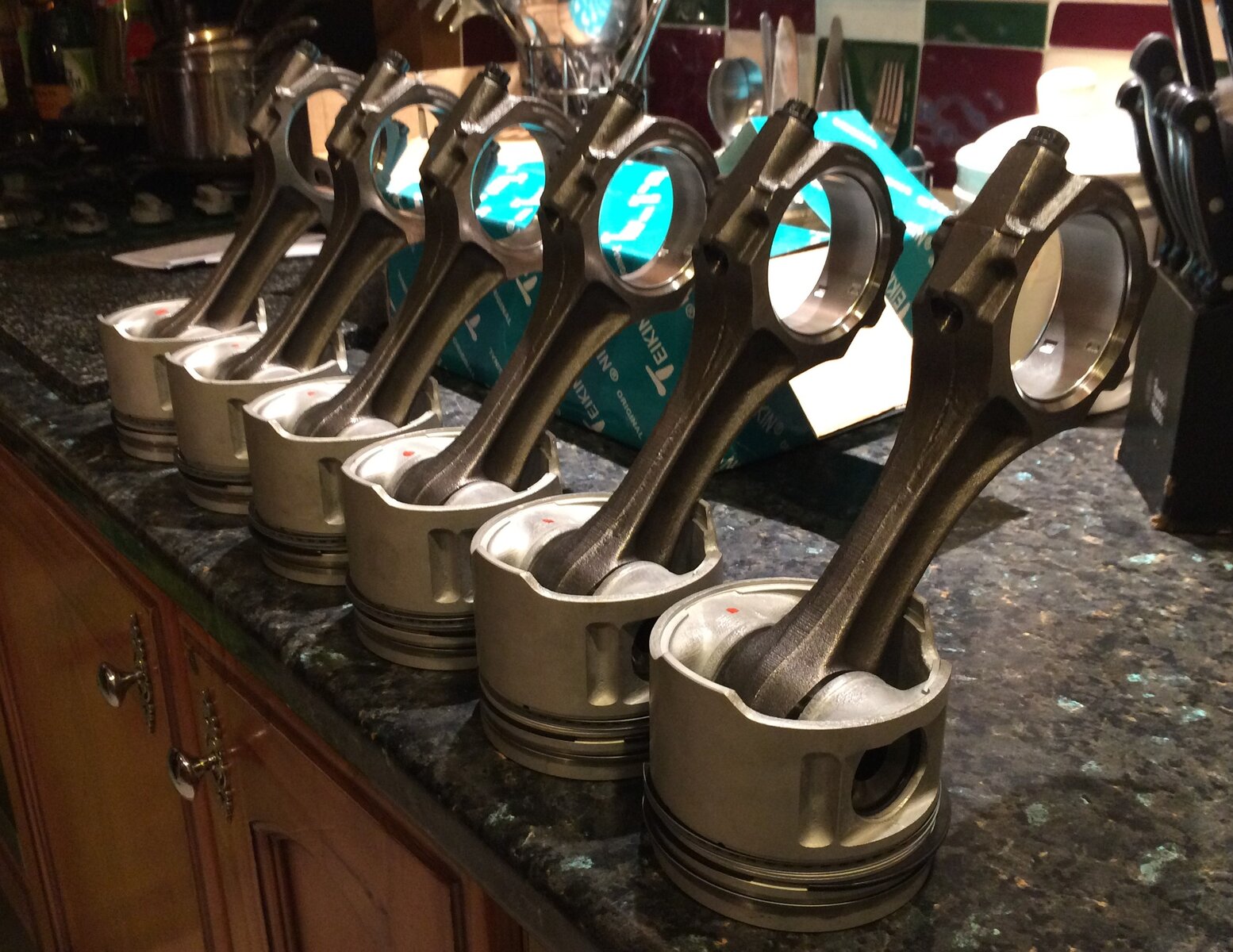

some pictures as promised, all built up and ready to go back in lets just hope it doesn't rain tomorrow IMG_1464.JPGIMG_1466.JPGIMG_1467.JPGIMG_1468.JPGIMG_1470.JPG
got a lot done today and its getting there should have it running tomorrow :pray:IMG_1472.JPGIMG_1476.JPG

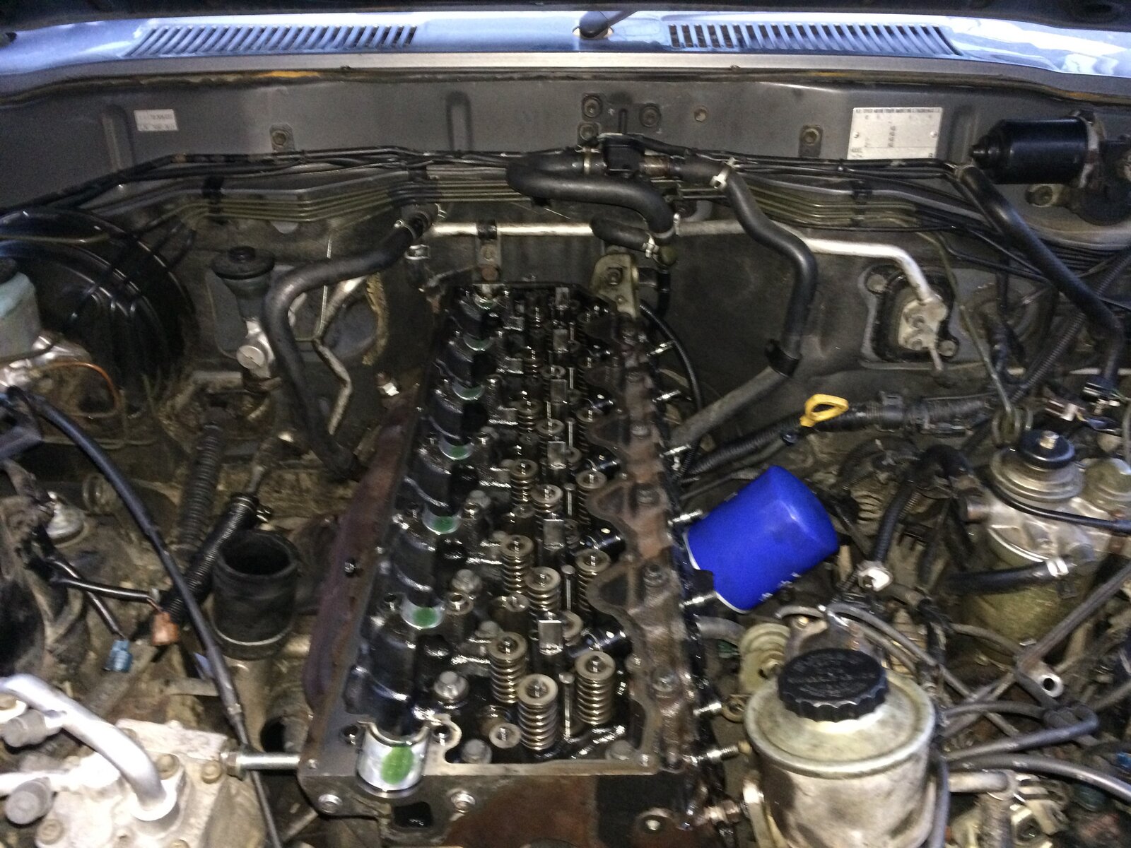

How did you get the head on in the end kev?
I borrowed an engine lift my in the end but I still had to man handle it on the bar on the engine lift wasn't long enough with the winch bumper so I'm just hoping I haven't damaged the head gasket putting it on so fingers crossed
Hope the rebuild turns out OK. Seems to be going well so far:thumbup:. As far as the claim for damages goes I don't think you stand much chance personally unless you have very deep pockets, and even then? As has been said, irrefutable proof of the cause is required and very difficult if not virtually impossible to obtain. Just been reading the usage instructions and is does warn that an RPM increase and some knocking will occur. You yourself and others in the thread have said that you have used the product before on other vehicles with no ill effects and the manufacturer will probably have 100's if not 1000's more testimonies as to it's successful use. It's a tested/proven product from a multinational Co. and understandably they're going to protect their brand name with everything they've got as a successful claim would cost them far more than the cost of paying you out. Sorry to be so negative but JMO.

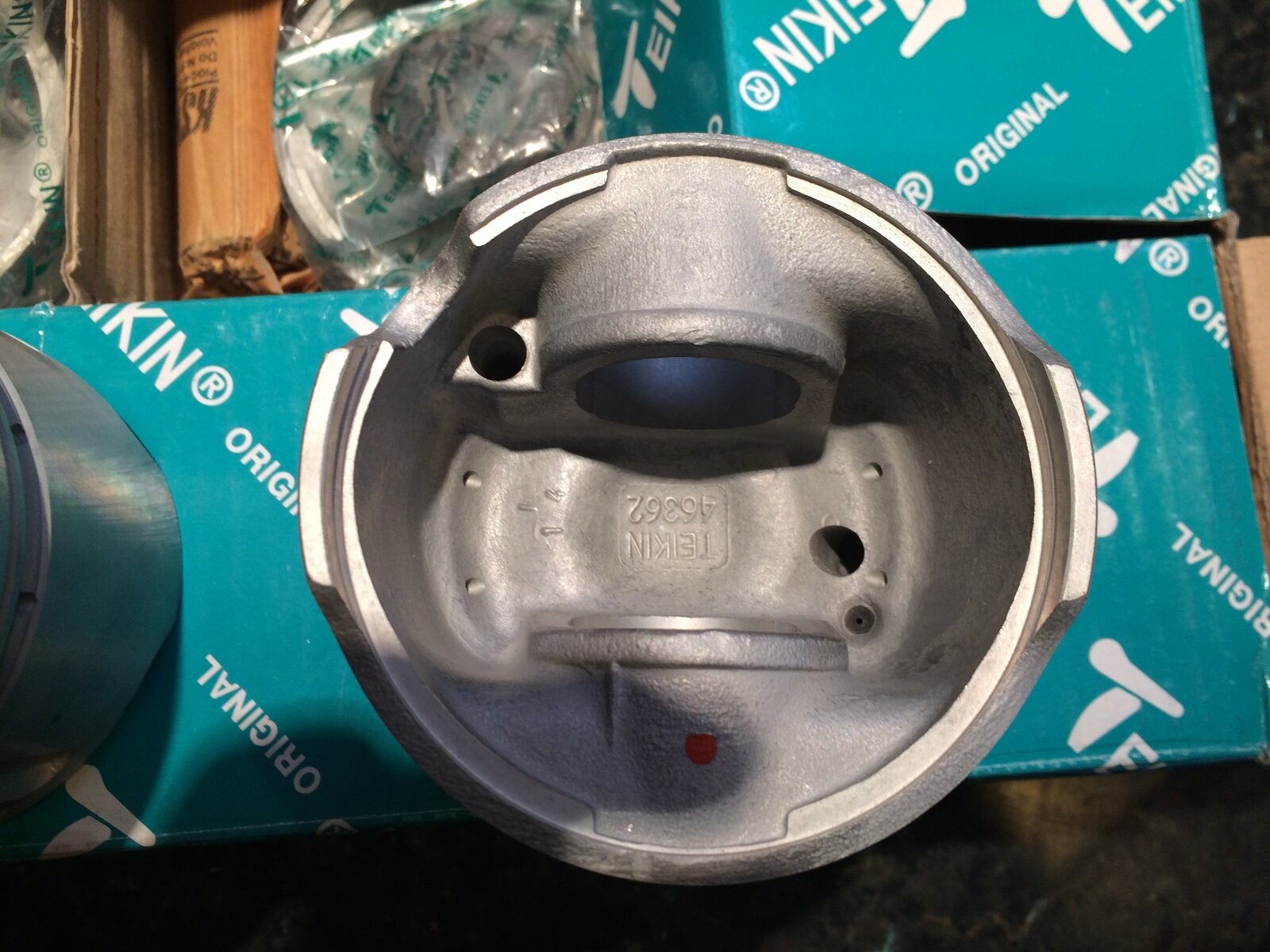

Are those holes in the pistons for the oil cooling pipes to feed the gallery in the crown?
Interesting observation there Frank, it certainly looks like when the piston is at the bottom of its stroke it engages with the upward facing spray nozzle via the cutout in the skirt (which of course means there is a right and a wrong way for the pistons to go in). Interesting if the oil runs round a gallery inside the crown of the piston and exits through the hole the other side to aid cooling.
Which begs the question in my mind, are these pistons the same on the original, on the 12 valve too, or are these pistons that are now in up rated ones similar to those used for marine use?
Oh, and don't forget the oil!!! [emoji33]
It looks that way frank one of the holes is directly above the oil nozzle when the piston in at bdc. The new Pistons seem pretty good quality too the only difference is they use proper circlips instead of snap rings holding the pin in and it looks like the lands for the top ring are made of steel
