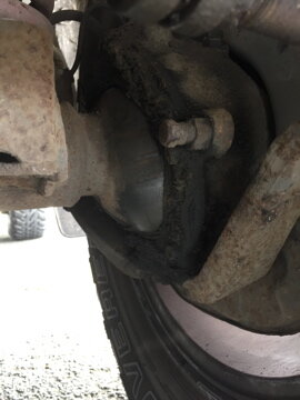

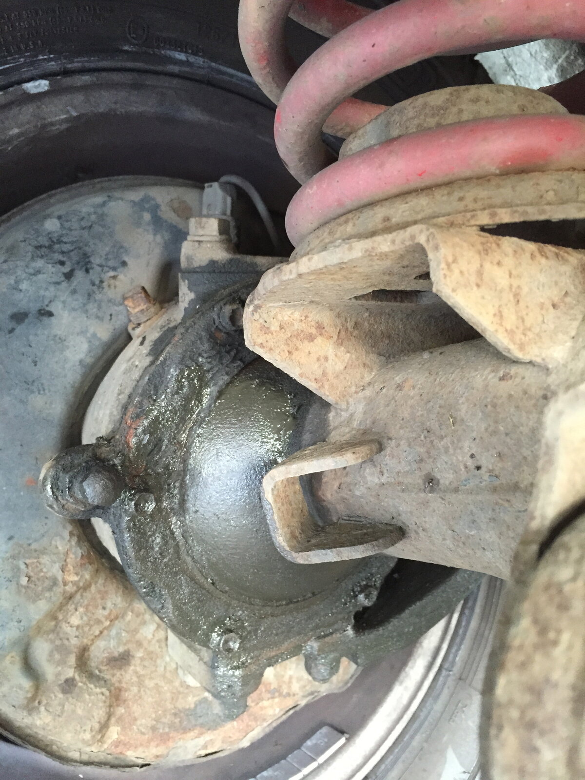

Checked the axle:
Diff oil - a little sludgy, but not desperate - slight green tinge to it.
O/S - wet - see below - checked the level with a cable tie - came out with grease on it, although low down.
N/S - pretty much dry, can see wipe marks from the seal - checked the level and again came out with grease, but low down.
So... figure on a strip down and replace the relevant seals etc.

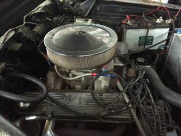

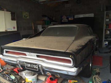

Also, whilst I was out prodding about I took a couple of snaps of the longer term project - "Bane" - Jan's 440 Charger (just for Karl) :whistle:

Dodge Charger 440! :thumbup::thumbup: An iconic muscle car if ever there was one. Whenever I see one I think of the car chase in Bullitt. Is in the RT version? I'm sure Top Gear's Richard Hammond has or had one and they can fetch big money in good nick.
Dave your swivels do leak a bit but after those pics, you've probably got the whole membership dribbling...:icon-cool: that is one serious piece of hardware there and in the right colour..
Love it..
:icon-cool: Charger and classic Mustang get all the attention but for me a 69 Camaro ticks all the same boxes plus an additional one :icon-cool:
Sorry, took the thread off course there.
No, its not an RT, its an ex drag racer that we started to restore and get back on the road - the 440 is running a 4 barrel and is around 400 bhp, give or take. Its pretty solid, though its got some bubbling on the arches etc - floor is solid and we've already done the suspension, brakes, etc. Lots of fettling still to do, plus window winders, interior, put in a demister system - that kid of thing.

OK back to the swivels, looking at your balls (calm yourself), they are similar to mine in that they appear to have a speckled surface rust appearance? On the Land Rovers the swivels can be changed with a spanner but on the LC if they cannot be tidied up they have to be cut off and new ones welded back...correctly aligned. Anyone done this? Is there an alignment 'notch' so you do not screw up the fitment?
In the states it seems they clean and paint them with something like POR15? Leaves the surface smooth and the outer seal does not scuff and leak later on.

You will most likely have to replace the taper roller king pin bearings, similar to LR. Get bearing number off the old ones. They wear badly as they are preloaded which is set by shims. The workshop manual is good, also Chris's write up.
Might not be worth doing if you check the state of the new dif oil regularly. Adding grease will help save the cvj's, other than those not much to damage.
