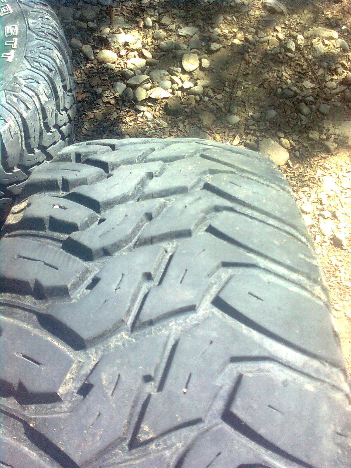

have you measured the length of the steering arms where they come off of the rack maybe one is longer then the other?
is the wear on the inside of the tyre or out side?
is it on the nearside or off side?
if front near side it might be cornering to fast and the front understeering this is why we rotate tyres
do you turn one way a lot more then another?
did you have it tracked with this tyre fitted?
it does look like tracking
do you have a bent wishbone?

ive got a new pair of cooper AT3s on the front now & will be looking closely at the wear.The tracking was done about two weeks ago , with the camber & castor checked at the same time - some small adjustments on the tracking but nothing excessive.The truck gets driven gently both on & of road so no drilling it into corners.On a straight flat motorway ,at 70 MPH it rolls along straight as a die - two years ago i had all the suspension bushes changed so i know what it feels like when something amiss with the suspension /sterring.as for a bent wishbone i think it would take a big impact to bend it & there is no evidence of any impact that would cause this.
I think oversize tyres will wear on the outer edge regardless , the 285/75's on my collie need flipping to even them up despite regular rotation . Perhaps its my own fault driving on them for 2 years without having tracking done and with a worn trailing arm bush on the rear , both have been fixed now but only new tyres will tell me for sure whether or not the wear is part and parcel with oversize or the faults now remedied were the cause .
