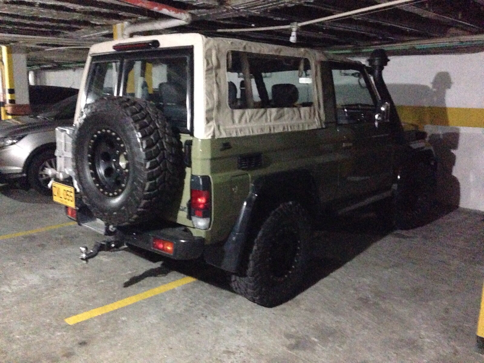

My mate in Columbia has done it to his project 74. Have you got the removable door tops?
Hes done a bloody fine job of it!
Not sure where he got the soft top kit from but can ask him for you...
Looks great, has the FRP section been retained over the front seat area?

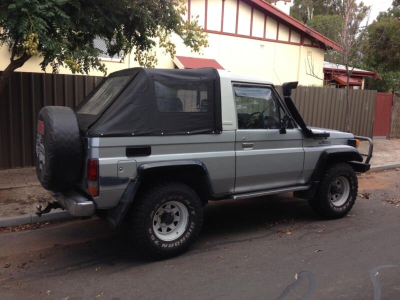

Chris, Here is a pic of mine. It was converted by previous owner. had roof cut behind front seats and rear doors cut down the rest was done by an auto trimmer.
I'm also looking to retain the front section of the FRP, what's the detail like where the soft top meets the FRP / Roll bar? Much water ingress or is it pretty tight
There is an aluminium channel that is attached to the FRP top which a rope guide sewn into the canvas slides into. its reasonably water tight only time I have had water getting inside was when I pressure wash the car.
