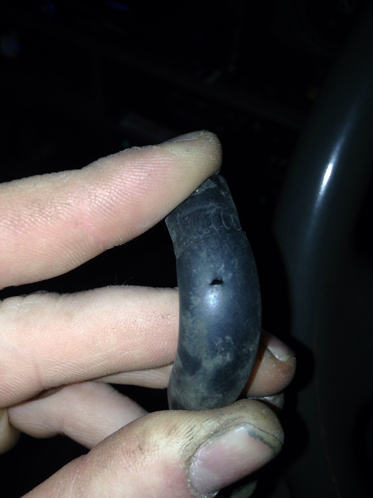

do you want to know what it is/was?? After all you kept saying about the boost pressure got me wondering?? So I changed every vacuum hose I could see to new ones and the last I done was the one!! Lol
It was the turbo wastegate actuator pipe!!
Mo tested every hose with 50 psi on the works compessor gun and the only one that leaked was that one!
And behold she flies again!! Lol I'll post a pic of the culprit.

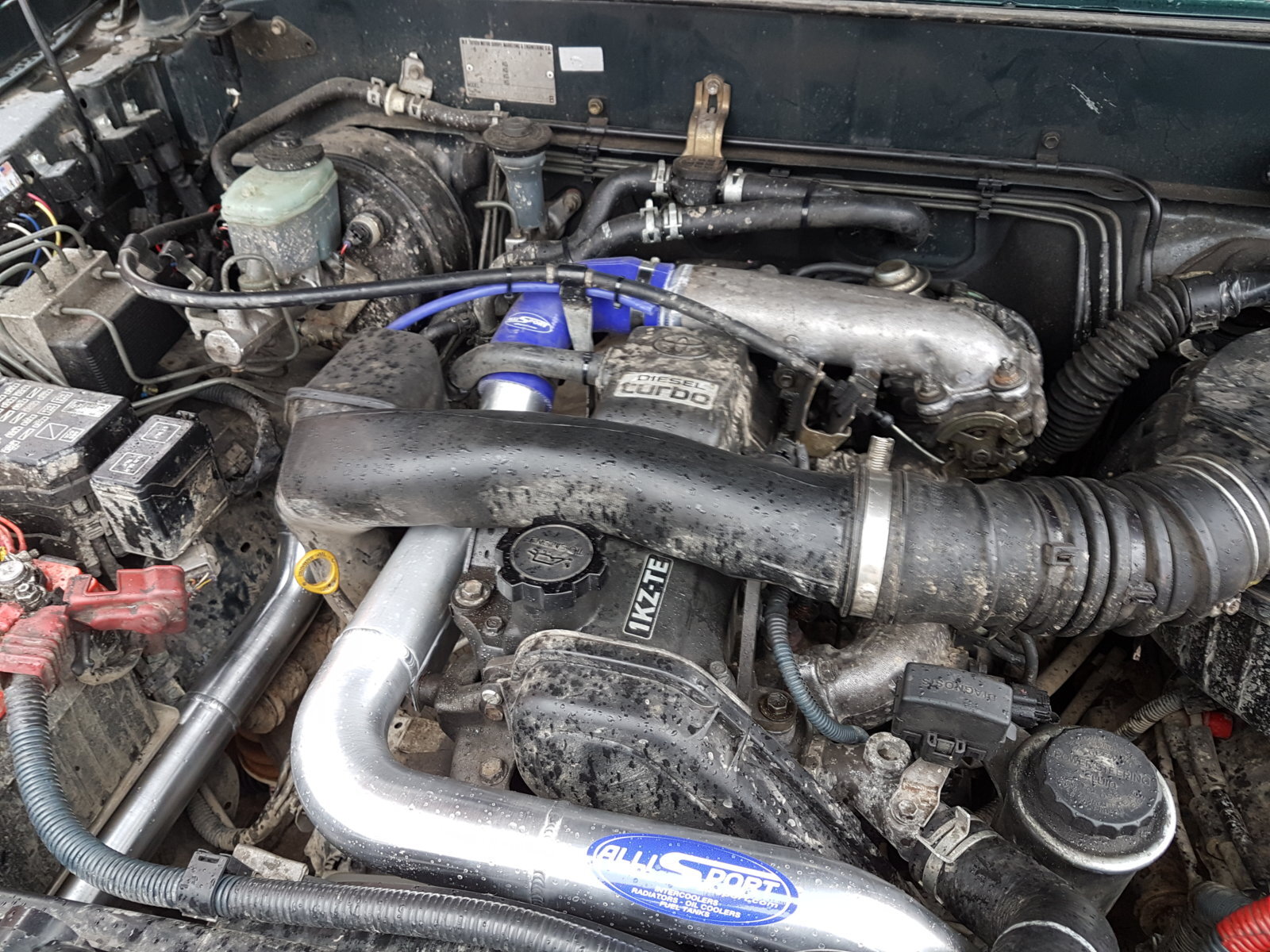

running a 3.0 colorado with intercooler, exhaust and tuneit box
Nice setup. Could You post some more pics of your intercooler setup, more so how you made the connection on the original intake manifold piece, it seems very neat.
Also how are you able of running such high boost on the standard pump, unless you have a mechanical one? (Cable says otherwise).
