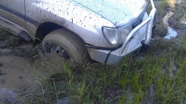

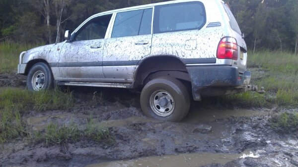

First 2 pics are from just after purchase when i first got my car bogged, car was resting on bullbar and there was about a foot or water still below the tyre.. 96467061-62b7-4dff-9a5b-f2cd57fc045e_zps669e0d81.jpg92c89e80-f593-4b29-85d5-de9c3252ff25_zps6dc18029.jpg

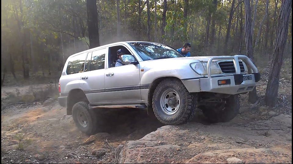

Picture of a tough hill near my home town, steep hill with 2x 2foot step ups about 1.5m apart2013-05-20_20-58-54_zpse3d9f13a.png

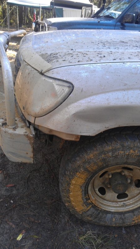

Done a trail in some nearby state forests and tried to get around a fallen tree stump, mud bank gave way and crunched in my guard and tore off the side bit of my bullbar, i cried when i saw the damage haha3ae8deb8-71ad-4bc9-bc1b-d19ceedc131a_zps2d856343.jpg

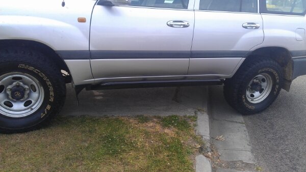

Rock sliders i got made up, picture was taken at a prop shaft shop as the day before i bent it on a steep hill with a rock step, so i currently run a heavy duty thick walled rear shaft with truck uni joints.144f6463-5d67-4c22-a645-aee5b321239d_zpsf7597f30.jpg

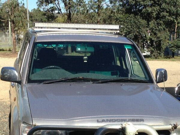

Last pic is my 52 inch LED Lightbar on a bracket i made at work in an afternoon5826709e-ecac-4b94-858b-93bfef2a7050_zps95788944.jpg
