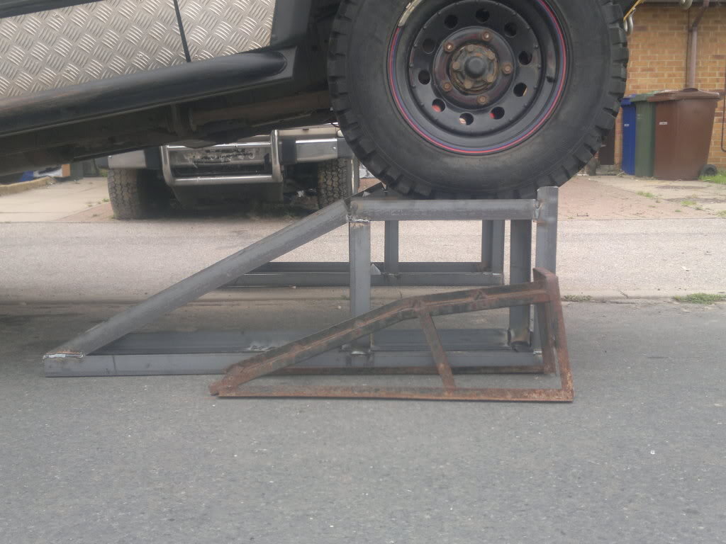

big ramps for big toys
these are the ones i had made for me, they are about 16/17" high
the ones in front are normal ramps you can buy in shops
I was wondering about vehicle display ramps but they're damn expensive so I think I'll make a set during summer. The Halfords / Machine Mart ones are too narrow for Cruiser tyres anyway

there is one small problem with my ramps they are blood heavy but can handle the weight with ease
That's the only 'problem' with mine. They were made years ago by a friend/neighbour of mine, now passed away. I used to help him out with his car now and again and after borrowing them one day he told me to keep them. He was a welder/fabricator and made them up from 30 x 30 x 3mm angle iron. They're only 10" high but they weigh around 30lb each.
