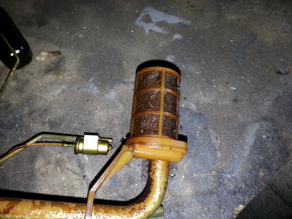

Following Karl's comment on the in-tank pickup filter I set aside an hour or so yesterday.
Very surprised at the amount of crud on the filter (not sure how this compares to others?) This vehicle is 21 years old.

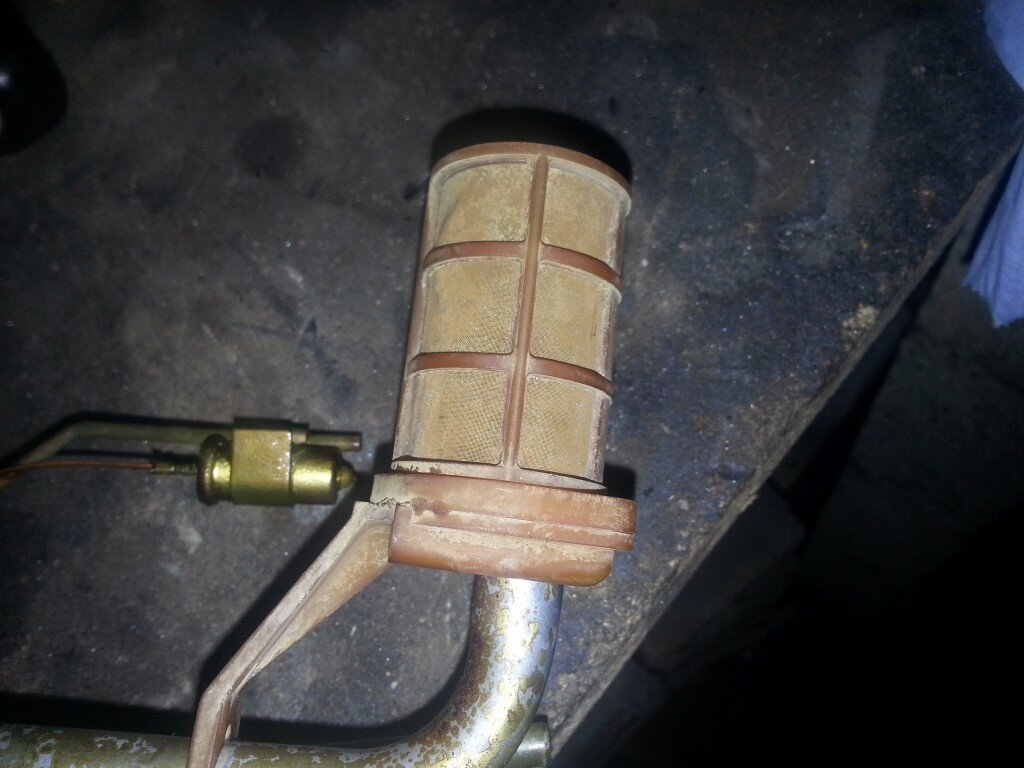

A clean up with some solvent and air line - it came up ok.
Checked my pick up filter which has never been cleaned in 18 years and 140,000 miles and it was perfectly clean.
Frank
Same here Frank, 19 years and 340k kms, filter looked like new and the sender had never been removed from the tank.
Strange how some are like new. EVERY one I have ever inspected have been gunked up.
I thought it was just the bacteria stuff in water,diesel etc caused the stuff that clogged the filters up.
I dont know much of the history of mine, I know it came from Devon way when new and stayed in the general South West then up to Birmingham. I had run about 8 tanks of bio through it before I thought better of it!
Foolishly I did mine with about 3/4 of a tank - I could see plenty of crud in the bottom of the tank, got a lot out with magnet and hands - considering a flush out now.
To be honest I think its worth a check, I like Karls theory of it placing extra strain on the HP Diesel pump.
In my first picture above it looks better than it was, it was as good as blocked, Im surprised fuel got through!
