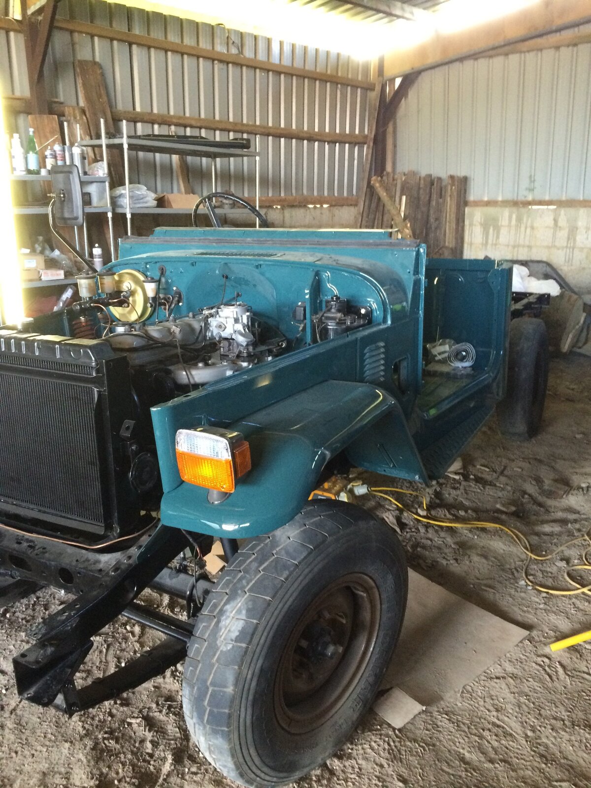

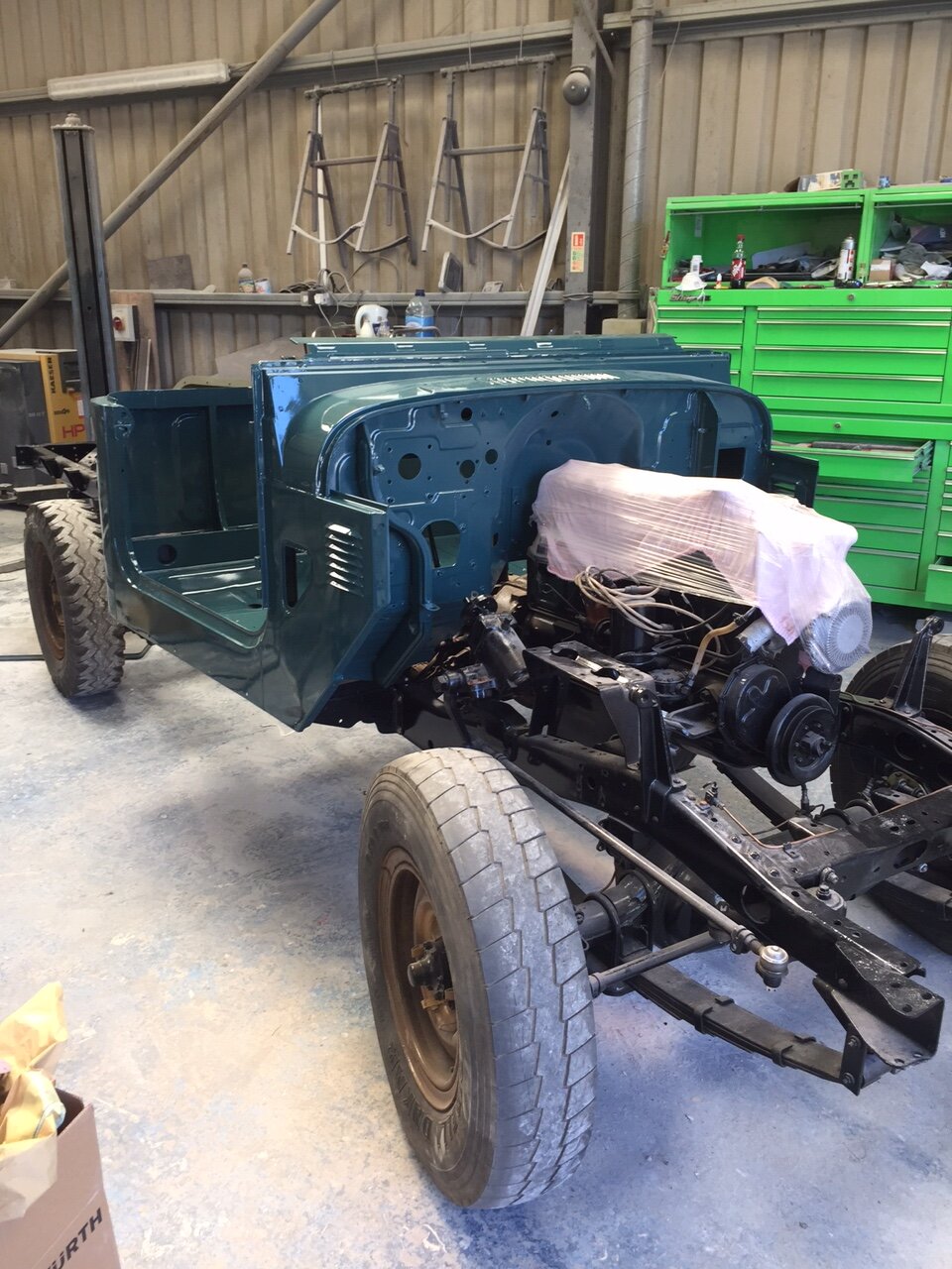

Some more progress yesterday.

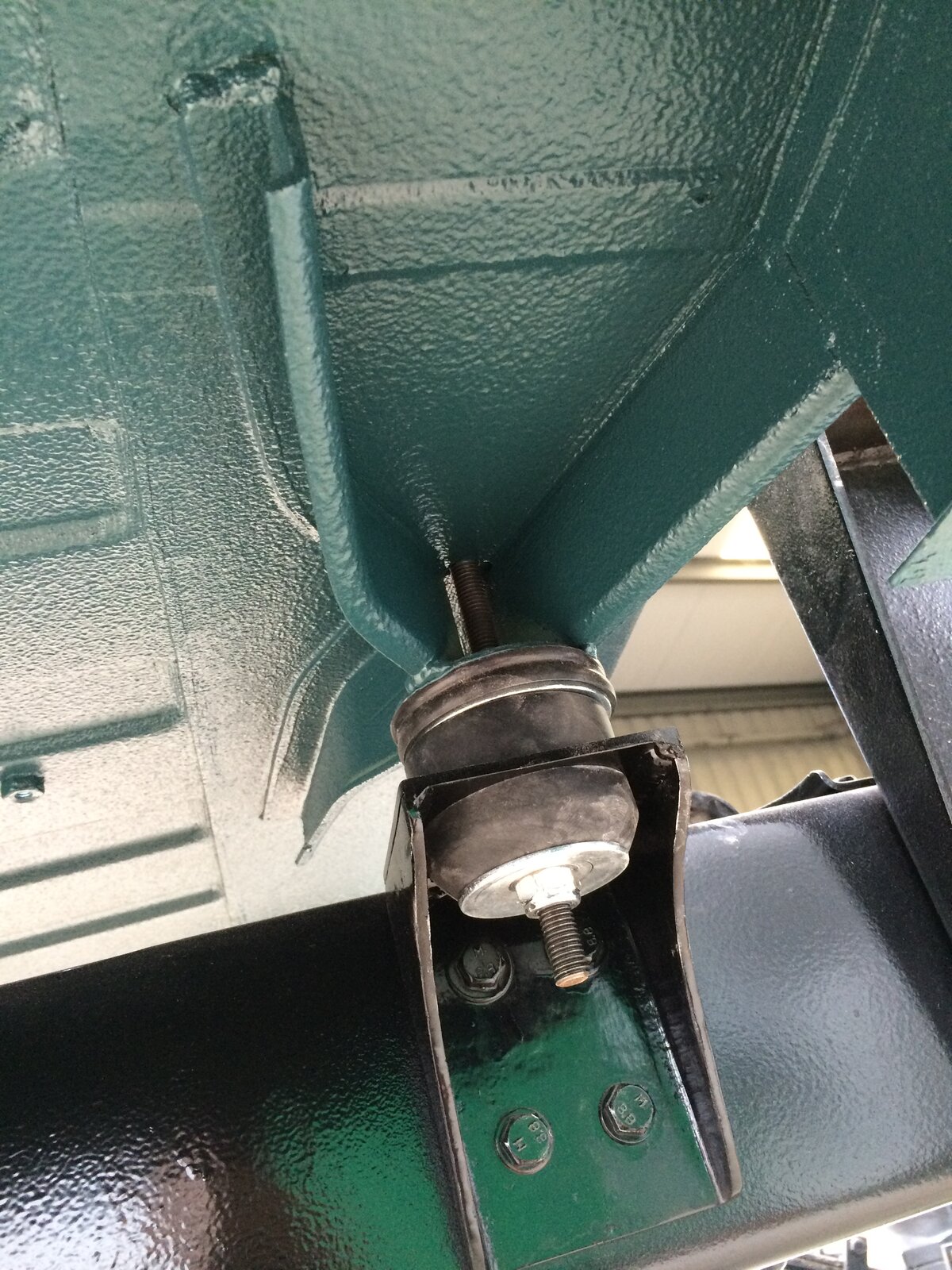

This is the correct rear body mount the white one previously posted was off an older model that I took a photo of so we could make the part

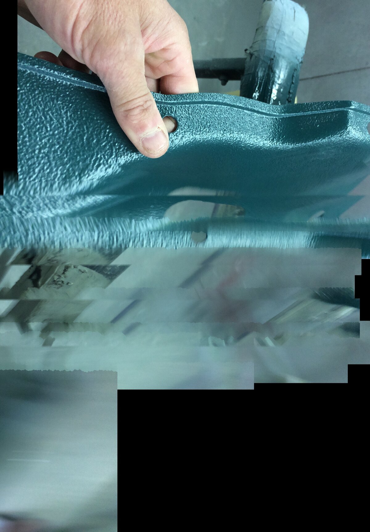

As you can see I have gone for a stone chip on the underside of the cab wings and side steps.

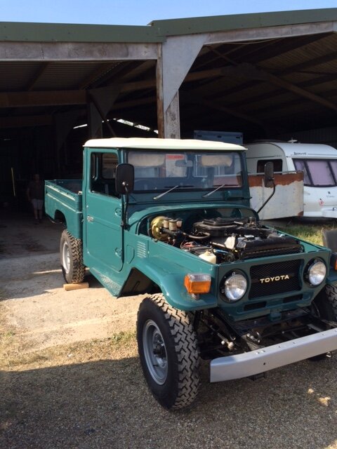

Great progress yesterday after a few frustrating days with fiddly stuff
Looking good, what have you done to the engine? or was it fine and just had a sprus up? I know you have some new 16inch wheels,,what tyres are you thinking about??

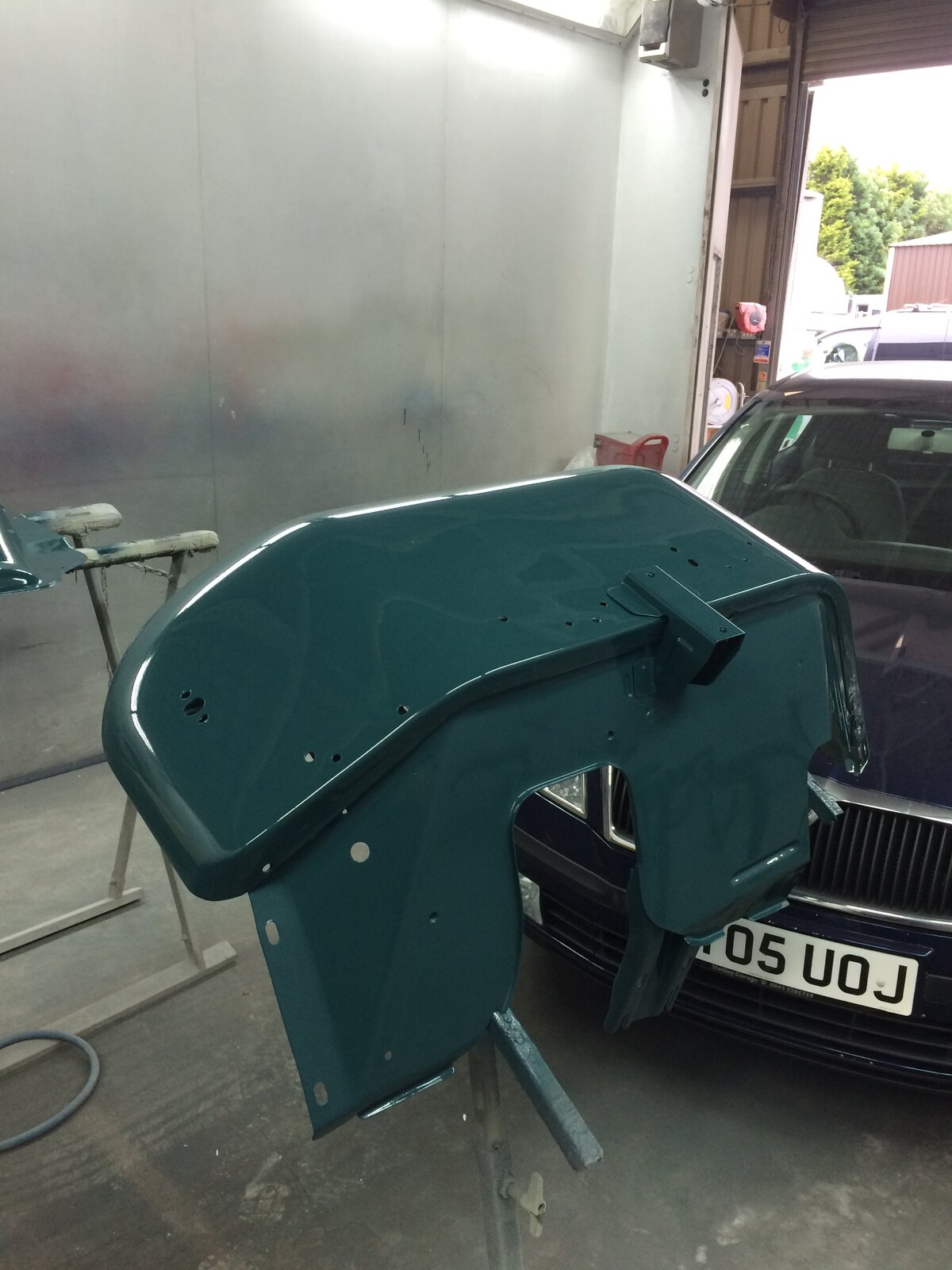

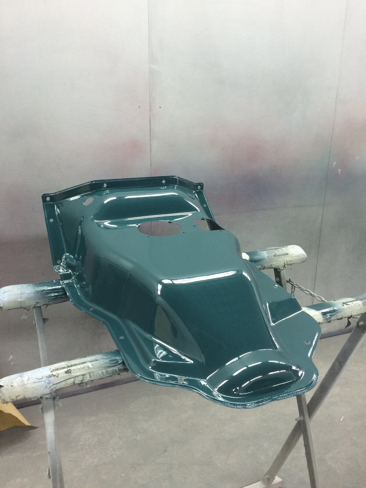

Just had a massive catch up and this is just....well.....amazing, the paintwork looks outstanding and what a nice original colour.
Love it, well done so far..:thumbup: brightened the day seeing those pic's.
C.
Just had a massive catch up and this is just....well.....amazing, the paintwork looks outstanding and what a nice original colour. Love it, well done so far..:thumbup: brightened the day seeing those pic's.C.
Just done the same catch-up, what a lovely job done on this. The color is the best I've seen for this truck. Gorgeous. :thumbup:

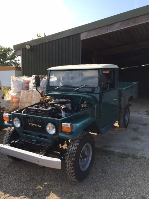

I have to be honest but it was my wife who convinced me to stick with the original colour (rustic green 621) as printed on the delivery docsIMG_1897.JPG

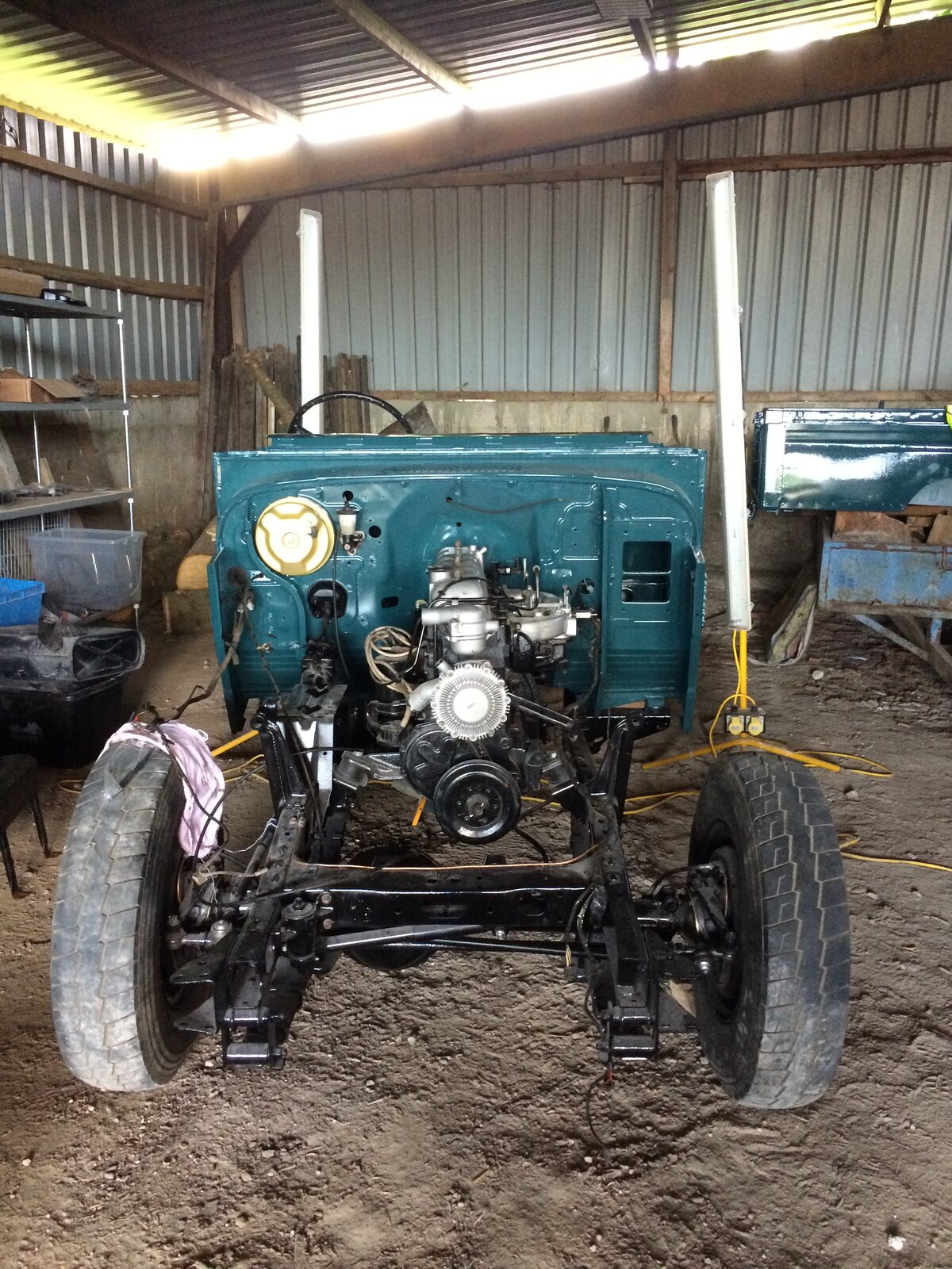

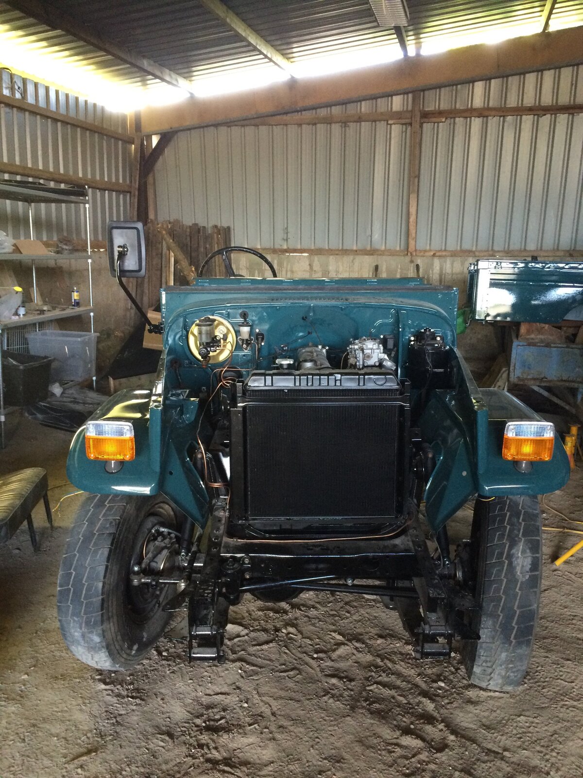

Getting there but have a problem with the viscous fan coupling and fan.
Anybody know where I can get one for this?IMG_3191.JPGIMG_3193.JPGIMG_3195.JPG

I tried Euro 4X4 and they dont stock anymore.
I could go to a direct drive or electric fan
Any thoughts anybody.

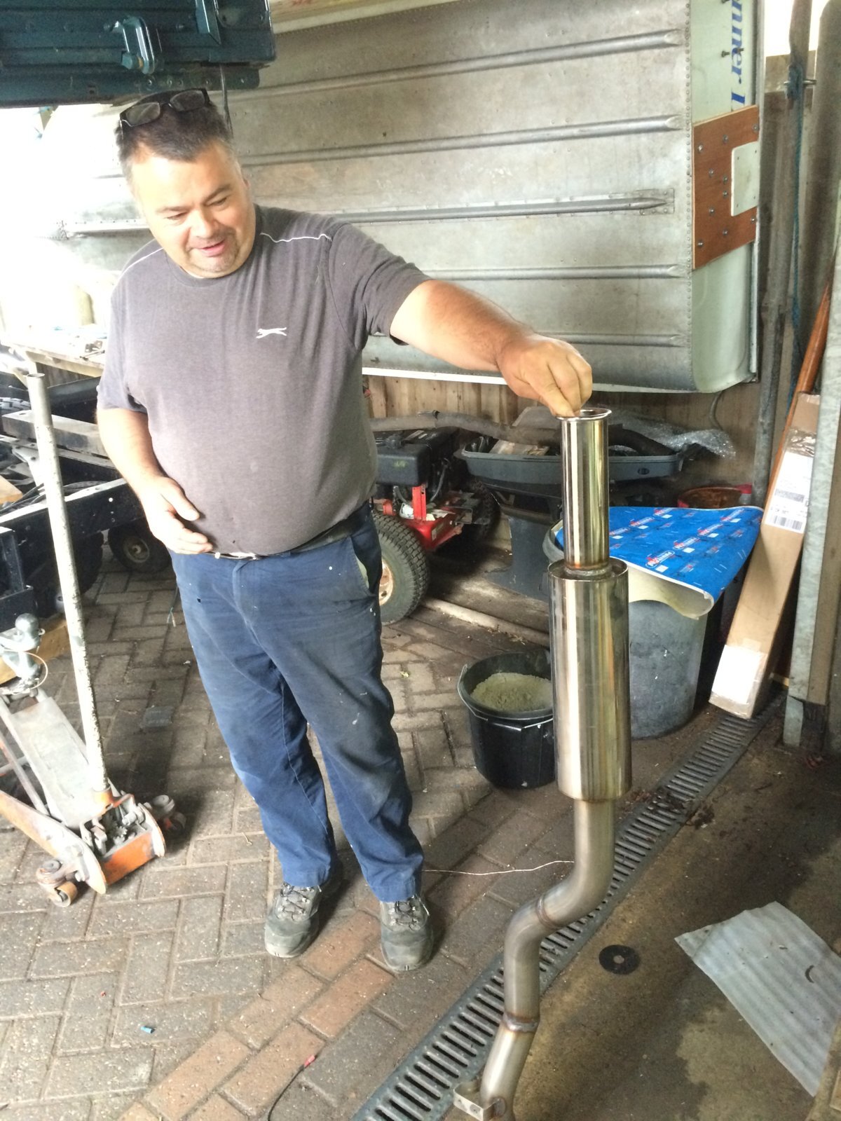

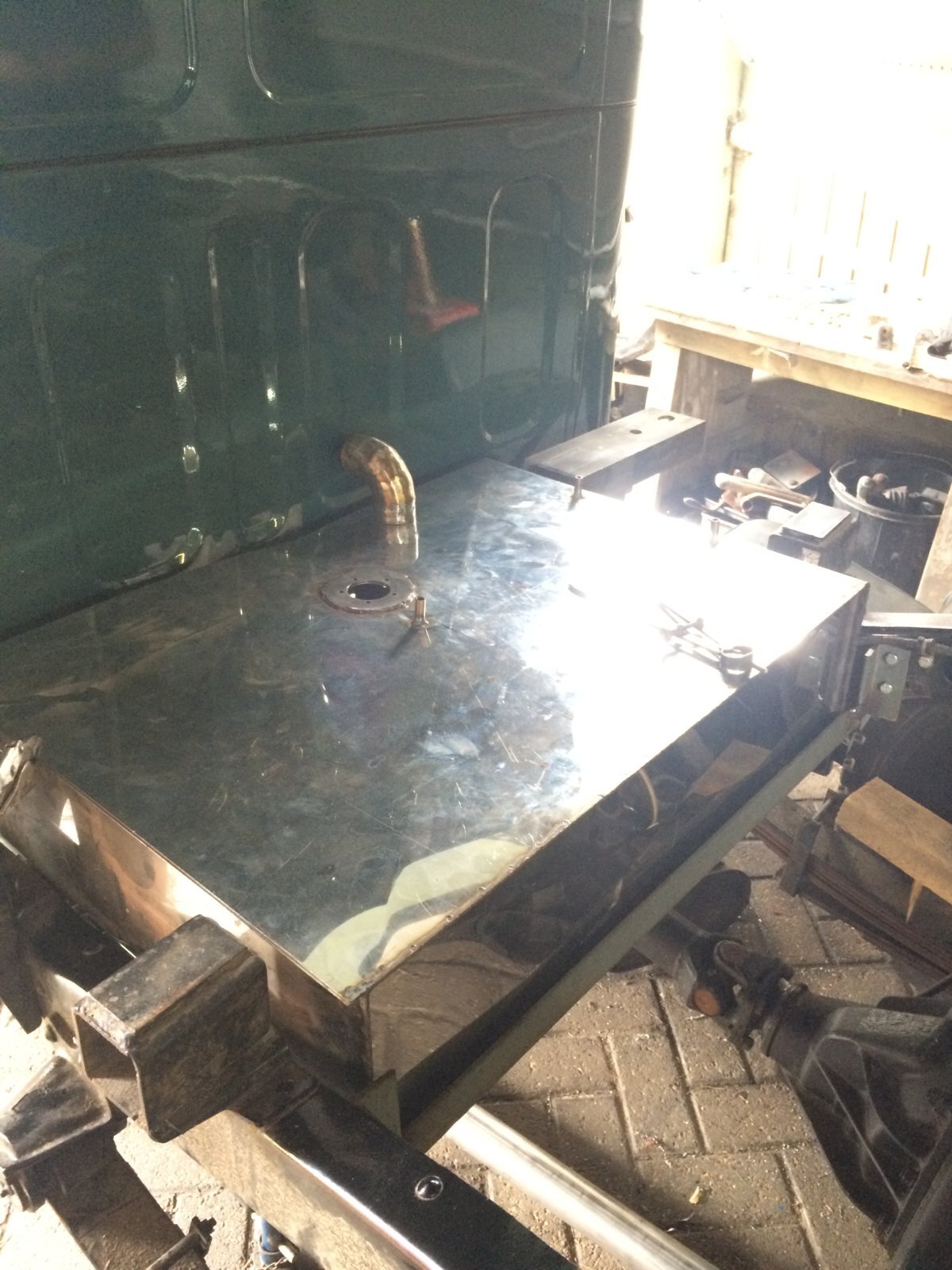

After many months of messing around with body on body off, fans, fuel tanks and exhausts I have decided to fit a SS fuel tank under the pick up bed and SS exhaust (see attached). I am aslo having trouble starting her after a few days with the carb looking empty of fuel. Does anybody have the same problem and do I need a non return valve in the fuel line?
