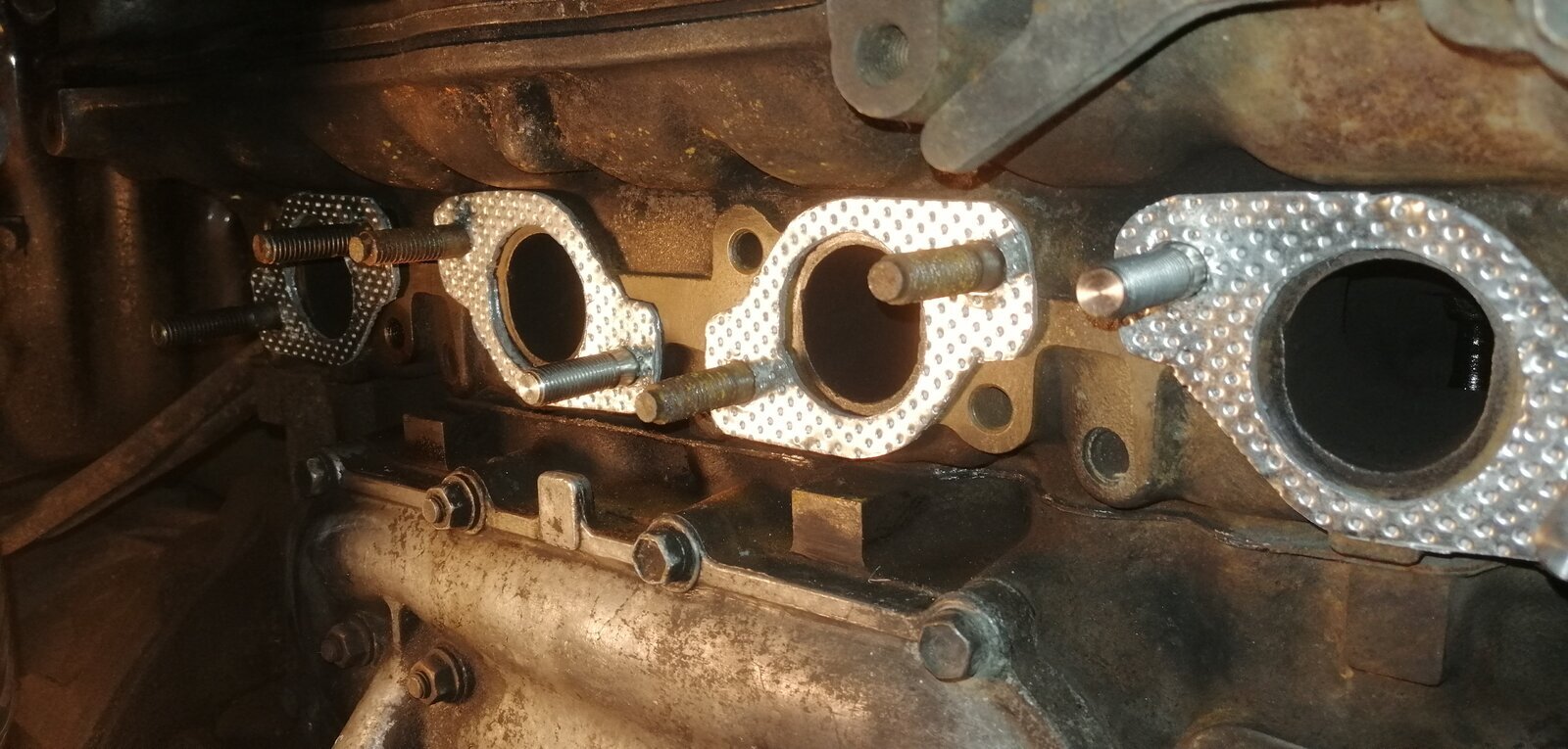

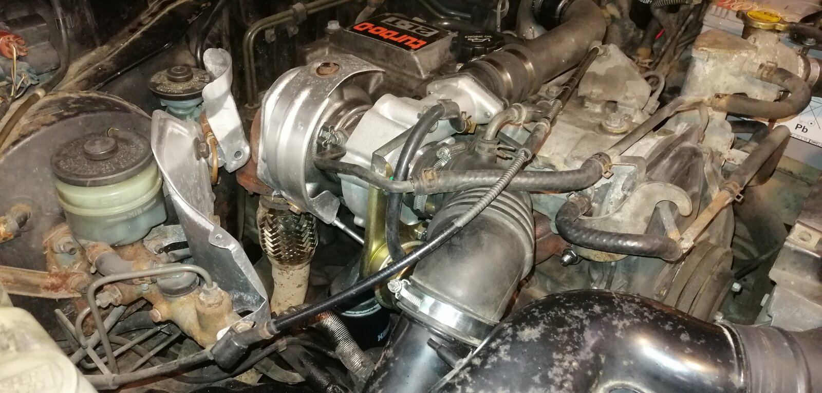

All back together now. I ended up removing the manifold as it was a right botch job, leaking terribly. The whole exercise consisted of a mix of bolts and studs, some of which were the wrong size. Seized and rounded off, sheared off - the whole collection. I had to make a new manifold gasket as the one I ordered failed to arrive and I got fed up waiting with the motor in bits. It toot a few hours to cut gasket material to size. The new Max turbo came on time and fingers crossed works. As I don't drive the vehicle much it won't get hard use. Now back to the list of other jobs.....

Bravo its a ball ache of a job but satisfying when it all comes together :clap:
