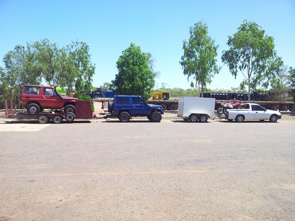

Haven't got many pics of the red one, the pic of them both is my setup when I recently moved my entire life to NT, and the other is the reason I need to do something about flares.

Dave
