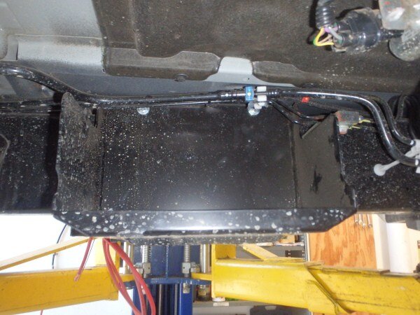

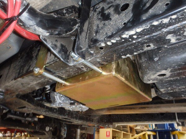

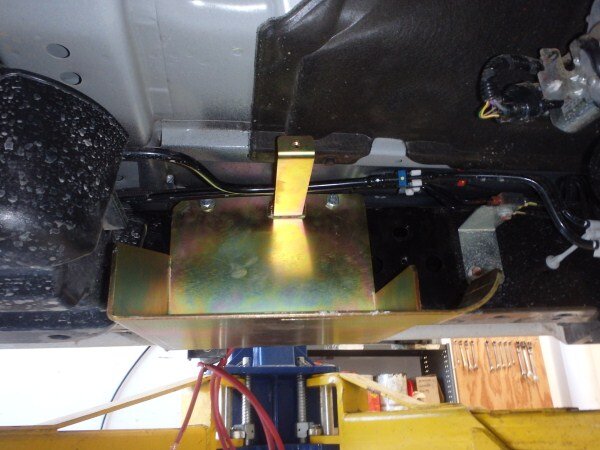

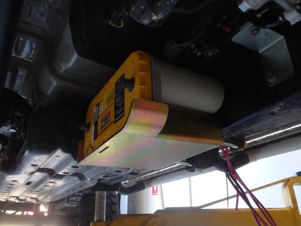

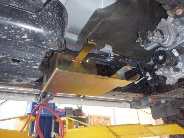

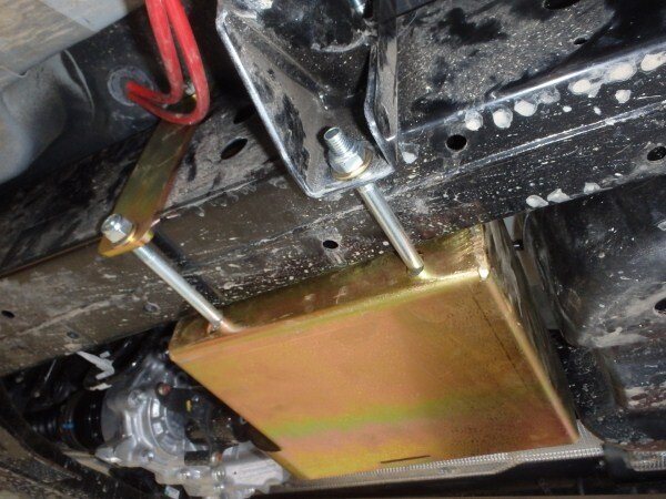

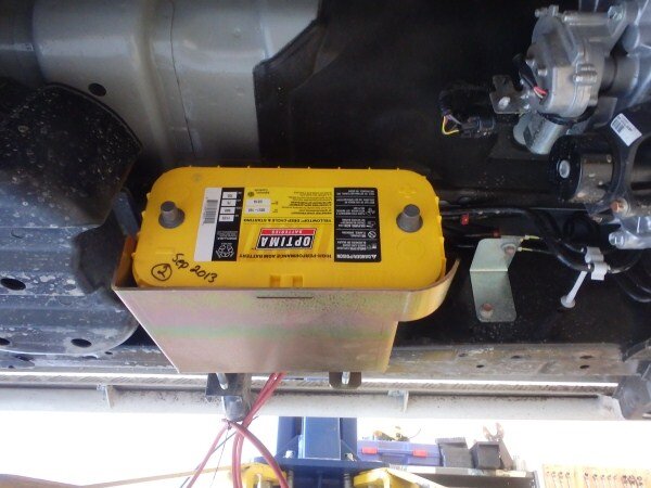

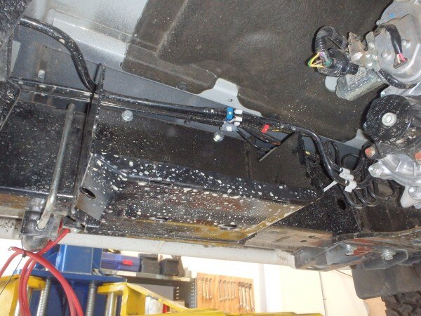

I was given this battery box and told the customer will be back in an hour, can you build a mount for it so he can bolt it down securely in the back of his ute.
I made a tray.
And bent and drilled a top mount.
The customer wanted to be able to padlock it so it would be harder for people to steal it with his expensive Optima battery inside. So I welded on some thick washers.

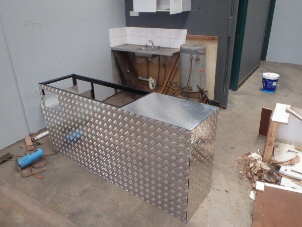

Another little project I had was to design and build a kitchen for a factory. The existing kitchen cupboard that was fitted was rotten and falling apart and rather than replace it with another chipboard unit it would be better to make a steel frame and cover it in alluminium with the sink at one end.
I took the frame for powder coating on Thursday and on Monday I should be picking it up and going and fitting it in the factory.

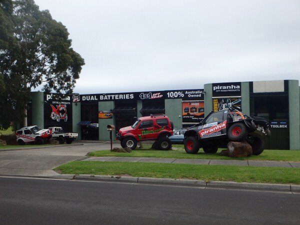

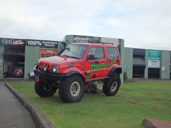

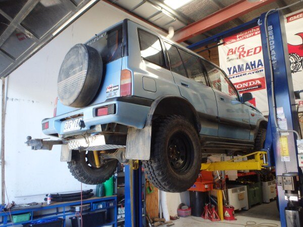

We had all the toys out on display this week. :icon-cool:
Its the first time Frankenzuke has been out on display since being built.

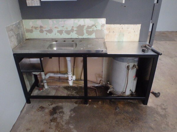

The kitchen I built last week got fitted.

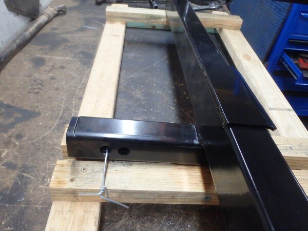

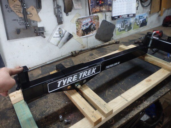

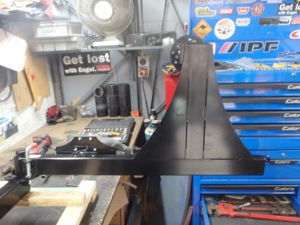

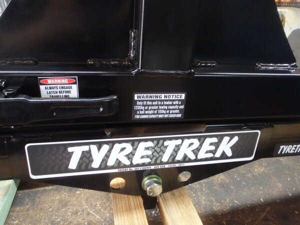

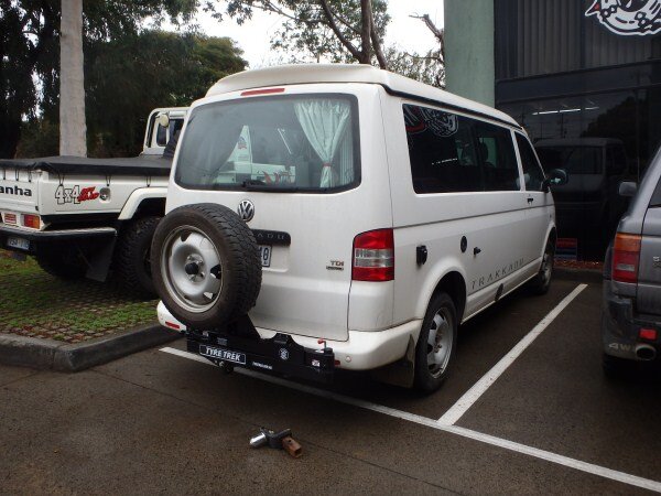

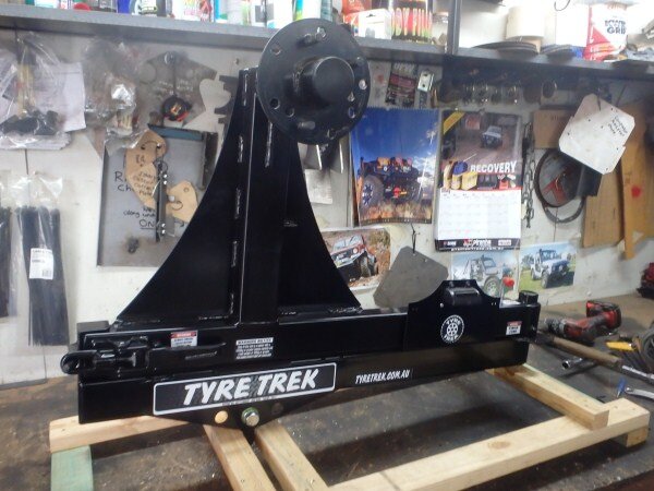

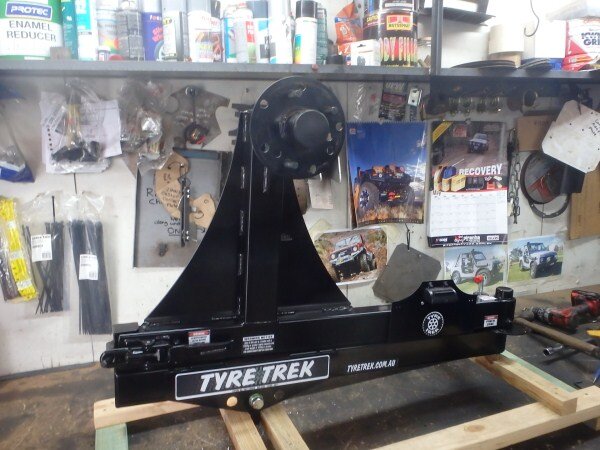

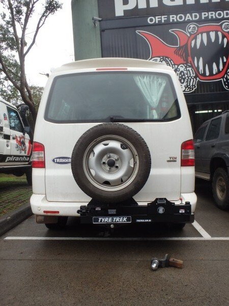

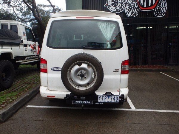

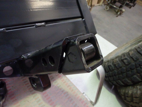

This is a swing away wheel carrier that mounts into a tow bar receiver hitch that I had to modify and fit.

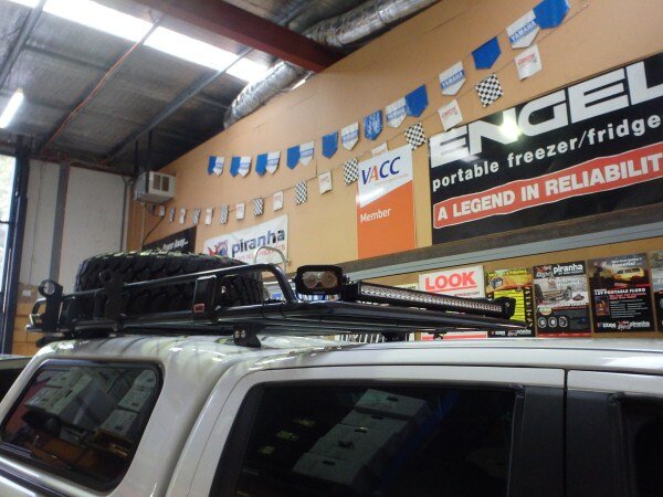

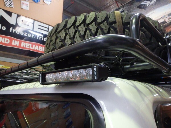

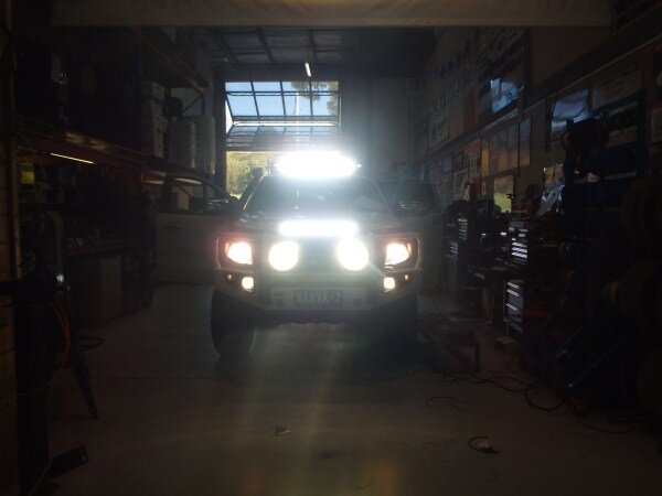

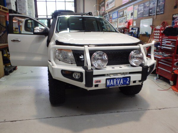

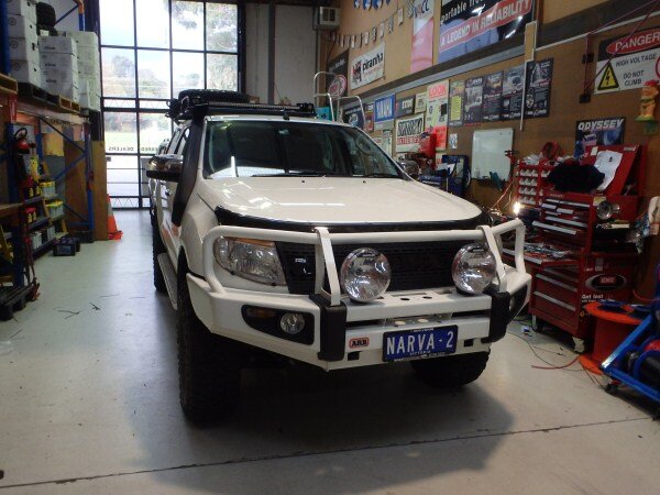

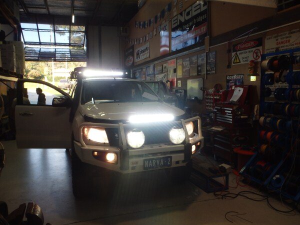

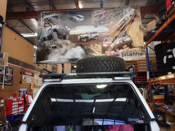

This is Narva's latest display/advertising vehicle.

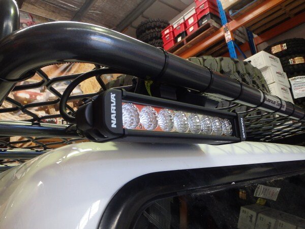

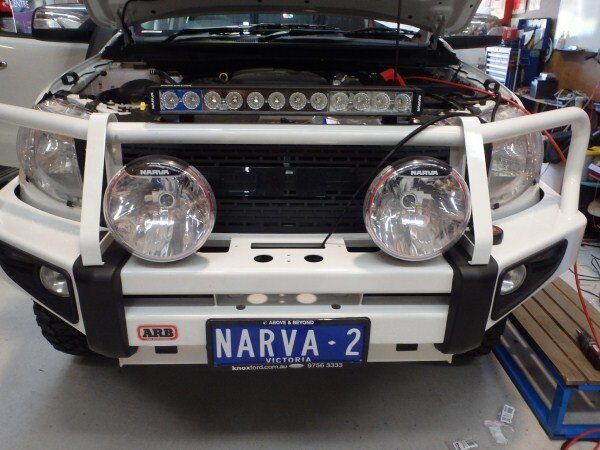

We had to fit all their lights to it and do all the auto electrics. If you read any of the Australian 4wd magazines or watch any of the TV programs/DVD's then you will be seeing a lot more of this truck over the next few years. :icon-cool:

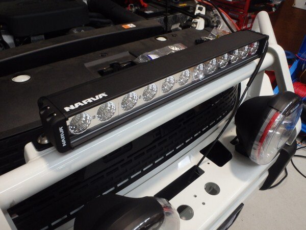

We fitted lots of lights!

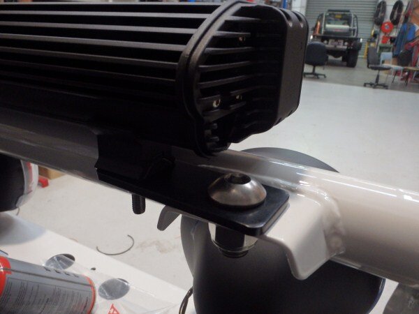

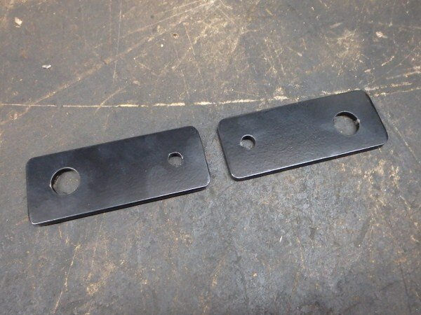

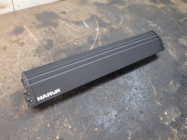

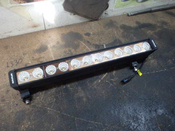

I had to make some brackets to fit this light bar onto the bullbar.
I got them powder coated.
And bolted it all together using stainless steel bolts.

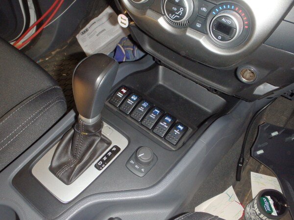

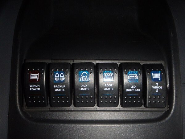

I also cut out a section of the center console for some switches.
Turning night into day!

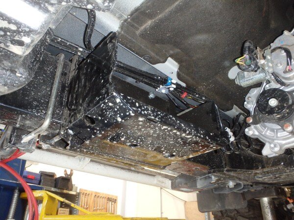

This is ARB's version of an underbody battery tray. Its made from thin, powder coated steel and only takes a 10" Optima.
We removed it and fitted one of ours as the customer had a 13" Optima they wanted to use.
I designed it to work with ARB side steps.
For the first time ever in Australia the mighty Hi-lux is no longer the biggest selling 4wd pick up! It has been beaten by the much cheaper Ford Ranger/Mazda BT50. But these vehicles have a few design faults that mean their really not suitable for off road use!

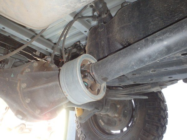

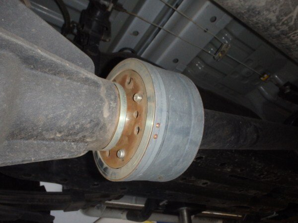

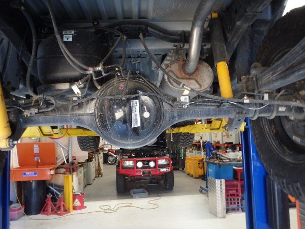

This balancer on the bottom of the rear prop shaft can easily get ripped off and damaged. This often means it flies around on the prop shaft for a while and hits the plastic fuel tank next to it. They have also been known to become jammed and the prop shaft gets twisted and snaps!

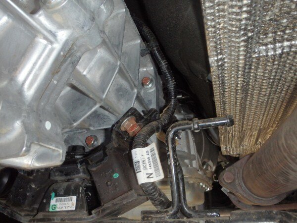

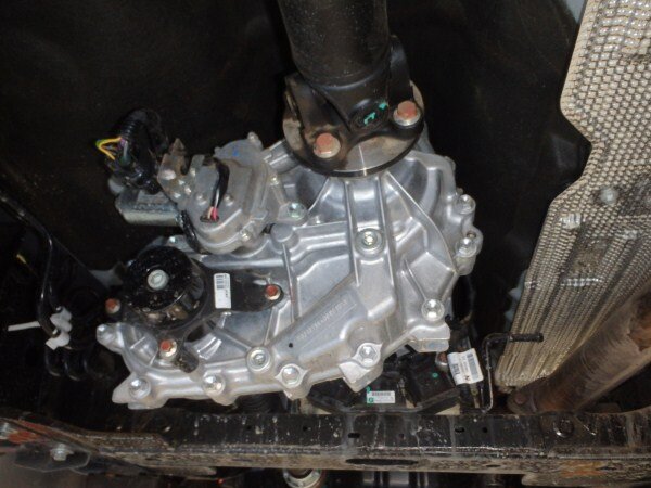

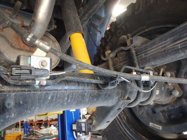

Another issue is all the wires and connectors around the gearbox and T box. If these get damaged by a stick etc. People find themselves stuck in low range.
Another issue is all the wires and connections on the rear axle, again easily damaged off road by stray sticks etc.
Its a real shame Ford have produced this vehicle! After all they know how to build good trucks, you only have to look at their hugely popular F truck's to see that! :crazy:

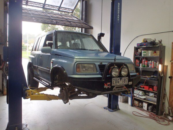

I had to do some work on a customers Vitara.
Got to test fit some alluminium fuel tank guards I've been making.

I finished Tafe early yesterday so went to work and did some work on LJs' rear bumper.
I wanted to try and reduce the weight a bit as being 5mm box its bloody heavy.
Decided to cut some out of the sides.
Marked an inch in.
Lots of Lincomb sand.
Other side.
I couldnt do this on the other side as the exhaust is there.
More sand.
I needed to fix the bent pin next.
I got it nice and hot.
And used a piece of wood and a hammer to hammer it straight.
I wanted to harden it by heating it up then quenching it in oil.
Used oil is better as it has more carbon in it.
Now in hindsight I should have done this outside as the second the red hot metal tocuched the oil the oil caught fire! :doh:
So I resorted to pouring the oil over the spindle and using the compressed air gun to keep blowing the flames out.
Another reason why next time I will do it outside is the huge plumes of agrid smoke that filled the workshop.
While the smoke cleared in the workshop I went outside and had a look at my bosses Kaymar bumper to see how they had done their swing out stop and gas strut.
Back on my rear bar.
I still had lots of sand falling out!
I wanted to cut my old stop off as it had been denting the box section on the swing out arm.
Bottom bearing on first.
Followed by the arm.
Top bearing, washer and nut.
I cut a piece of 10mm thick steel.
Cleaned some paint off.
And tacked it on.
Next I wanted to mount a gas strut.
One of these.
Decided to mount it under the arm like the Kaymar one to keep it out of the way.
Drilled a hole and found an M8 tap.
Worked out where on the arm the other mount needed to be.
Drilled and tapped.
I wanted to finish the stop next so that it opens to 90 degrees.
Cut a piece of 8mm.
And tacked it on.
I wanted to look at the catch next.
I needed to cut the old mount off as it would need to sit lower down.
I thought I may be able to just move the other part down one hole.
But then I wasnt sure if this would be in the way of the little rear door opening.
So thought I could mount it the other way.
So I decided really I need to bring it home and try it back on LJ to see how best to do it.
