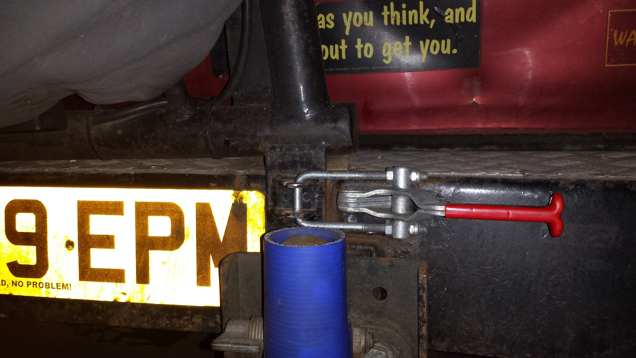

I needed to fit the rear bumper and work out how best to mount the latch.
The arm is now at a much better angle.
The swing away wheel carrier swings enough for the door to open fully.
So I needed to look at how best to mount the latch.
This was how it was mounted before, but this will obviously restrict the door from opening.
And this is how I'm thinking of mounting the latch now.

Hey Ben, on the latch, I started out mounting mine horizontally on Muxley & it didn't hold the arm securely at all, maybe I had something wrong but I would try to keep it vertical if I were you :icon-ugeek:
Shame about Michael's 80 :doh:
Thanks Gav. :icon-biggrin:
What latch did you use?
I think my one has got 800kg of clamping force IIRC. :think:
I'm not sure there is enough room to keep it vertical and still be able to open the little rear door. :doh:
Same/similar to that Ben - it needs to pull the swingarm onto something to work properly... Hence 'clamping' force I guess...
Can you shorten the arm further so that the latch sticks up in front of the bigger door perhaps :think: I think that's what I would try... :icon-cool:

When my release catch (a drop down through the bumper pin) broke I asked Julian V to come up with a replacement, this is it;
although it doesn't pull downwards it does keep the arm solid with no movement or rattles. When it was held by the drop down pin it rattled a lot.
