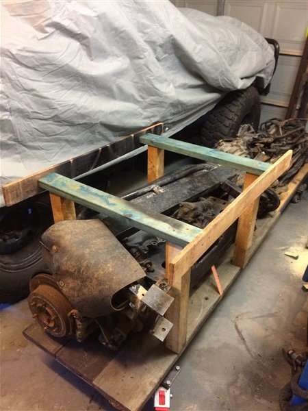

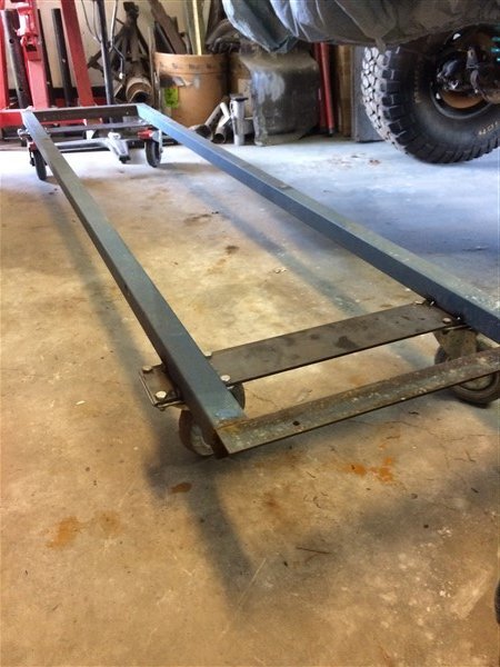

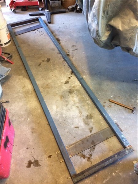

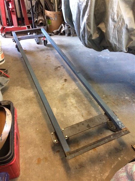

I made a start on the packing and decided to adapt the base of the rotisserie I built to turn it into a big trolley. The idea being I can load all the big heavy car parts onto it and then just push straight into and out of the shipping container for the big move down to VIC. :D

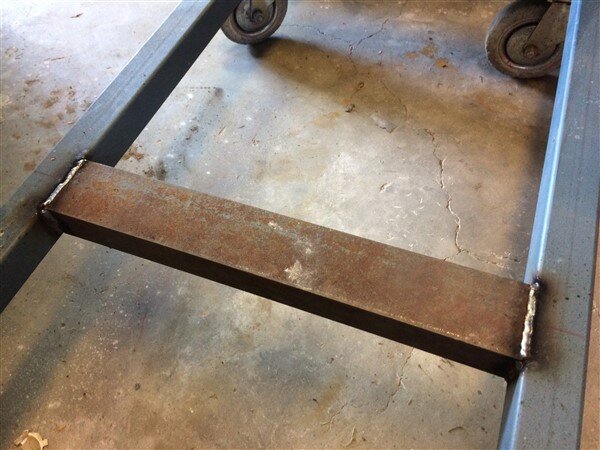

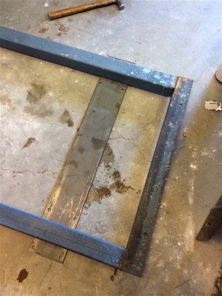

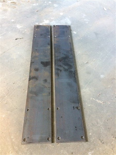

I cut some 90mm x 6mm flat steel bar and drilled some holes in it for the castors.

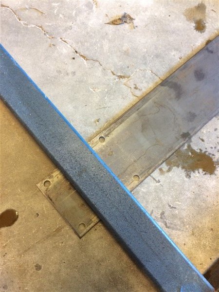

And positioned them under the frame and welded them on.
And bolted the wheels on.

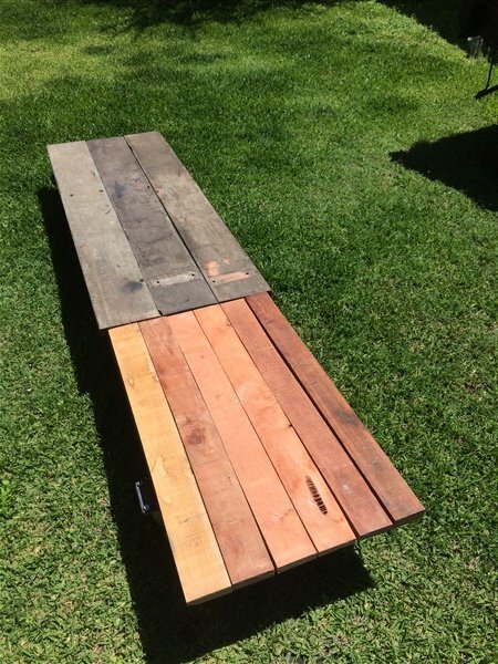

I welded in a piece of angle to support the ends of some hard wood boards I had found to fit to it, as they sadly wernt long enough to do it one length.
Cut and screwed all the hardwood planks on.

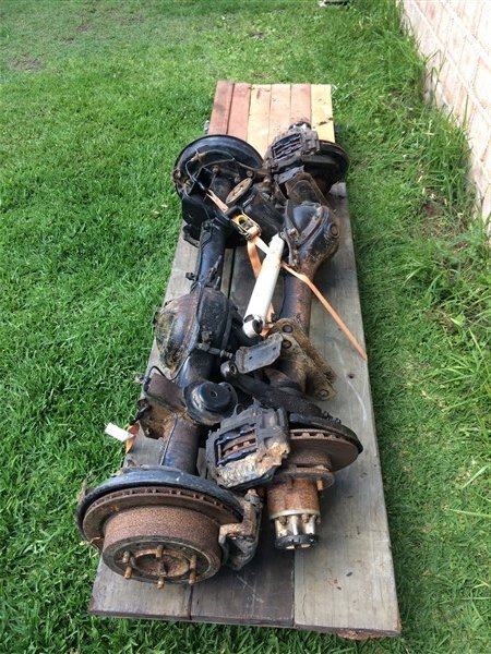

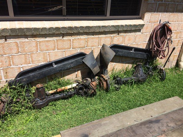

Next job was to load the heavy KZJ78 axles and rock sliders onto it.
Their bloody heavy but the rear one in particular will prove vital for the rear of the 78 as I want to replace the factory diff lock and broken ring gear in it, with the KZJ78 one with an Eaton E locker and new 4.8 ring and pinion.

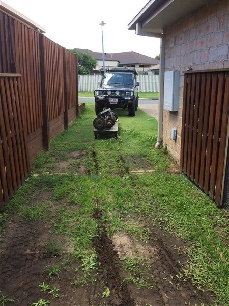

The trolley was too heavy to push so I had to drag it out of the garden with the 78.

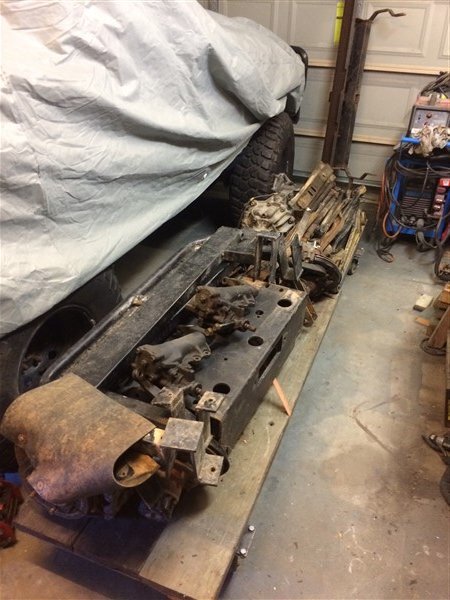

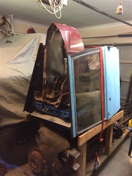

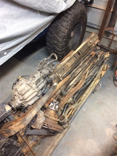

With it safely in the garage I could then load the rest of the heavy spare 70 series parts that I'm taking with me.

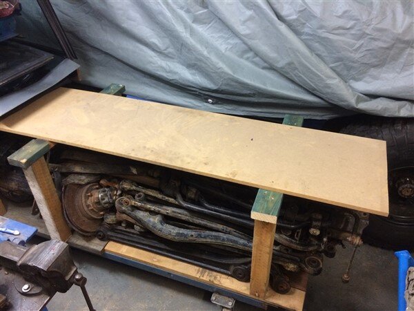

To maximise space in the shipping container I then built another tier on the trolley so I could load more parts above.

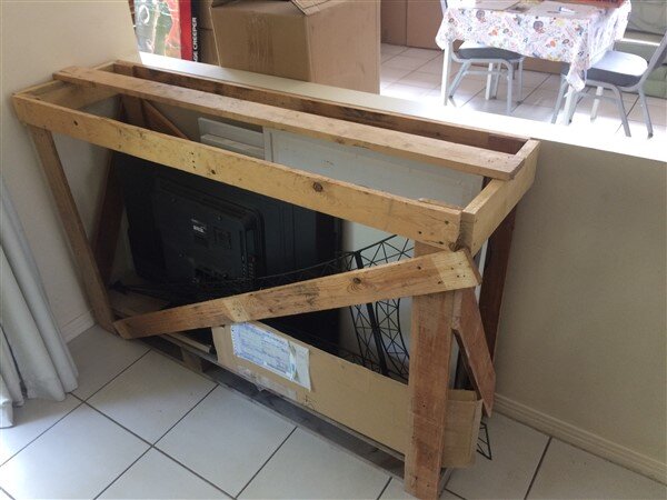

I was busy building a crate to put all the picture frames and TV in to protect them during transit in the shipping container.

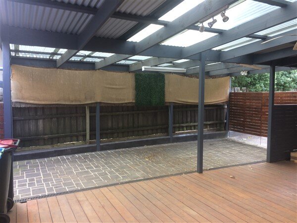

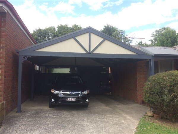

So at the front is a 2 car car port.

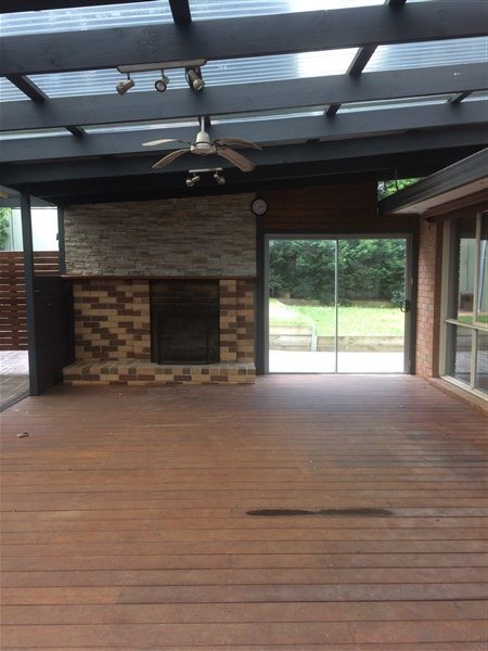

And behind that is another 2 car carport, half of which has been converted to a timber deck area complete with a chimney stack and open fire. :icon-cool:
There is another set of double gates leading from this second car port to the back garden and shed/garage.

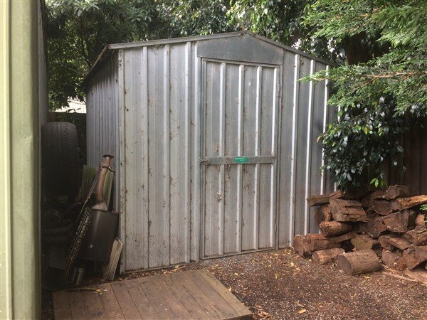

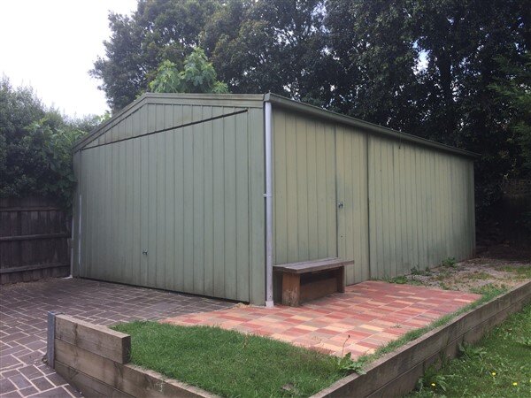

Behind the main big shed is a smaller 8ft x 8ft shed that will be invaluable for storing all my car parts and garden tools, which will mean this new workshop will have a lot more space for tools and working.

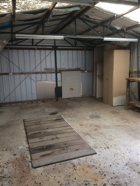

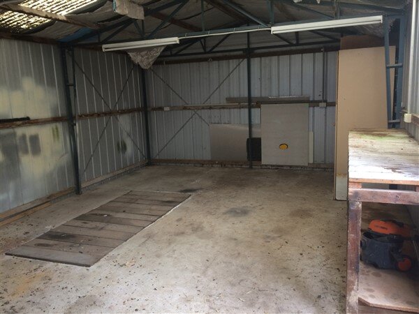

Inside the big shed/workshop/garage.
The old cupboards and bench will have to go, the whole place will need a good clean out and I will need to put lots more lights up, but its a great space! :icon-biggrin:

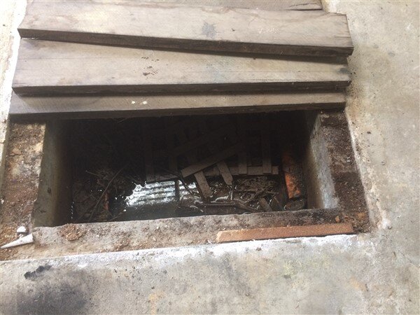

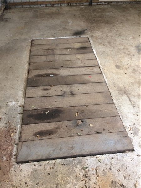

I was most excited to discover a pit! :icon-twisted:
Its currently got a few thousand litres of water in it and a load of crap floating on top. :doh:
So I will need to pump all the water out and give it a good clean out.
As the house is on a hill it must be well above the water table, so my plan is to put a load of holes through the concrete in the bottom to allow any future water to escape. :think:

Merry Christmas and Happy New Year to all of you. I can't believe 5 weeks have gone by already but typically you've got a lot done in that time. Good luck with the move and well done for finding that excellent property. You're going to need some insulation in that tin box garage, do you plan to line it out with insulation and ply or something? The car ports will be super useful. You'll have a working space a bit like Oding's.
The pit could be very handy but it concerns me that it's full of water. Personally I would pump it out rather than drill holes, it's clearly well sealed and as you say it should be above the water table but it could fill during heavy rain if there's rock underneath. Depends on the weather of course. I wonder how the water got in there if not from below? Doesn't look like the garage leaks but it's one possibility. Let's hope it's somebody with a hose and there's nothing untoward.

As for the pit Ben, most pit water comes in from below.
That you’re on a hill means nothing when talking ground water.
I suggest getting yourself a cheap submersible pump and plumb in a permanent water outlet, and leave it down there, just switching it on when needed.
Some duck boards or a false floor will keep your feet dry.
As Richard said, the last thing to do is to make holes in the bottom, it will just fill quicker then!
Ummm, im seeing one problem here Ben, how in the hell are you gonna get that heavy ass cradle full of car parts into a container? :lol:

As for the new house; looks the business lad. That shed is going to be some workshop when it' finished. First thing I saw was the pit and said lucky f&*$we lol. Like has been said already, is drain it with a pump. Don't put holes in it. When it's dry I'd seal it with sealer paint encase the water is seeping through the concrete itself. Raising the floor with wooden battons is a good idea.

Some great ideas and thoughts regarding the pump and duck boards for the pit. :clap:
I will buy a submersible pump and get it nice and dry and I will step away from the hammer drill! :lol:
I'm not sure if the roof has been leaking, I guess time will tell. But I wouldnt have thought so as the shed looks to be in very good condition and not that old. :think:
I dont know, I'm trying not to think about it. :shifty:
I wanted both containers on the driveway which would have made things a lot easier to load, but the tilt tray driver who delivered the first container reckoned he couldnt do it. :doh:
So their both going on the front lawn, one at a 45 degree angle to the drive and one at 90 degrees to the drive. :thumbdown:

I feel sure you'll build a ramp or something to get the trolley in, no worries for a man of your calibre Ben. I guess it won't wobble around once you've packed everything else in around it. Pillows and duvets in bin bags make great buffers for stopping things moving about.
