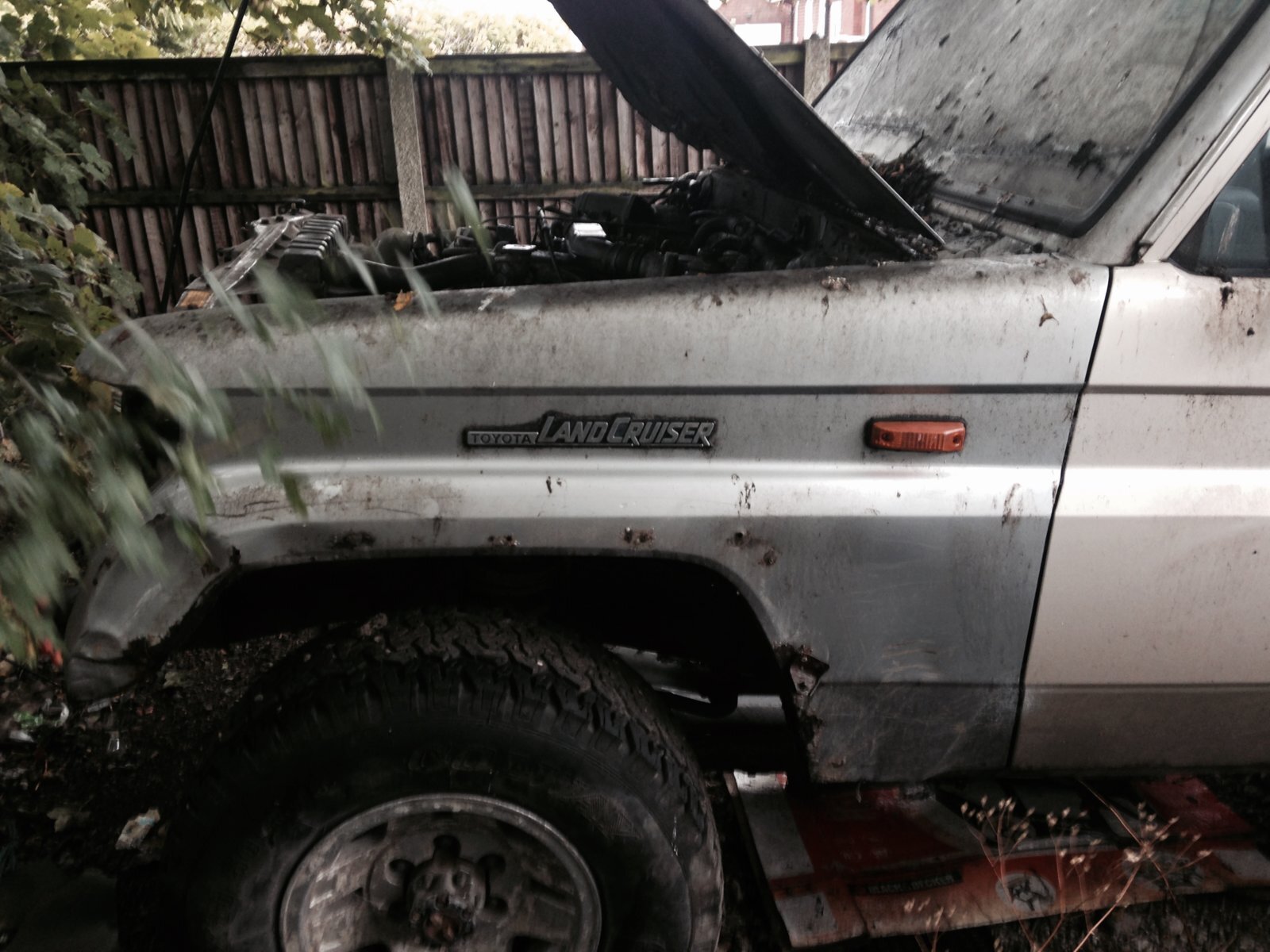

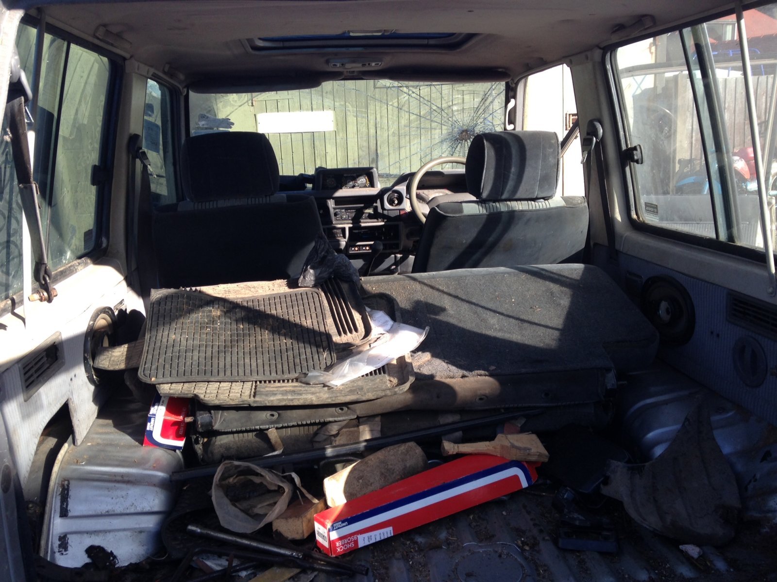

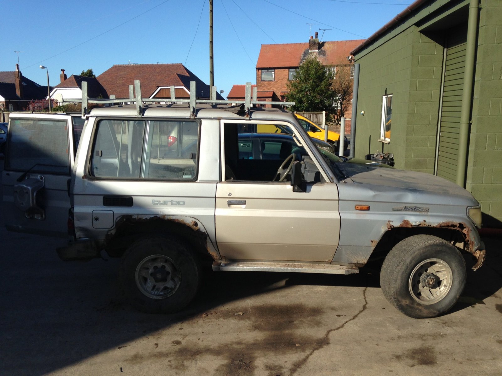

    I think it’s only fair that I should start a thread about my LJ70 project that I started a while ago...
    I will start with a few pics.
    869B9AE8-7964-4840-86B1-8A61D39D516F.jpeg 863819DF-2230-4393-BF9F-C7467A56CAC8.jpeg

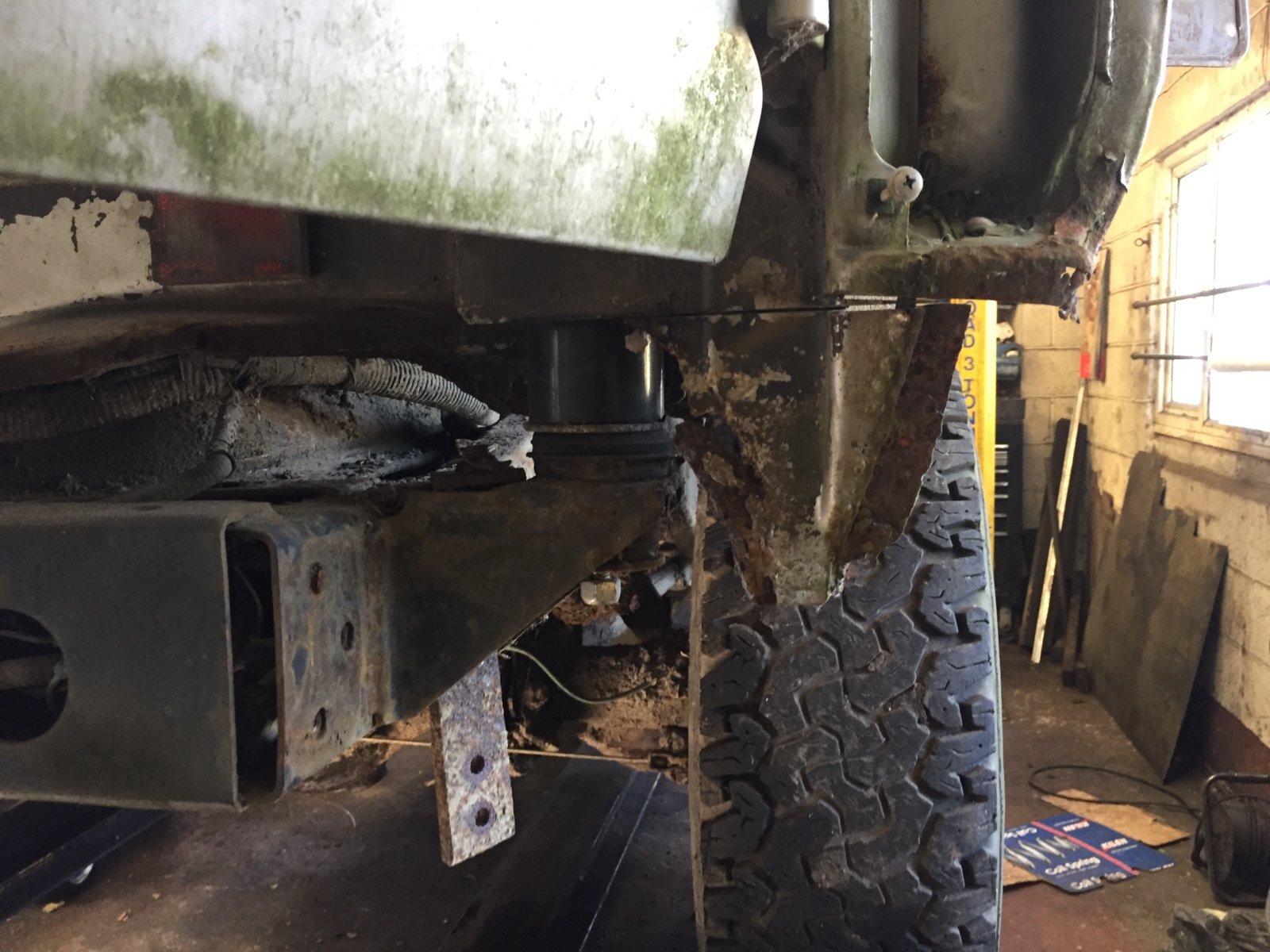

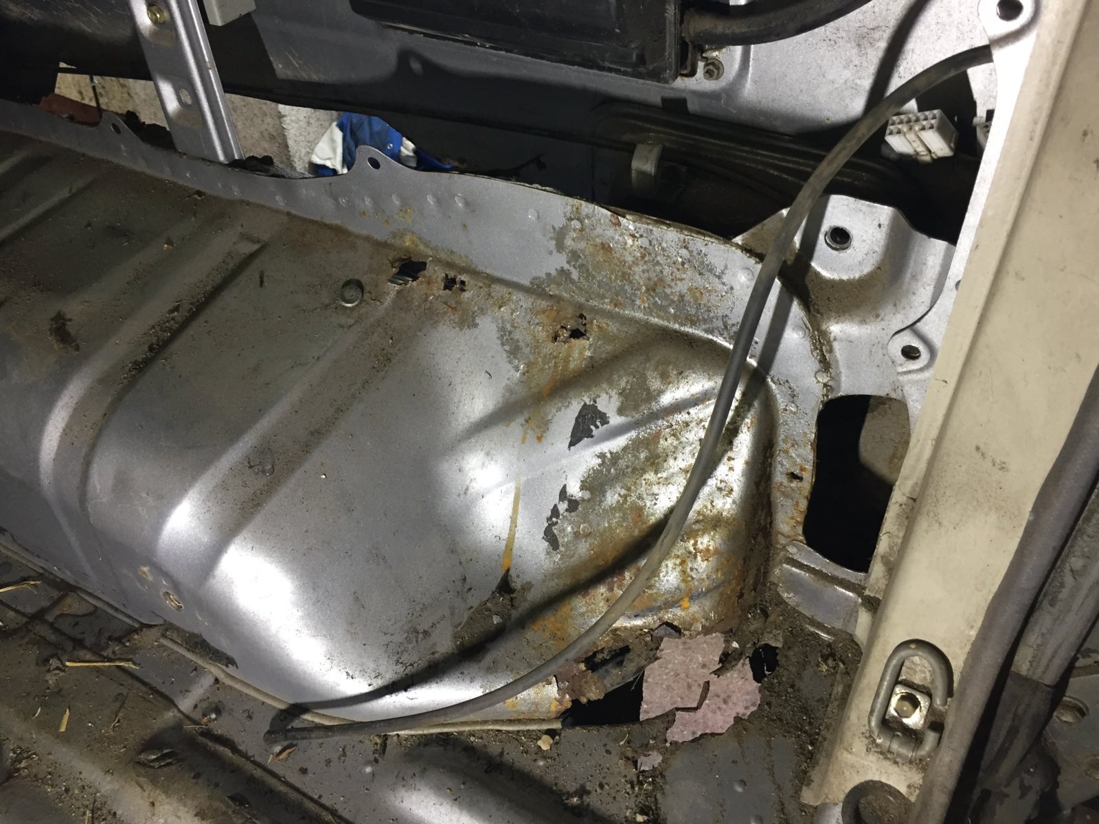

    That's a shame to see a 70 in this condition Shaun.. but really good to see that you are making good for it.
    When they're in this condition, would you consider lifting the body off the chassis cause it will make the exercise considerably easier? Not too much effort over great gain! Look forward in seeing your progress!!:thumbup:

    Mirroring iwan’s comments, its really sad to see trucks left to rot.
    Still, this is one of the lucky ones, caught just in time by the looks of it.
    A lot of work ahead, but when you see what can be done, such as @Ben has proven, you can make a “new” truck of this...

    Nice to see you saving one Shaun. :thumbup:
    As Iwan suggested, taking the body off will make things a lot easier. The soft top body I picked up for my LJ70 turned out to be quite rotten sadly, but after lots of work its almost fully repaired now and ready for paint. :icon-biggrin:
    Building a simple rotisserie has proven to be a god send, it has made the job so much easier being able to rotate the body 360 degrees and not having to work overhead and in particular weld, overhead. :icon-cool:

    I was thinking of taking the body off Ben, but ive given it a body lift instead which has helped with the body repairs in some places. so I just lift the corner I'm working on if needed.
    The welding is mostly round the edges so most of doesn't mean I get showered in red hot rust that finds its way everywhere.
