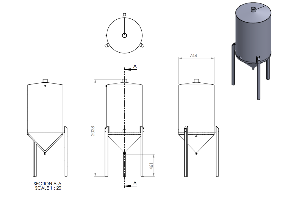

Progress! New plant designed with most of the features of the existing plus, quad core condenser, eductor (to cope with mixing the large volume in sensible times), plus a venturi for pulling in meth and drying (I'm thinking of washing and drying in the processor, given it's size. It's gonna have a dual cone sealed from the vessels internals, this will have water in to heat the oil. No contact with the heater element, means the element will stay clean.
What du think?

Looks very compact so far,
Guessing the pump and valves will be mounted in the under-space?
Gra.
Graham
Pumps will be on brackets welded tween the legs. There'll be lockable lever ball valves underneath (pull feedstock in on the pumps suction), there will also be a 1" venturi on the side and a meth mixing tank on the side of the processor with a mixing handle in the top. I'm hopefully future proofing it to cope with some of the newer processes we're playing with at the moment. I've costed it up and it's made me gulp a bit (mostly the cost of the tank being SS). Anyway, I'll post pics as we go so it can easily be copied :-)
