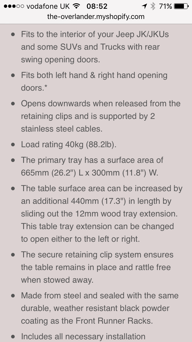

That's a screen shot from the website @clivehorridge
It's a well made item, it'll get mounted to the wheel carrier.
The website says it's for a jeep door but why should they get all the good stuff lol
Likely that will fit my larger of the two ambulance doors, would be a nice touch.
