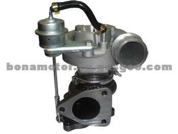

Shayne, the waste gate actuator is rather difficult to see through the engine bay. The top heat shield and side one must come off to gain better access and from there it's once again difficult to get to the two actuator bolts to undo it. This is why I did mine when the engine was out. I've never investigated in the actual unit but if possible it would be great and more professional to remove the spring and replace it with a stiffer one.

I can see the actuator just about , will have to remove intercooler , air box pipe and heat shields to get to it i reckon . What i have not been able to find is a clear picture of the actuator on my truck and it seems some 1kz (on different toyotas) have adjustable arms on the actuator which would make upping the boost easy . What concerns me most is taking it all apart only to find no adjusting arm and the spring is held in a sealed unit so i can only get to it with a hacksaw like this http://www.youtube.com/watch?v=OvPAUtDKq6Q

The actuator part is located on the left on this picture, with the long lever which opens and closes the boost pressure valve. On the top where the hose goes into is what I believe is a sealed unit containing a diaphragm and and spring which operated the lever. I highly doubt it'll be possible to replace the spring but it may be worth looking into it a little more. Where the one bolt is shown is where the washer should be placed, in between the gap stretching the spring slightly as you do so.
Ah i see so you actually moved the bracket 2mm using washers to preload the spring a little . Forgive me for questioning this but does that not just let the turbo cut in earlier rather than upping the boost psi ? . I imagine it would make give a very noticeable difference if you were running a stock exhaust but i think i have achieved the same by adding a 3" exhaust ?
I've read those with an adjustable actuator arm shorten it to increase boost .

After a few more hours of reading and watching wastegate vids i reckon the washer behind bracket probably works better than shortening the actuator arm . In very basic terms all we are trying to do is delay the wastegate opening , so to shorten the arm we are just preloading the spring whereas moving the bracket adds preload and reduces how much the wastegate actually opens . 75% open is said to be perfectly safe .

Spot on Shayne, I used a 2mm washer but I've heard of surf guys going up to 6mm...I think they can get away with it as they have the earlier 1kzt engine with no ECU so there is no fail safe or boost cut off. I think 2mm is a safe option.
