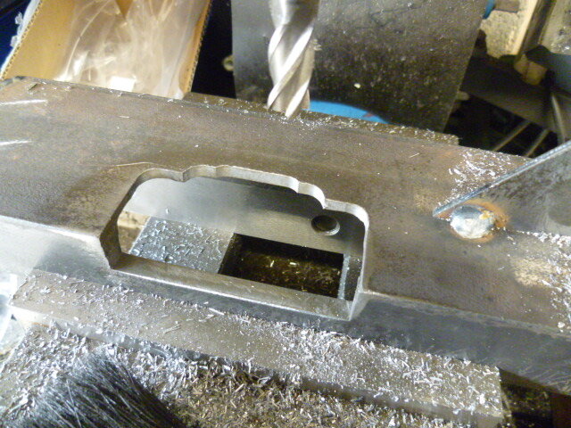

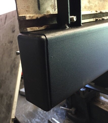

Milled some more out for the exhaust to keep Andy happy. I could just attack it with the angry grinder but where's the finesse in that?

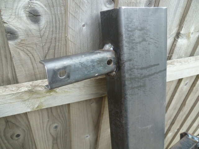

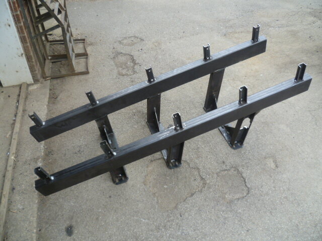

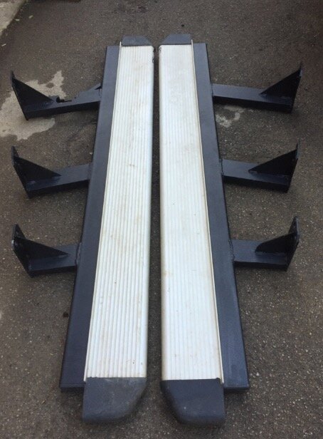

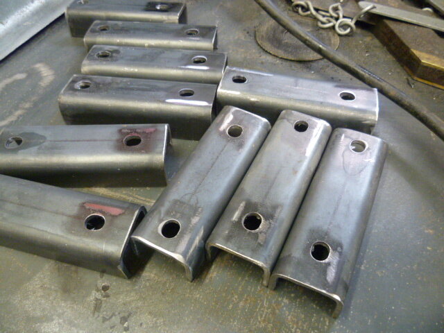

Then made up the 10 step support brackets.
These weld on here like this. Handy bit of U section I had knocking around. Slightly slotted the holes just for wriggle room.

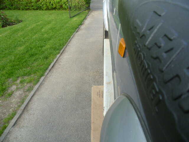

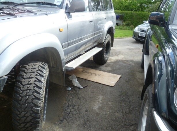

Offered the steps up for final fiddling session. Just a couple of snicks needed with the grinder tomorrow
I have only nipped them up with half the bolts, but there was no flex at all with me standing on just ONE peg.
Profile looks good to me.
