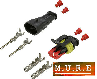

I use the SuperSeal connectors - a bit fiddly to work with but very good.

Gary. I have some MUCH better versions of those connectors. I'll show you when you come down. They are very nice and incredibly cheap. They lock too. I don't mean snap shut, they lock. There is a small snag though. More later....

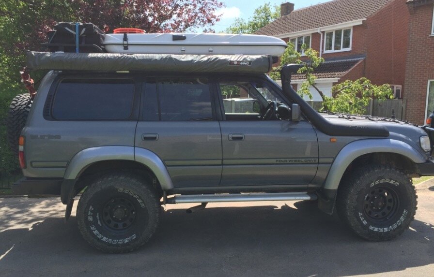

So like I said. I moved the RTT forward so that the rack space is now at the back. it works much better. I bought a very sexy holdall from Stan the Man in which you put three Wolf boxes. It's waterproof and dust sealed (as much as you can) so you don't have to hold the boxes down, you just tie the bag down with the boxes in it. It's proper. The RTT ladder now goes up the back of the truck onto the rack luggage rail.
Looking good Chris. :thumbup:
Are you going to do anything with the zorst - or leave it side exit for now?
