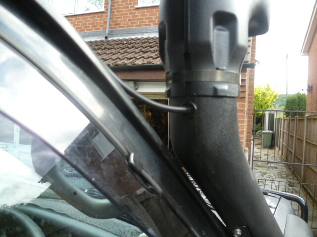

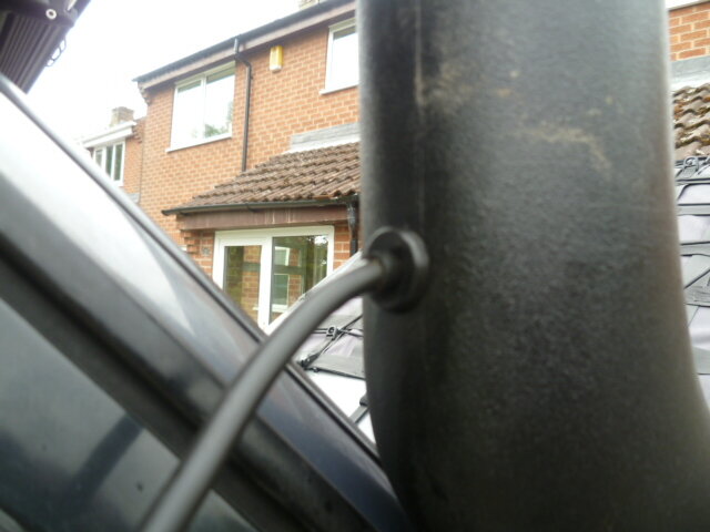

Put a wire down the snorkel. Yes. Put a wire down the snorkel and connect up the light bar. In the end, I replaced two airbox mountings that seized and snapped. Well one snapped and one ripped out of the wing. I did the steering box adjustment because I was in there so all was not lost but **** me ****ing sideways from Sunday. What an ****ing **** of a ****ing day
Breathe. Calm. Think of kittens.
Yes drowning a couple of kittens has made me feel much better.

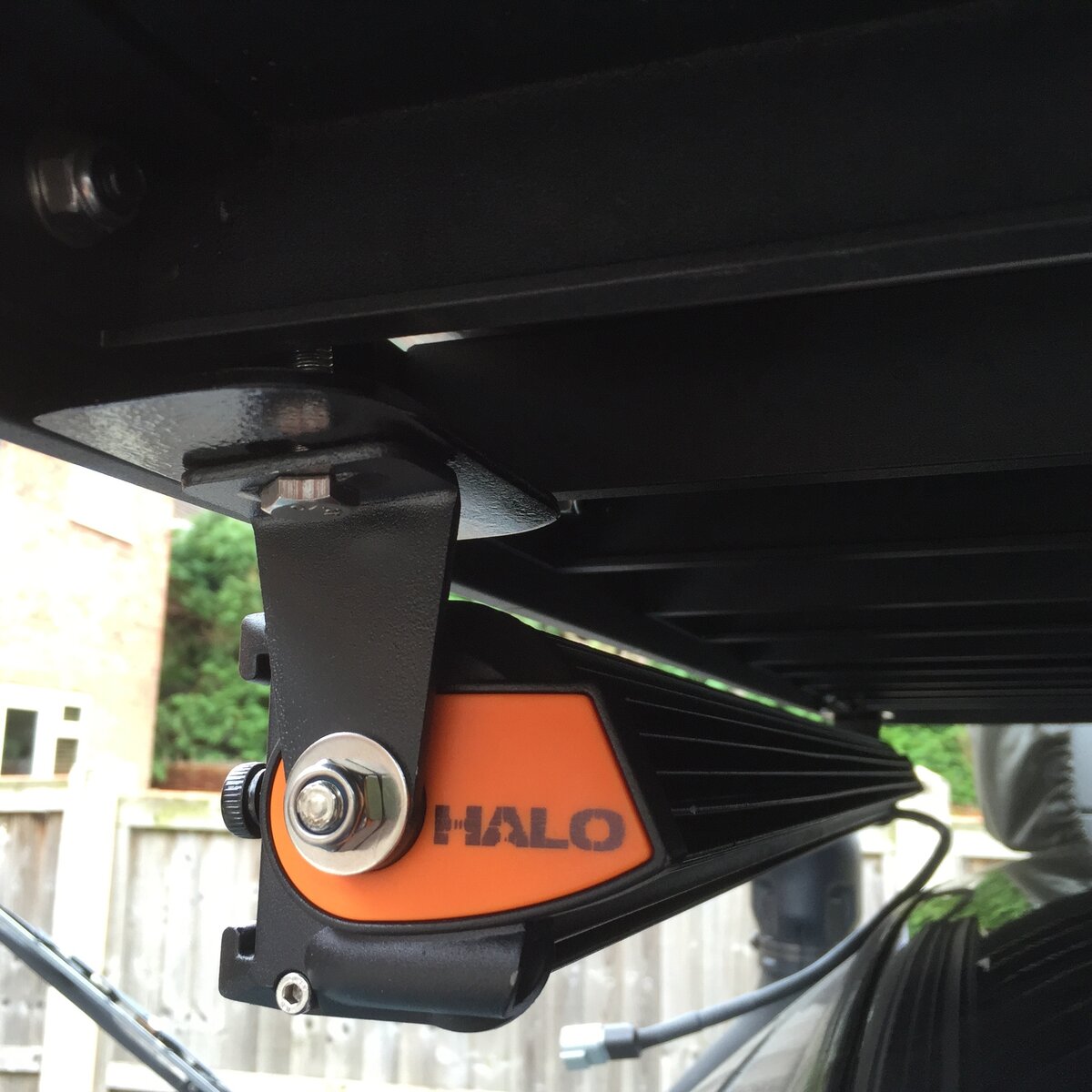

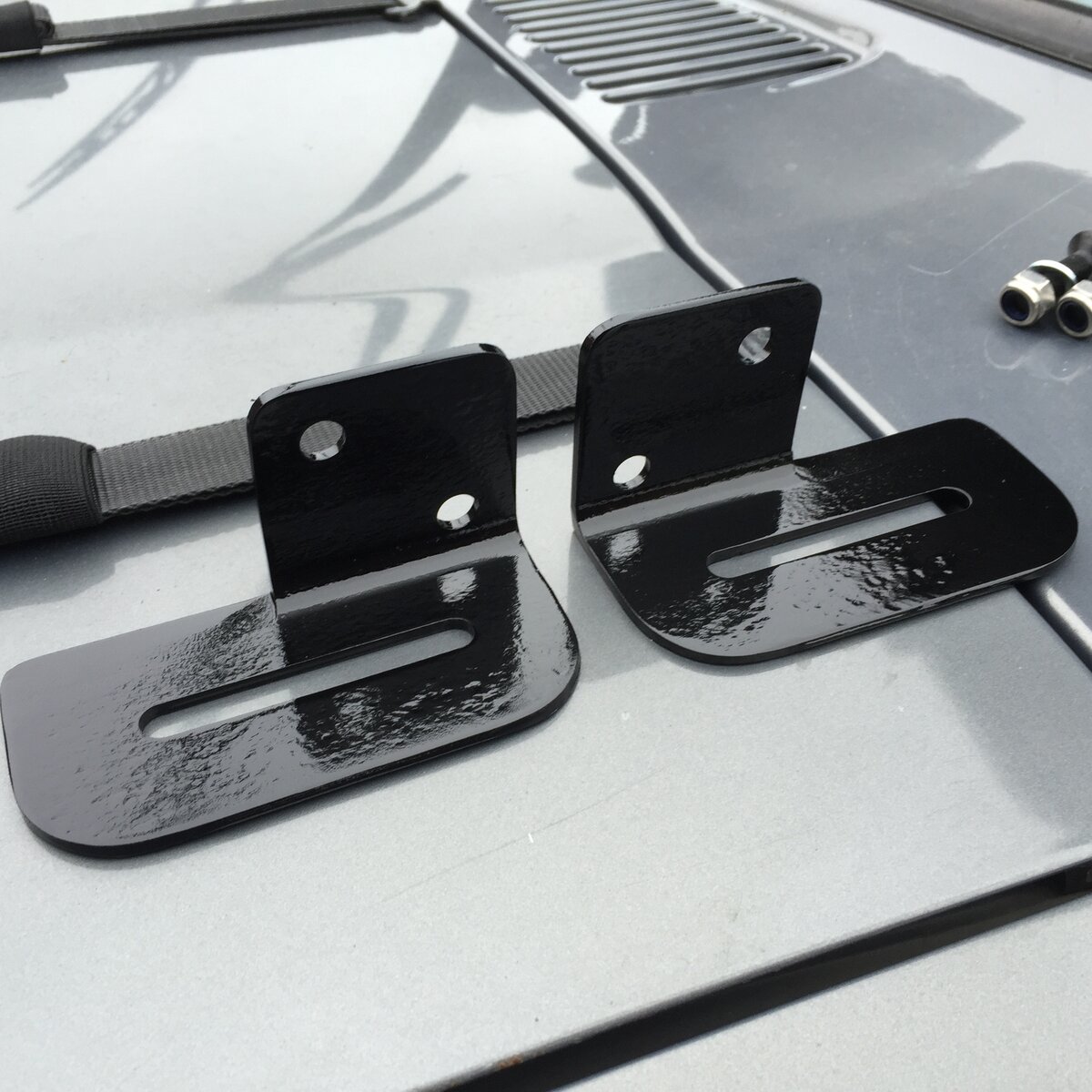

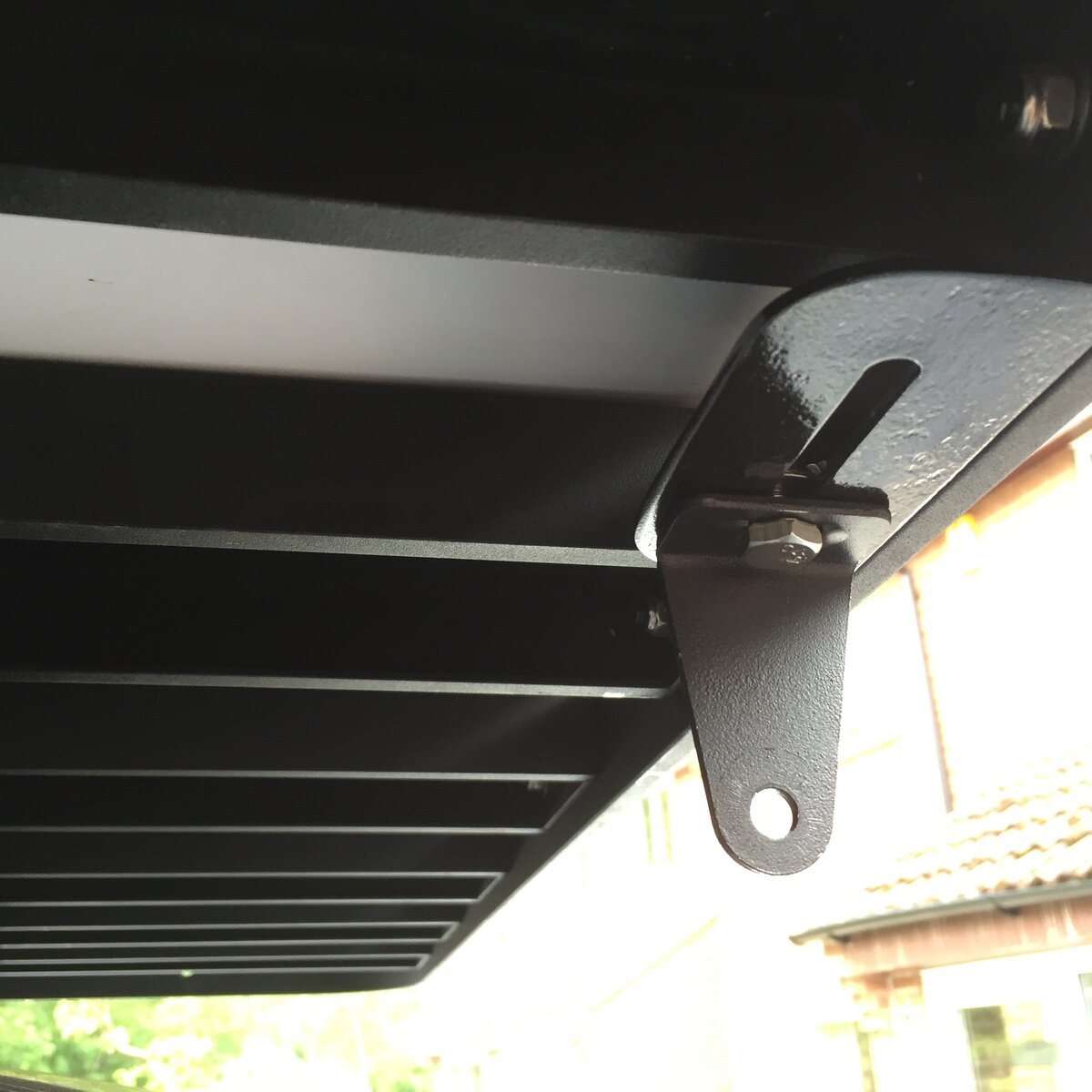

So basically I finished off the mounting brackets for the roof rack and got the Halo back into position. THey look crap in the picture. Not sure why they look all rippled. They're quite smart actually.

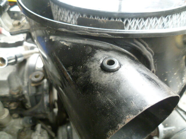

Drilled a hole in the airbox and finally got a grommet in there.

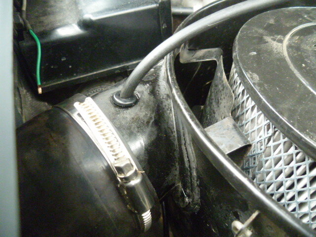

Fed the cable through
Put a double grommet in the top of the snorker
And coupled the cable up to the plug. Now I had to cut the factory loom because rather annoyingly it had fat connections at either end that wouldn't pass though anything. I had some 25 amp twin so that was fine to patch in.
And there you go. I used the old KC Daylighter wire as the relay trigger so no messing with the bulkhead. Job jobbed. Finish line ahead boys ...

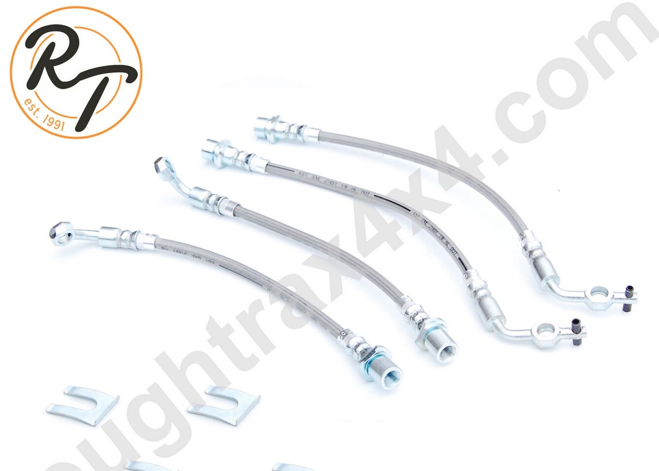

Braided stainless brake hoses just arrived from Roughtrax. I'll get those on this weekend and report back. Very fancy looking. Hopefully will be better than the 21 year old rubber ones on there now. Brake system in fine fettle with new pistons and calipers too but whilst there is plenty of pedal feel, I don't think it's exerting as much braking force as it could. I have slotted discs all round and good pads but at fully loaded weight close to the Bismark, it takes some stopping.
A load of porkies, I recon, where's the photos?
1/10 Chris, should know better :lol:
So you'd have me post a picture of a packet?
You're odd.
Maybe I'm odd, must admit I'm not interested in the packet, but I've led a simple life Chris, never seen braided hoses for an 80, yet.
Suppose I'll have to wait for the fitting tutorial.... :angry-tappingfoot::crying-yellow:
Come over all funny now, after that lot. They look the dogs thingies. Thanks Chad :thumbup:
I'll have the thread-jack police after me if I don't go sharpish, ta very much...
Nope, they don't look anything like those at all. The braiding is completely encapsulated so dirt can't get in. Those look like something you'd plumb into in your bathroom!
There are the RT ones. Very slinky and smooth.
