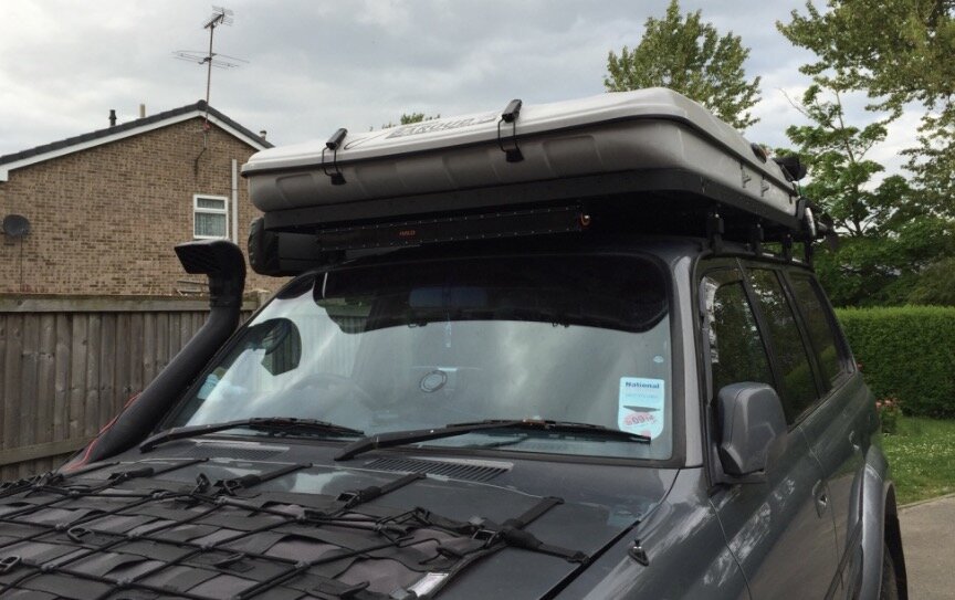

Went laning in Wales this weekend fully loaded. Both fuel tanks, water, boxes, recovery kit etc. The drive there was smooth and pretty quiet too since moving the RTT to the front. Had the window down and arm out most of the way, Truck was very good in the roundabouts and corners although I'd say under heavy braking I found the Cooper STTs a bit squirmy. Out in the rough stuff over rock steps, drops, bumps and so on the truck was incredibly poised. Articulation was very good despite it not being set up as an off roader. The new FNB bushes must be working well. I have no rattles, boings, clunks or other alarming sounds and incredibly nothing got thrown around inside. Everything stayed in place. All I could hear was the gentle hiss of the dampers as I rocked about. At the end of the big lane we compared temperatures of the dampers. The EFS was barely warm.
