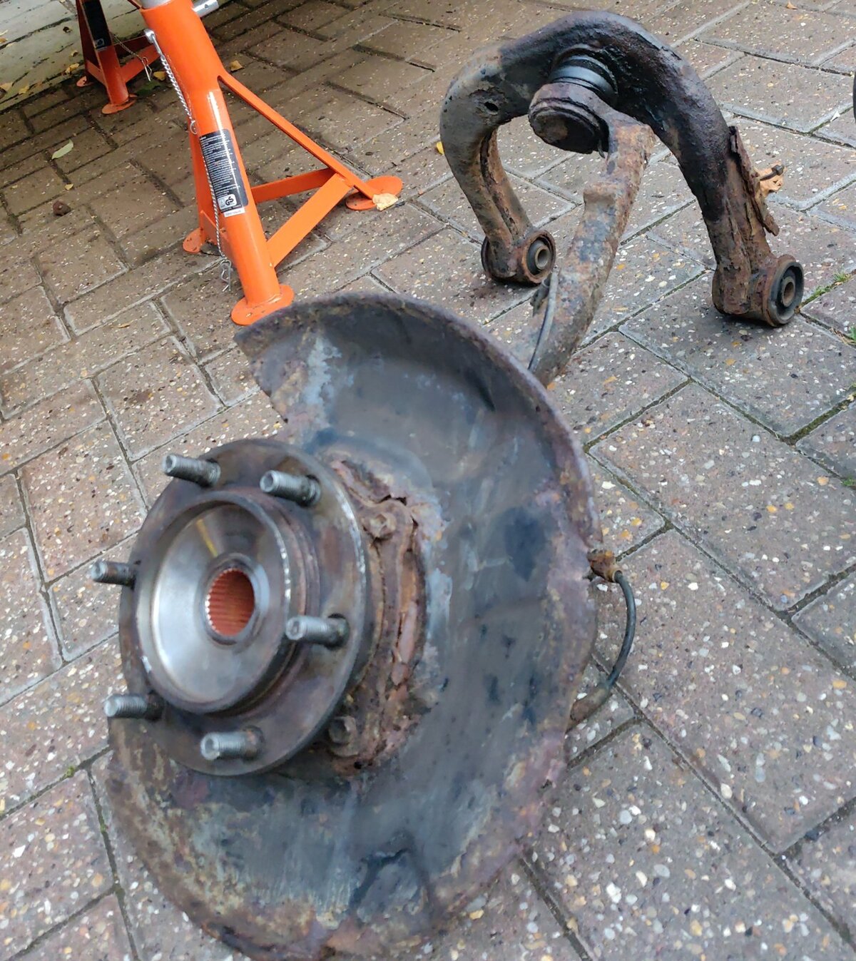

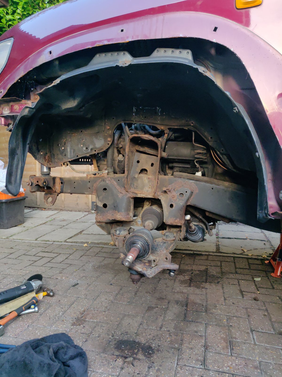

N/S upper arm and steering knuckle out... Lower arm ready to come out when steering rack comes off which will be after I get the other side disassembled.
Decided if I'm doing this truck I'm doing it so new steering rack it is.
So that meant I chopped track rod end off with grinder as putting in new track rods along with new steering rack along with new ball joints and new arms... Only but joy being replaced is steering knuckle albeit the wheel bearing will be done.
Tomorrow evening do the o/s then Thursday steering rack. Hopefully by then josh will have done polly bushes in arms so those can go back in.. Then push upper ball joints out of knuckles along with hubs.. New balls in.. New wheel bearings in.. And as the book of lies says... refitting is the reverse of removal!
Also means the pedders/monroe shocks and springs can go in.
Surely it makes sense to clean up and paint what you can see before you bolt it all back together . I did a half assed job on the mrs 90 just because i had the shocks out but because i used zinga theres no rust to be seen maybe 2 years later even if i did go over it in cheap thin black paint .
You're right mate and I should've said that was next on the list before it goes back in. Need to order some raptor paint.
