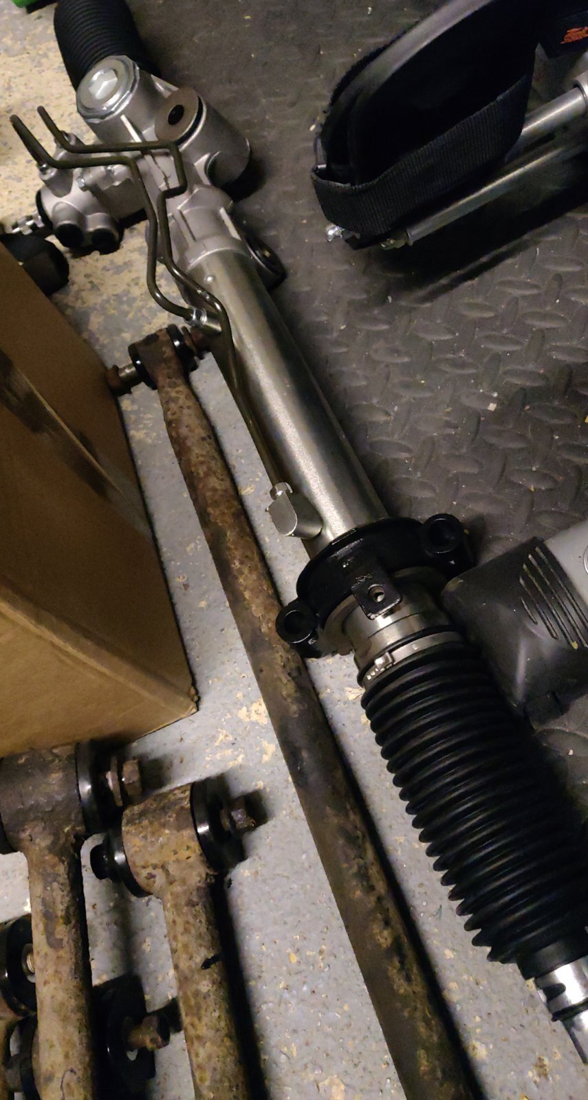

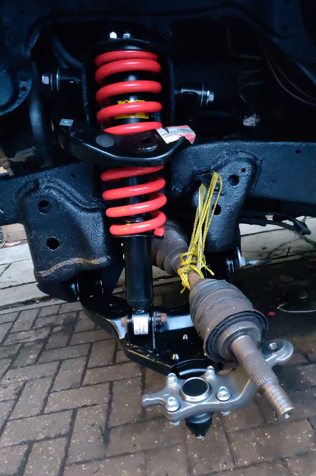

    Still a slow week... too much going on at work! But both sides front arms and shocks in... knuckes are getting sorted out... ordered up wheel spacers and longer studs. Planning on bashing out the steering rack and doing some cleaning and painting this evening.

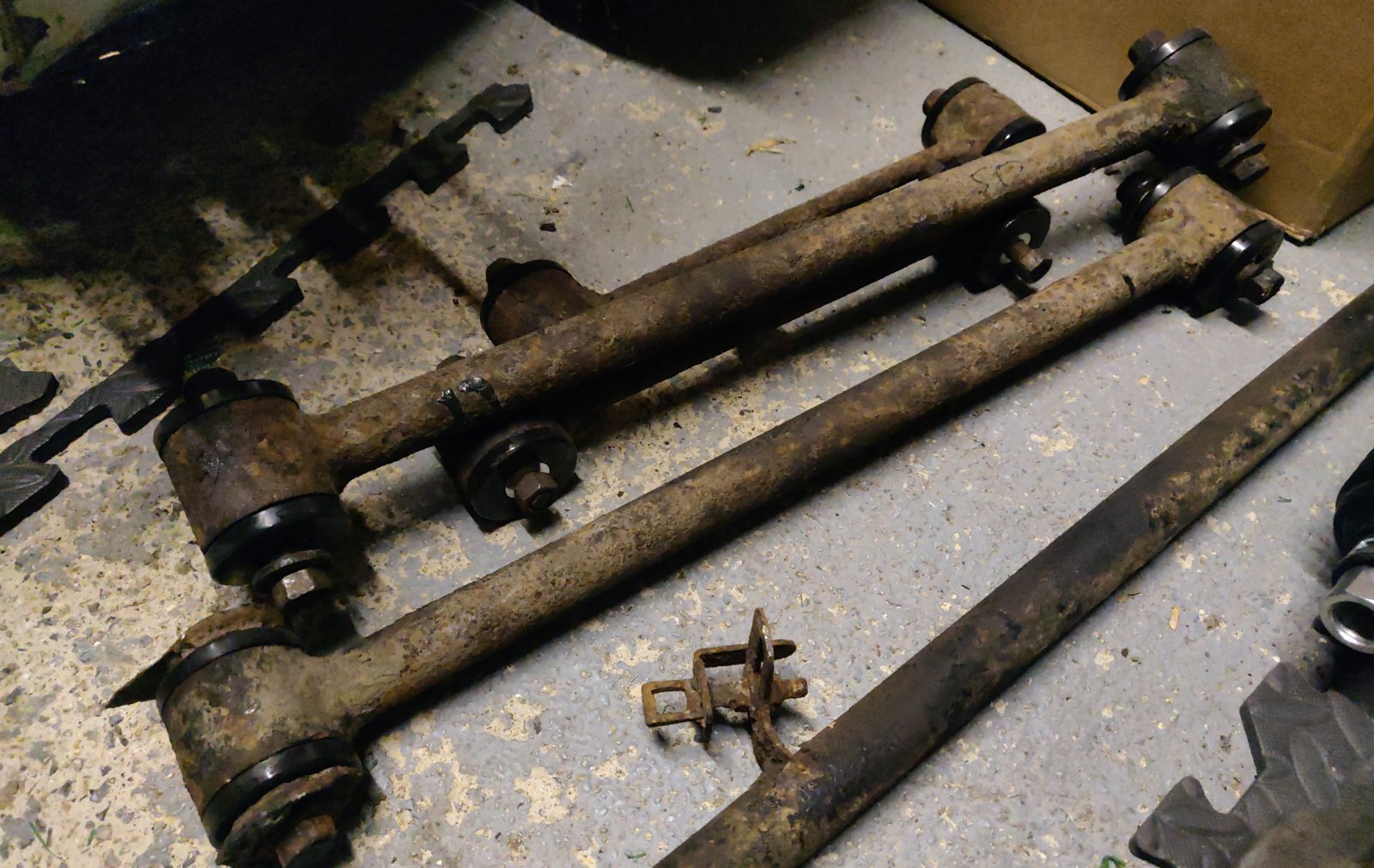

    And these are ready to be cleaned up and painted... New polly bushes fitted thanks TO Josh and Jason

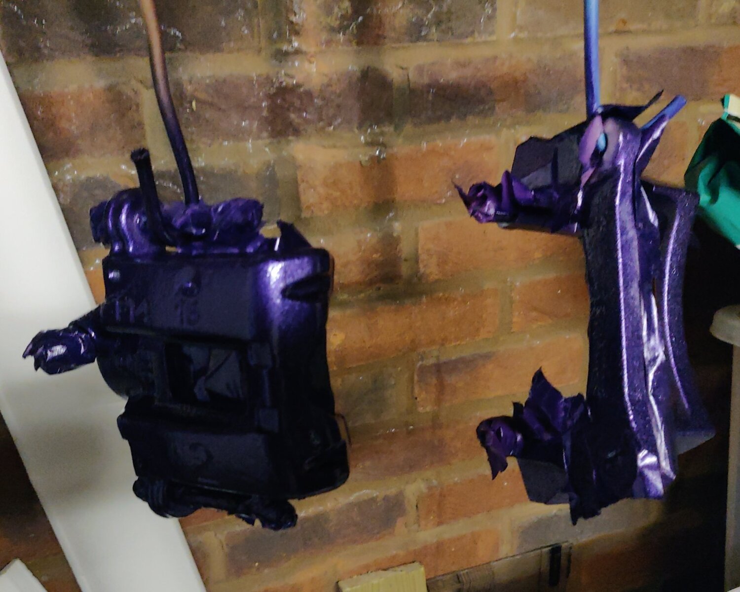

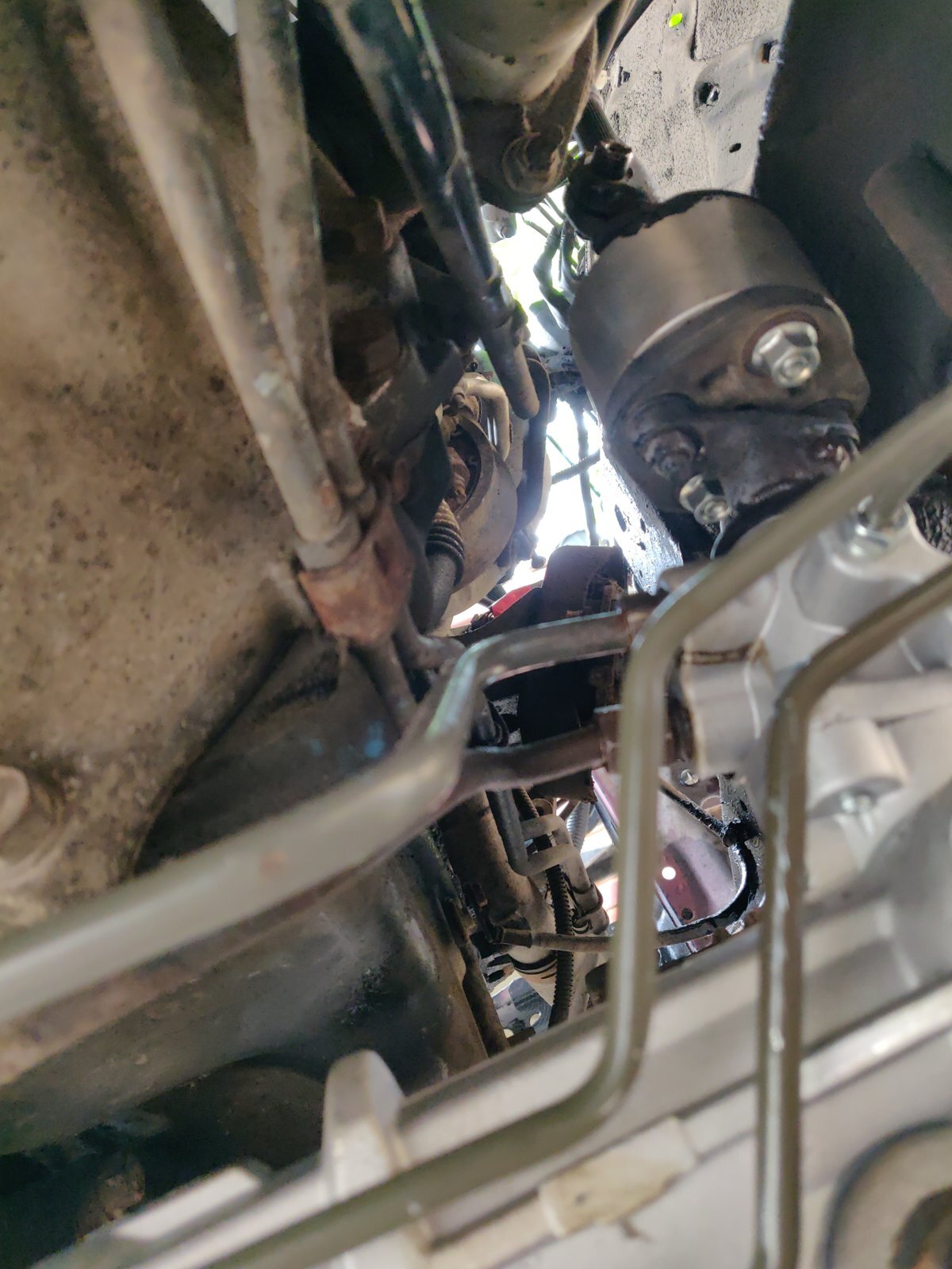

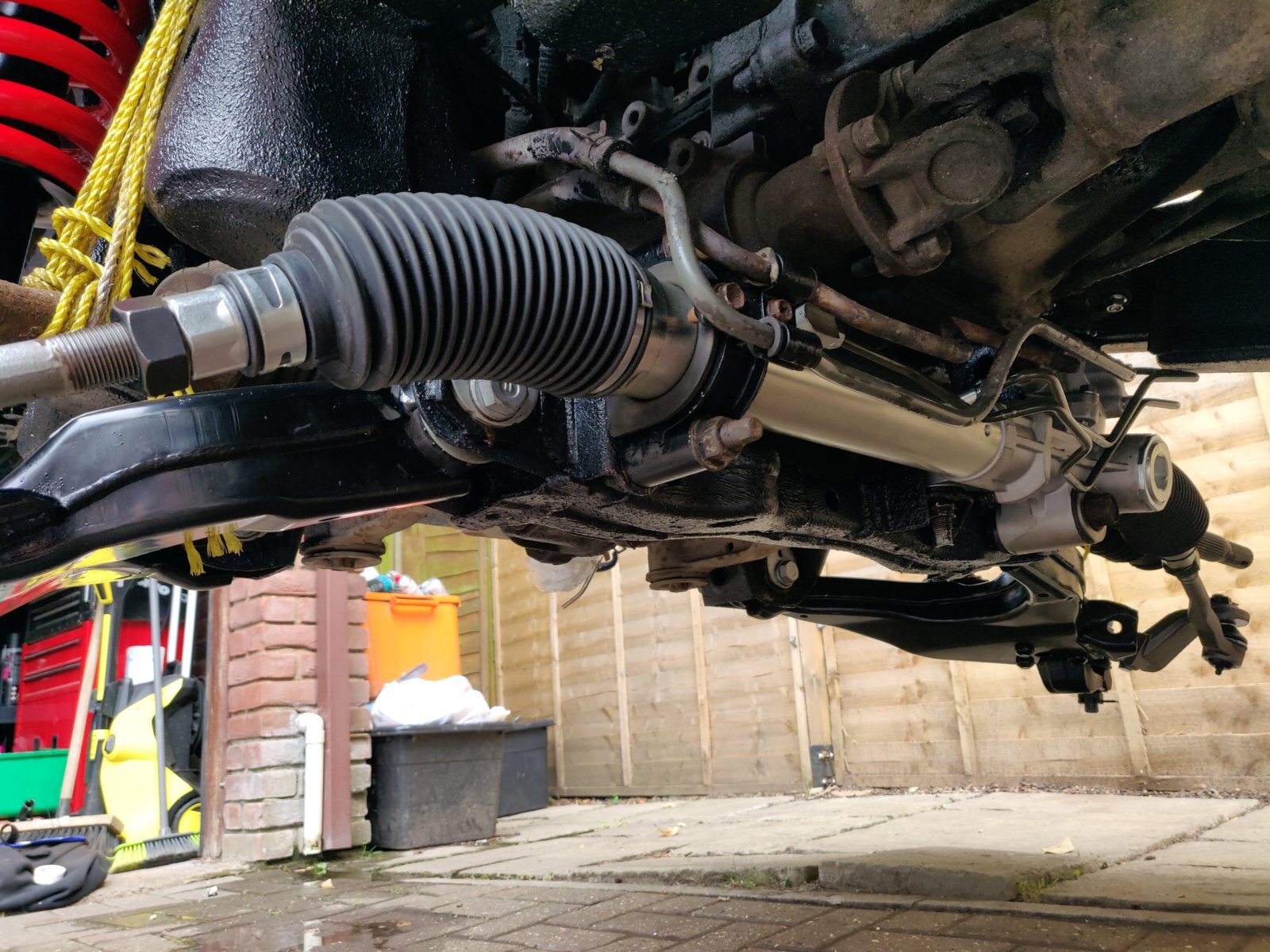

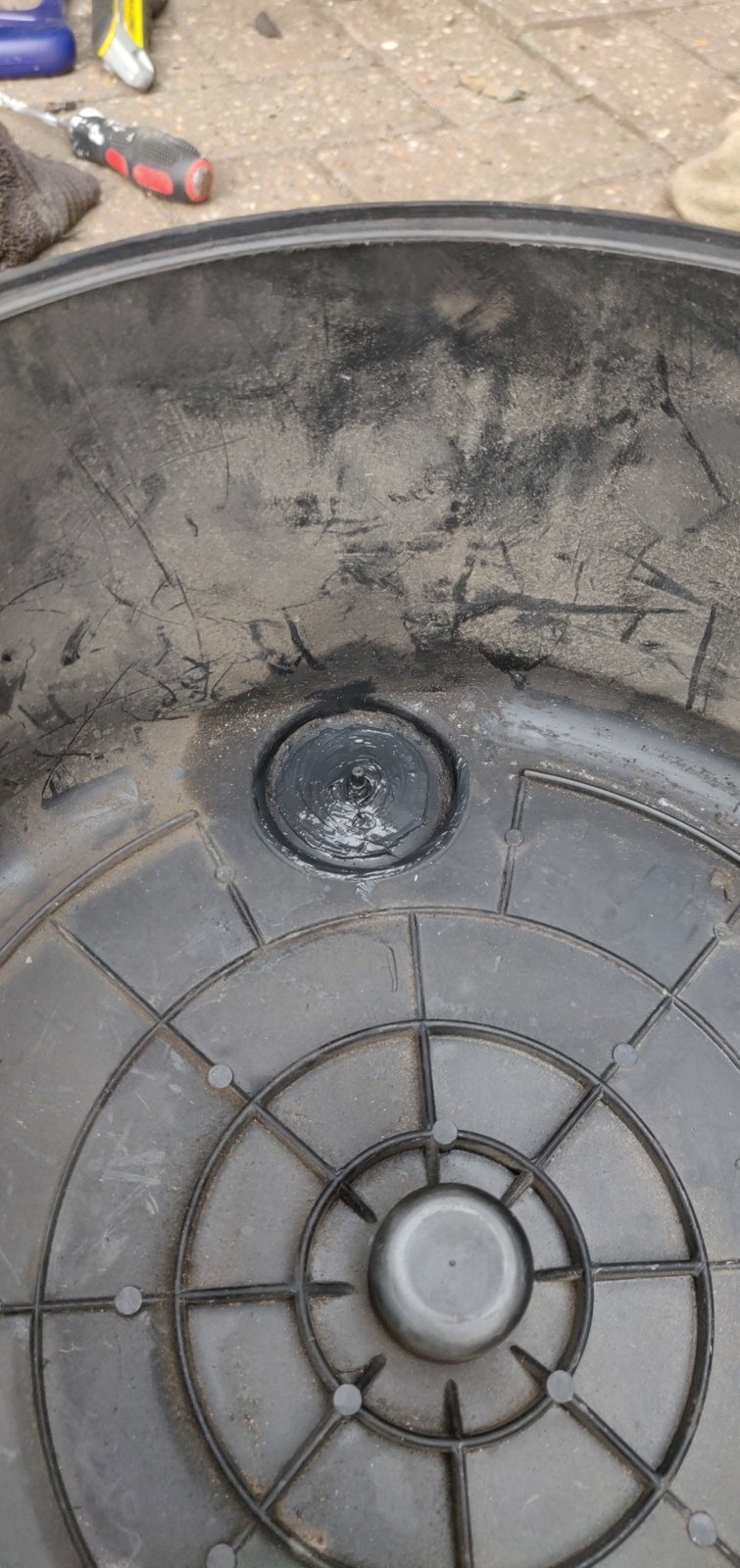

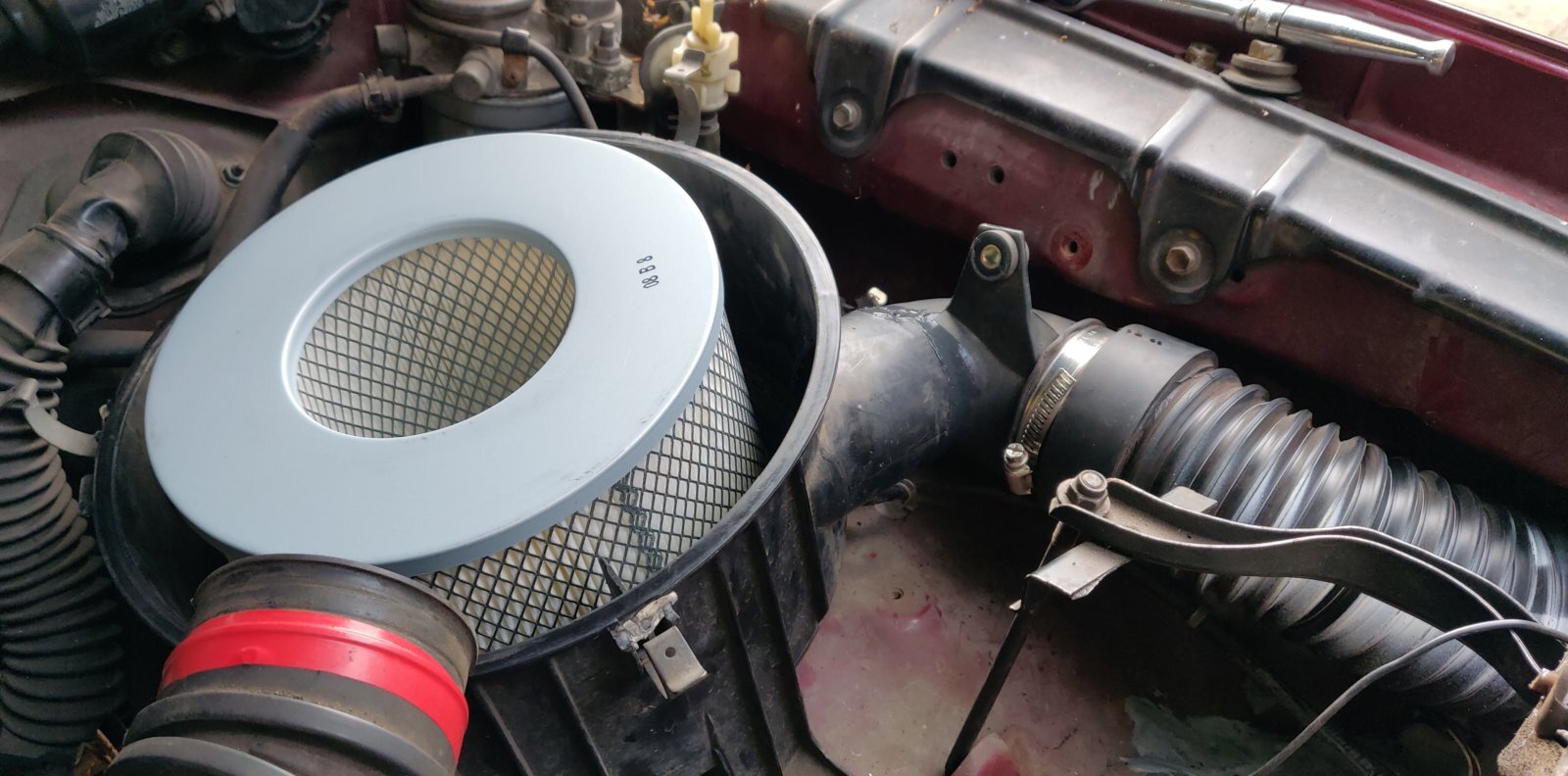

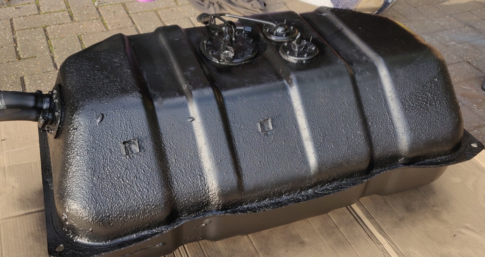

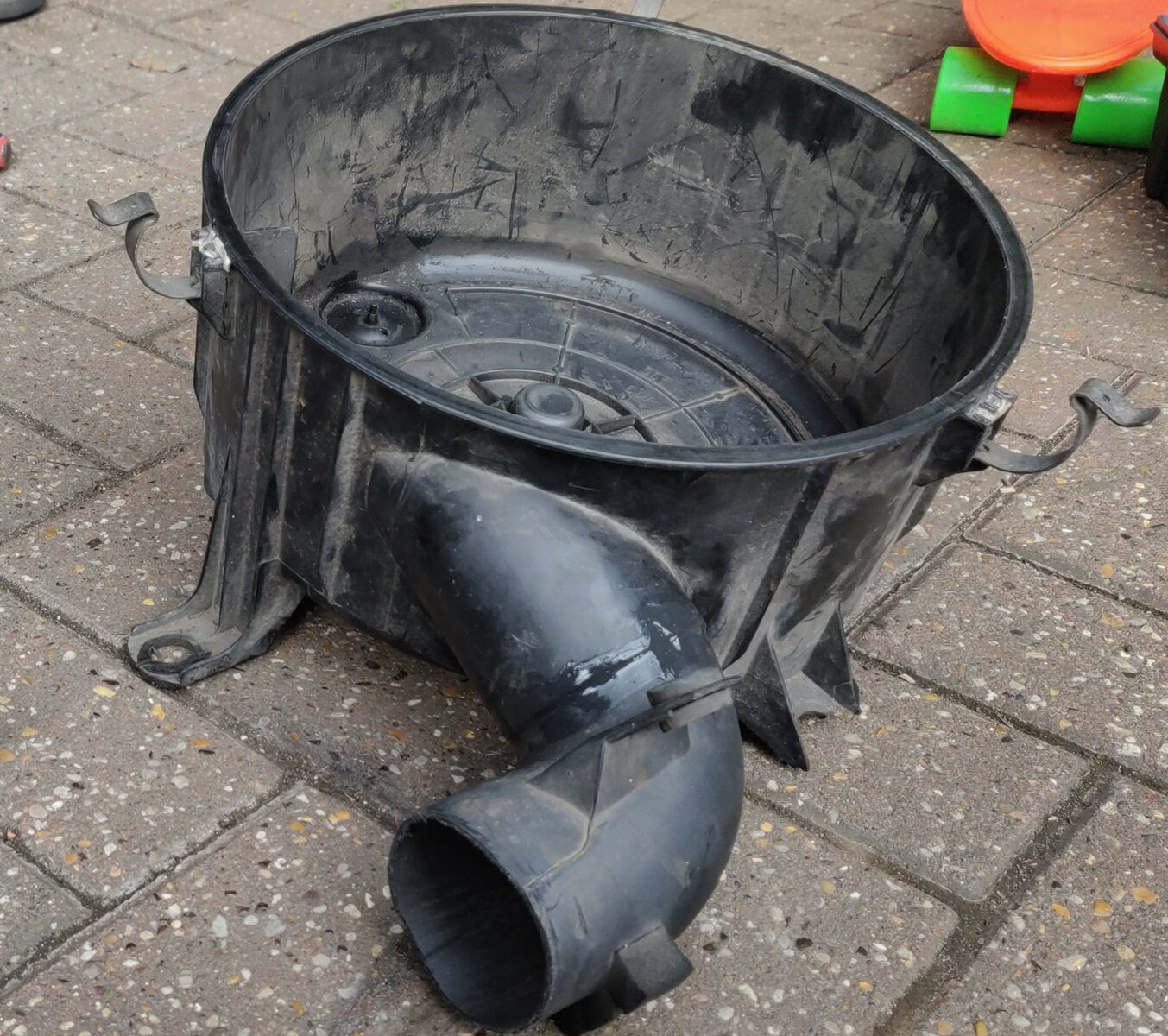

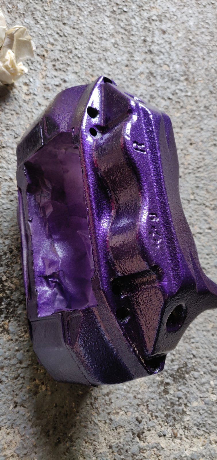

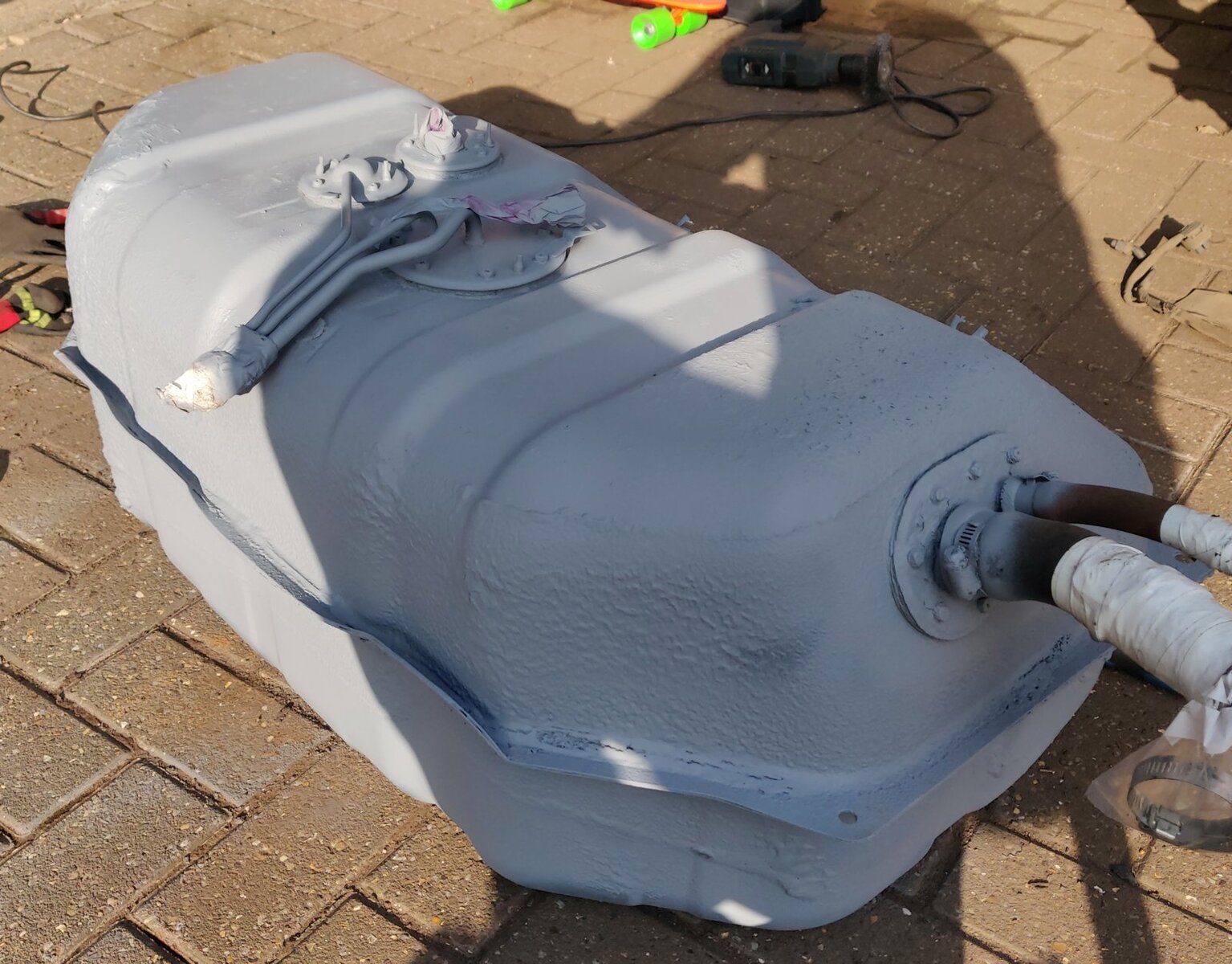

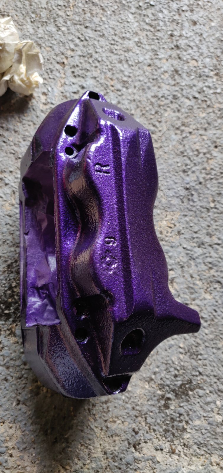

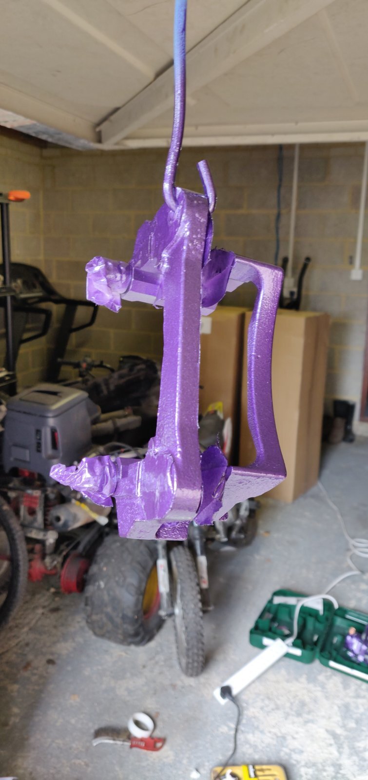

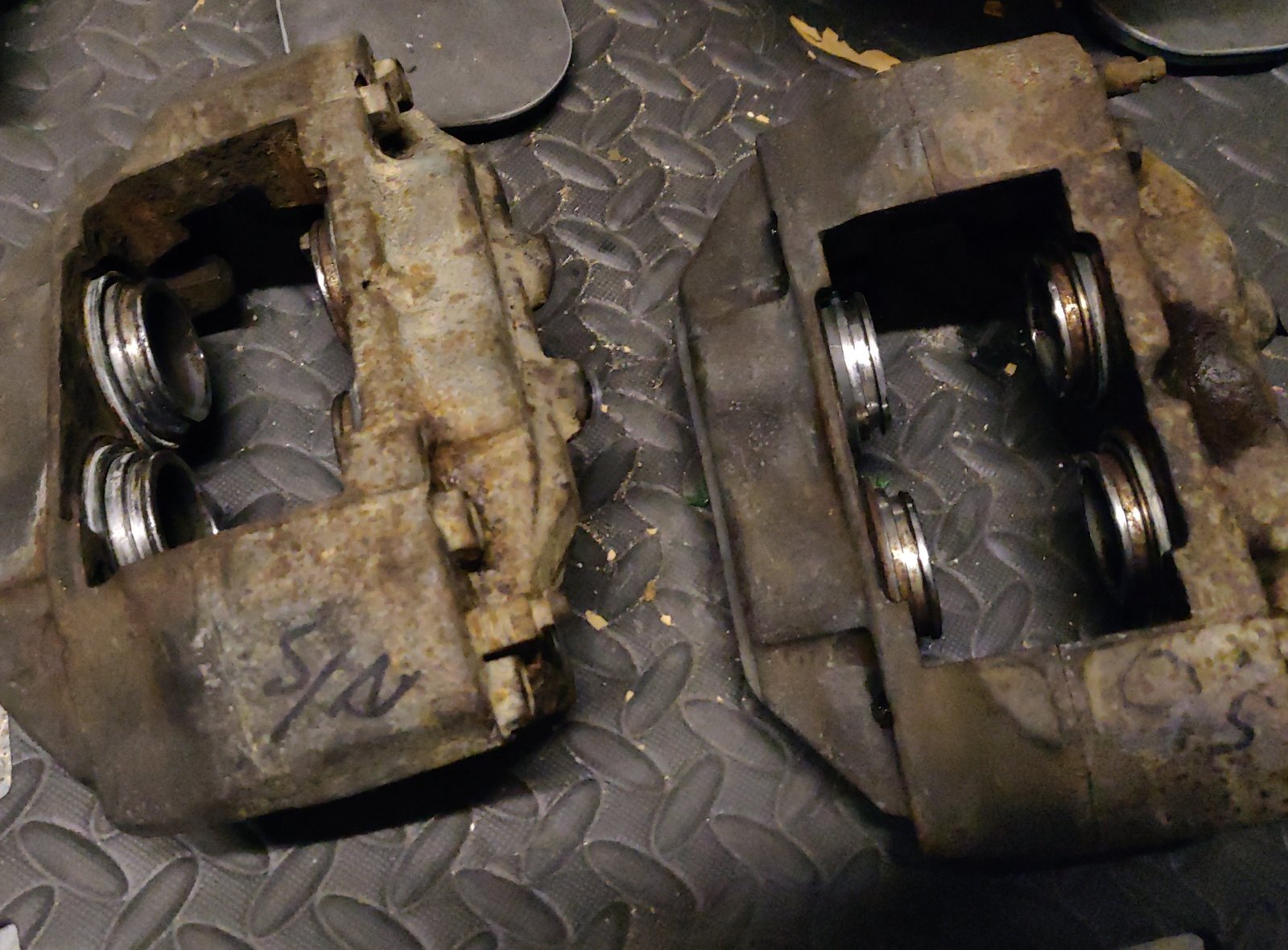

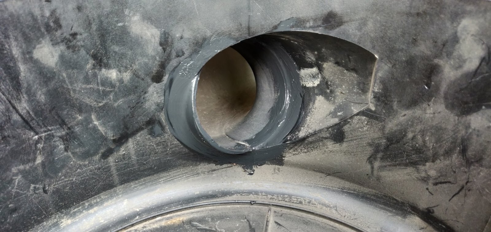

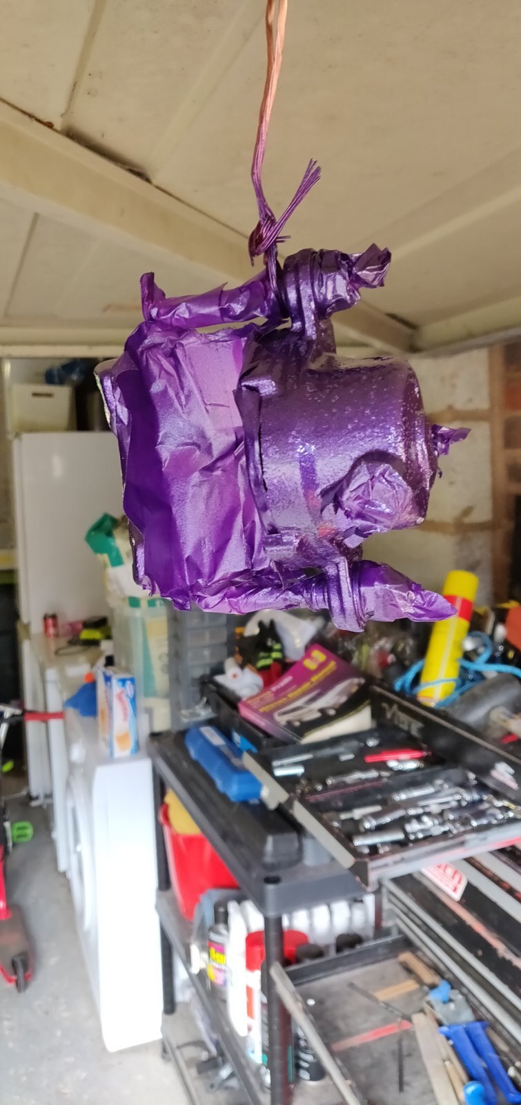

    Today...
    Calipers cleaned and painted
    Steering rack installed
    Track rod ends in
    Steering adjusted seems straight (hahaha!)
    Air box modded for wading
    Fuel tank cleaned and painted
    IMG_20190803_143958.jpg IMG_20190803_170824.jpg IMG_20190803_143948.jpg IMG_20190803_170826.jpg IMG_20190803_144040.jpg IMG_20190803_170959.jpg IMG_20190803_170918.jpg IMG_20190803_170855.jpg IMG_20190803_170851.jpg IMG_20190803_170908__01.jpg IMG_20190803_182306__01.jpg IMG_20190803_171546__01.jpg IMG_20190803_185410__01.jpg
