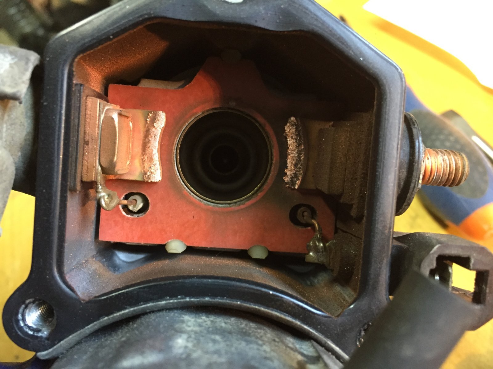

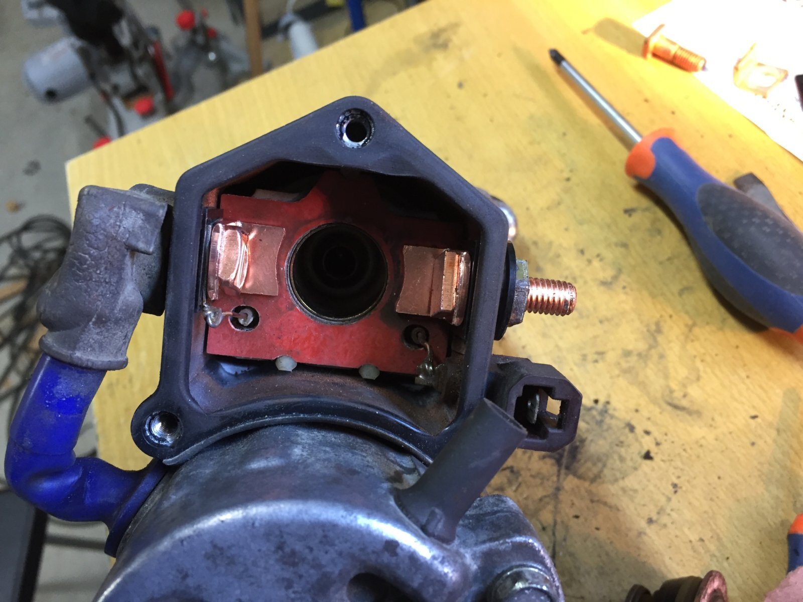

Thanks very much for the help - I got my kit from http://www.repairkitsuk.com/1.html a while back and last weekend I finally found time to install it. It was all pretty easy except that I was having a nightmare getting the socket on the upper nut holding the starter motor on... it was only when I managed to get my hand on it, that I realised the reason was there WAS no nut ... my starter motor was held on by one and wishful thinking.
I also managed to confuse myself with the kit, but I called up repairskits and they were incredibly helpful.
The truck has started perfectly every time since I installed the kit. Very happy!

Before:
After:
That looks very familiar Ed, not too bad a job is it? No doubt you put the studloc on the 3 screws. :innocent:
Good of job you did it as it highlighted the need for the extra bolt.
Good pics BTW and thanks for letting us know how you got on. They actually do an extended set of contacts for where the ones on the 80 get eaten away. This mod has been ok on mine for the last 10 years.
