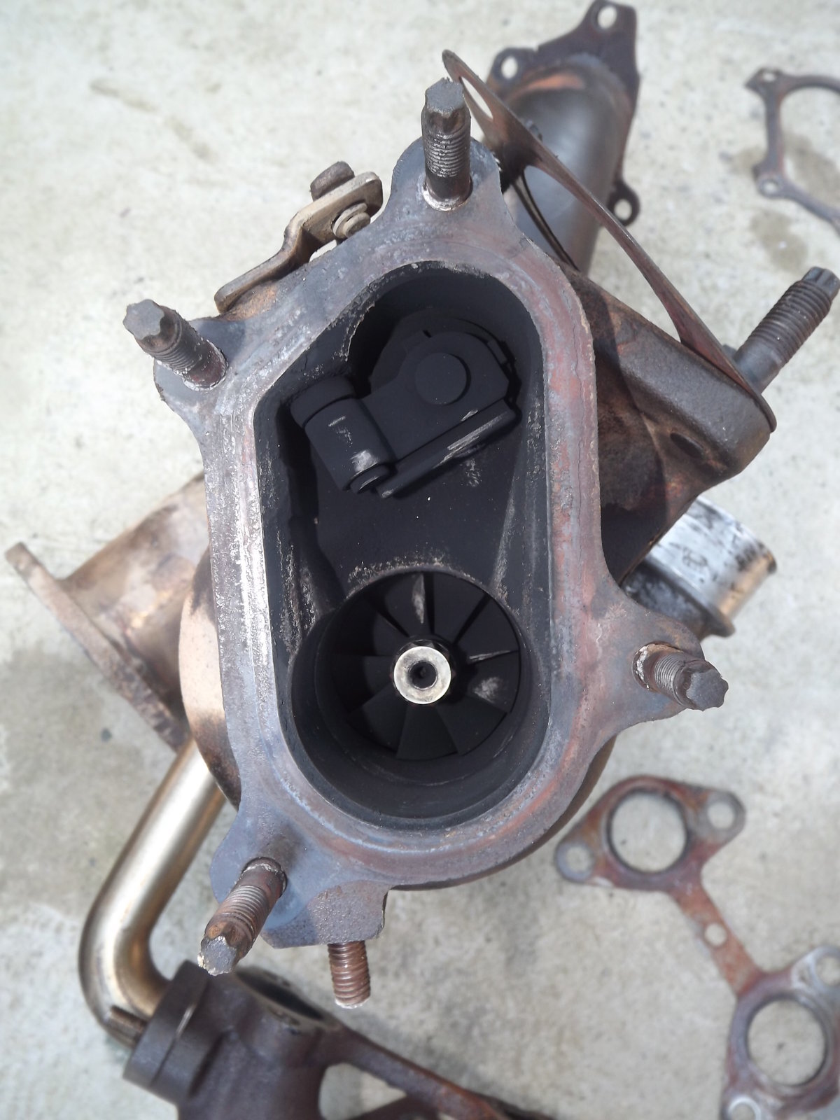

Yes Beau 100+ mph popped my new zorst first weld after the down pipe . I have read a fair few comments about how difficult the down pipe is to remove , including "the gearbox must be dropped to get to it" but i've just removed my cooler and heatshields and i reckon i can get it off :handgestures-finge: , if i can i think i will take the truck back to prospeed remove it again and see what they can sort out .

Booked the truck in for Thursday morning and won't know for sure until it's been seen but Charlie seems confident he can fabricate and replace the down/dump pipe himself , he also mentioned a flexi joint so wait and see i guess .

There was lot of interest at the time so he made a jig , but nobody called so the jig got scrapped . Any custom exhaust shop can make one . If you could give them a gasket to use as a template to make the flange i imagine it would save them a lot of work on the day .
