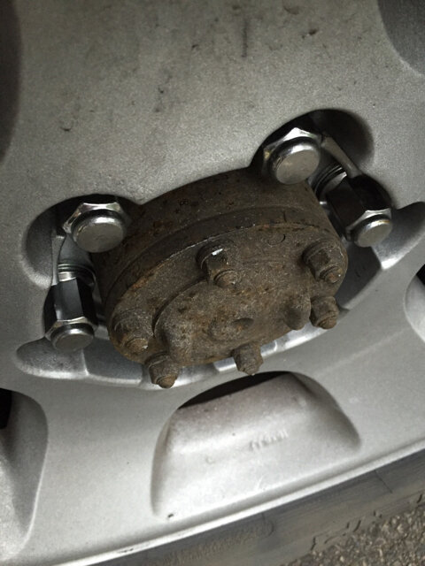

On the subject of spacers, the hubs on an 80 (and many other 4x4s) protrude through the wheel centre so even with, say, 30mm spacers the studs aren't taking the load and the rim will still have plenty to sit on.

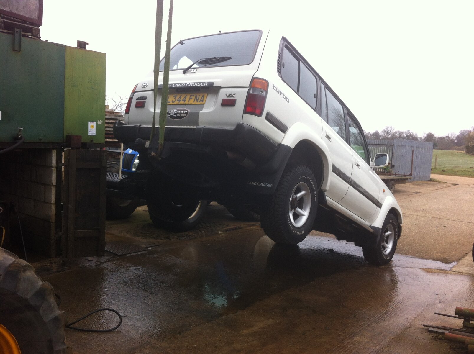

LC 5.JPGcheers for the info on the tyres, i've got 275/70/16 BFG all terrain on it now,
gonna replace them as the last owner put them on 14 years ago, 80k miles they've done, still got 7mm of tread!
was just gonna go slightly wider really.
as for the spacers... 30mm... front wheel would still sit on the hub....rear doesnt, so just held by the studs.
gave it a bath today!
Must be different to mine, being earlier.
There's at least 45-50mm to play with on my rear axles.
