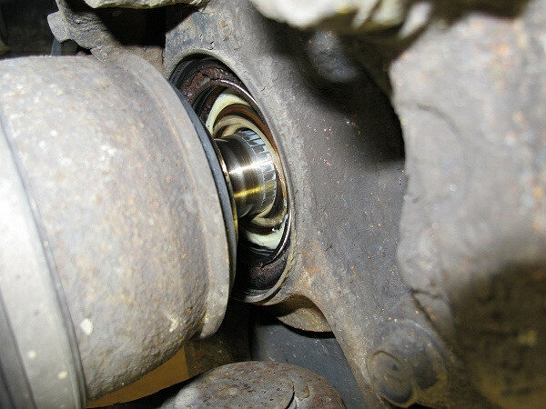

Last thing I did was checking the RHS spindle bearing, by just pushing the shaft in through the hub by removing the C-clip first. Looked good. Just thought I had to since I had to change the left one last year. Gave it some extra grease as well.
Next, I have to get around to doing the handbrake as well. As it is now, I have to crawl under to push the bellcranks back after each use.

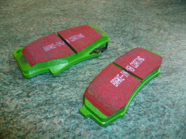

Spent a lazy day (well I am still on Greek time in my head and the Mythos hasn't quite worked its way out of my bloodstream yet) swapping the brake pads.
I like to do a bit of preventative maintenance now and then and whilst clearly there is loads of life left in these pads,
I thought I'd try some new ones from EBC. Very nice. Good packaging, came with shims and a coating for bedding in.
There does seem to be a lot more friction lining than the ones I took off. Do you think there is too much? Maybe I should grind a bit off using the perfectly good ones as a template. Hit a different snag on every damn caliper. Torn slid pin boot, snap ring slipped off another, tear in one of the main rubber boots; you know the sort of thing. Had spares of everything in my parts box. Thanks to a certain Mr Rubie
Don't think I'll feel much difference though. As I say I like to change things out before they become a problem :whistle:
Chris

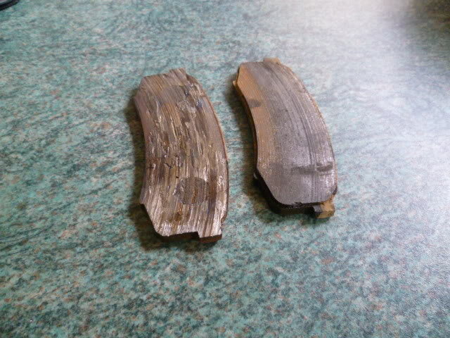

thats the joy of Insa Turbos you cant even hear metal to metal :lol: :lol:
The fronts had more on that that. Maybe as much as 1mm. I checked them a while ago and they were all fine. Had quite a few deep mud off road excursions recently and I think that they just got ground away. Plays havoc with the brakes which are by any standards one of the worst designed parts of the car IMHO.
Chris
Those green pads will clash with your red painted calipers. :auto-car: :auto-driving: :auto-layrubber:
