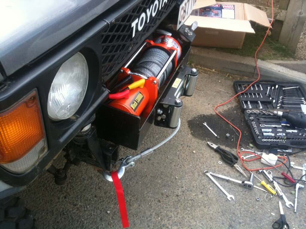

Installed a wireless remote for LB winch. Not reason, just because I could. It was a ebay special (http://www.ebay.co.uk/itm/WIRELESS-WINC ... 7789649502) and at £25 it's a no brainer.
Half the price of the equivalent one from Devon4x4, and it comes with 2 remotes.
Only issue I had was the wired remote on LB switches ground as well as positive and it took me a while to figure out what the extra wire was for. Had to hardwire ground in the end... :roll:

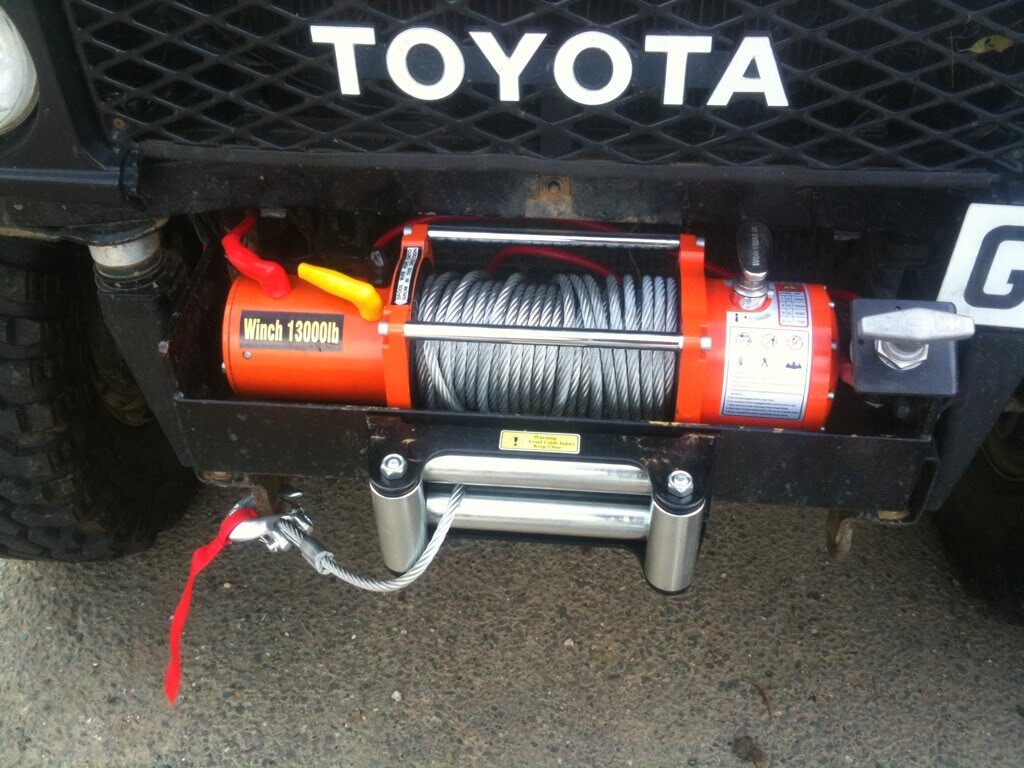

Fitted new winch on the 70, wireless fobs as well, tres posh
is that a "winchmax" winch ???
i had loads of trouble with my old one and i only used it to pull out a pampas grass plant .... and 2 kaput motors ....ditched it in favour of a goodwinch winch
