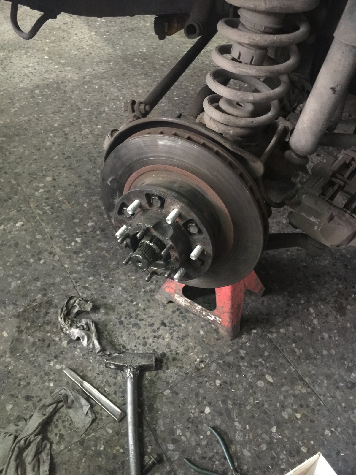

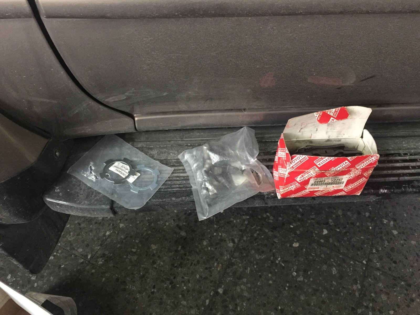

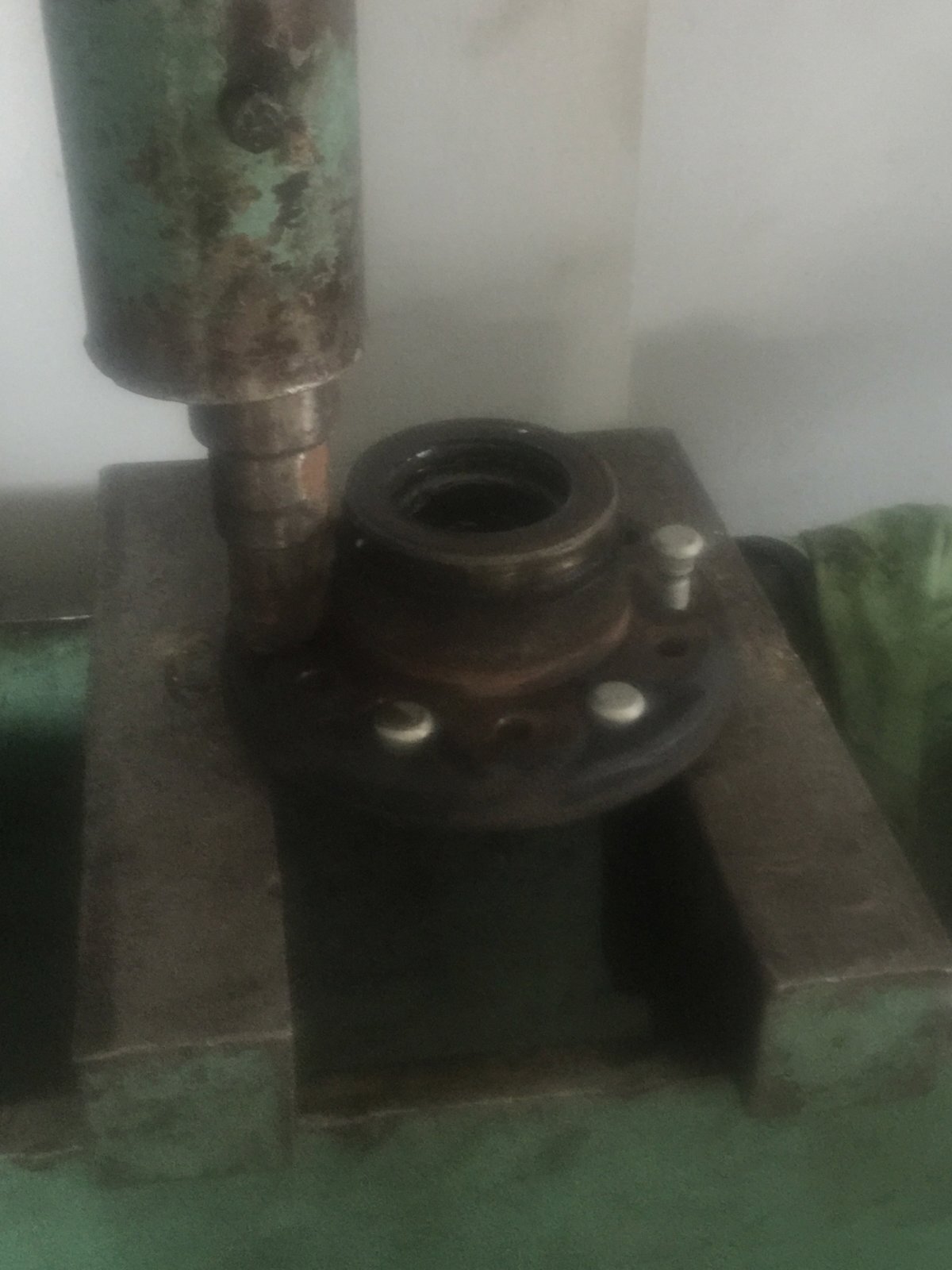

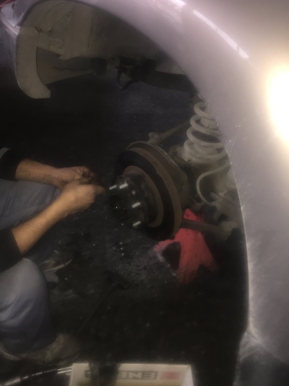

    Today a small maintenance operation went underway.
    1. One broken stud long over due replaced all six as new and corrected existing length of old being longer ones most likely the rears.
    2. Replace locking tab for stub axle nut (wheel would come loose after time)
    3. Replace front pad with original Toyota (no more squeaking brakes driving me crazy this last 1 1/2 years lol)
    Few other jobs left for next time all due to care and attention more than anything else.

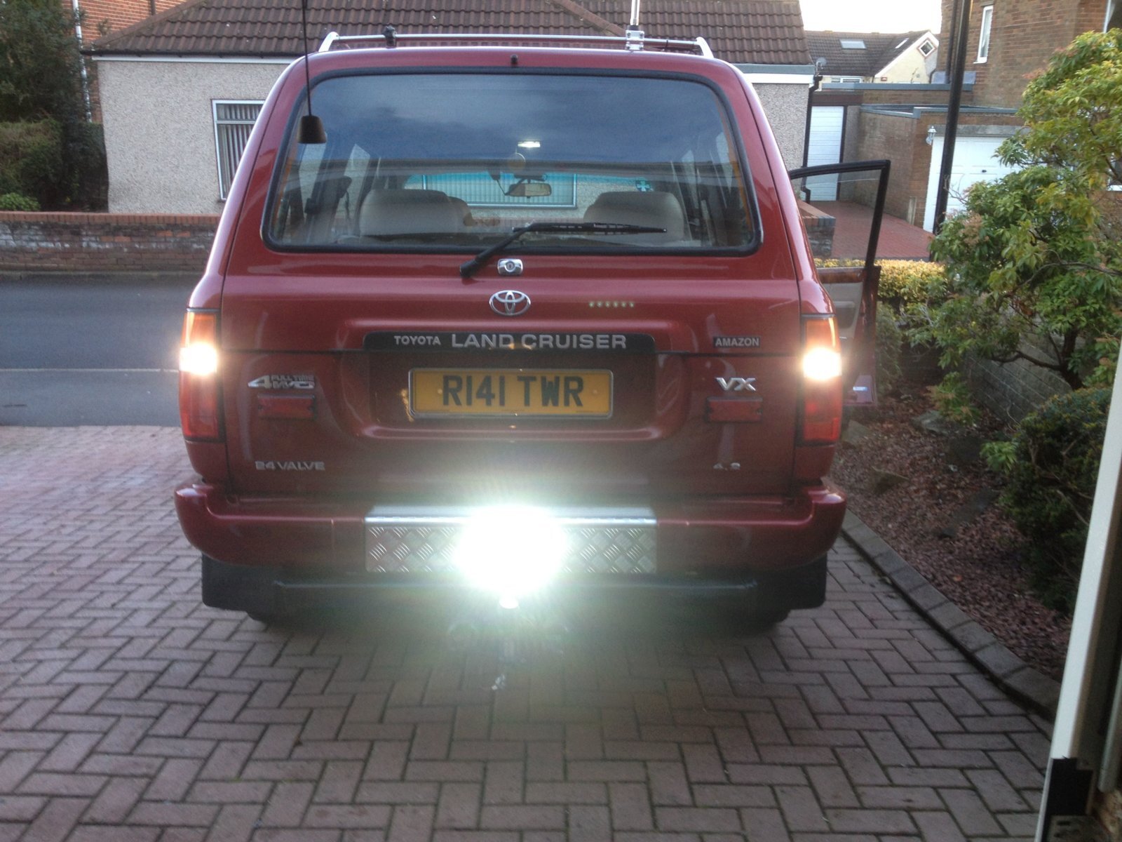

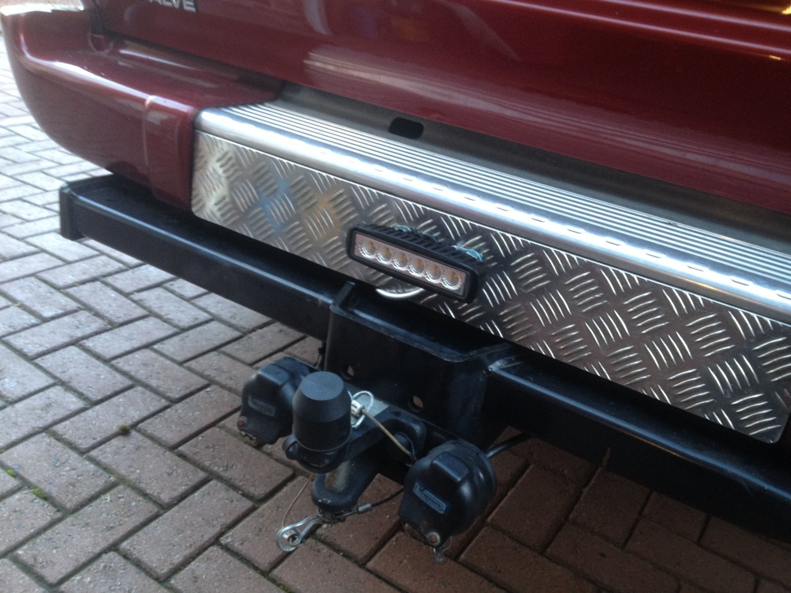

    Well, not really maintenance but after a small, erm.......'incident' involving the garage door, the tow ball and a reversing manoeuvre in heavy rain after dark I decided to fit an external reverse light. I had a small LED light bar lying round spare so thought I'd give it a try. Mounted it in the position shown as the 2 spare threaded holes in the bumper were handy and connecting up was easy, just took a feed from the tow socket. Admittedly it's a bit vulnerable down there especially when hooking up the caravan or a trailer but I didn't want one on the roof so we'll see how long it lasts. The OEM reversing lights already have LED bulbs in, much brighter than filament items but light with the new addition is way better.
