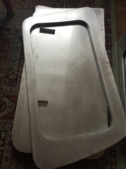

Small update, they are punched and ready for me to collect.
