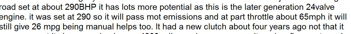

This is the bit that would worry me.
[attachment=0:24z834u3]290 bhp.jpg[/attachment:24z834u3]
290 BHP ? really?

On the BHP point, is it better to give the car a miss due to concerns over this statement?

a few things jump out at me.
i doubt youll get 80-90,000 miles out of mud terrain tyres? all terrains yep, just not sure on muds - happy to be corrected though
youll definitely notice a performance hit with 35 inch tyres over standard unless its had a re gear on the diffs
is 26 mpg realistic with 35s and such a big lift? might be im not too sure though.
15 inch wheels won't fit - they must be 16 inch to clear the discs and calipers. 15's were on the very first 80's only
290 bhp - nope. 190 i could understand - 290 would need some very serious mods to get near i would have thought, not just a pump tweak
it might be worth seeing just does not sound like he knows his cruisers and is "bigging it up" which it really does not need.
looks well in white.
need some serious turbo, pump and inter cooler work to get to 290 IMO. A trick some tuning places use is to put the brakes on during the run down so it seems like there is more drag in the rollers and then the software bumps the power run figure to compensate, or so I was told, so a print out may show silly numbers but be meaningless.
35s on a standard 80 series gets you about 15-18 depending on how i was driving. mine was an auto.
