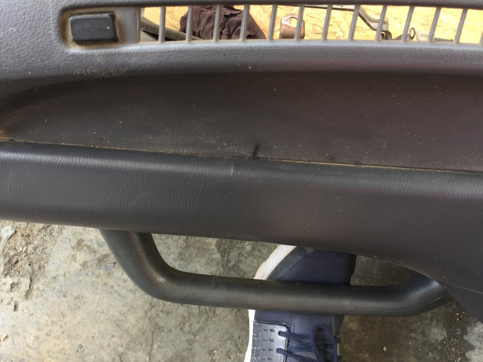

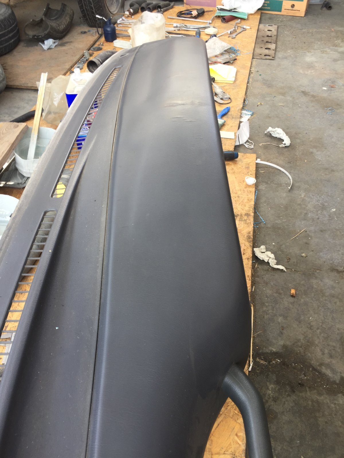

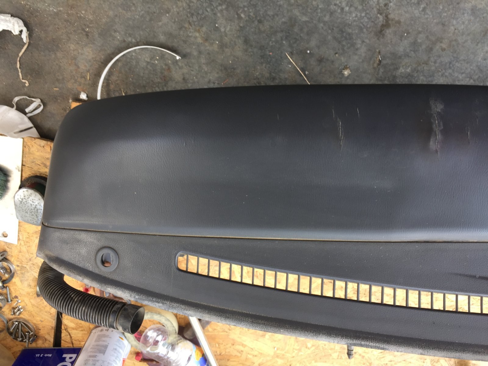

With the dash out & all this work started to look at a possible fix for the cracks. Funny how things look a lot worse when there out in proper view.

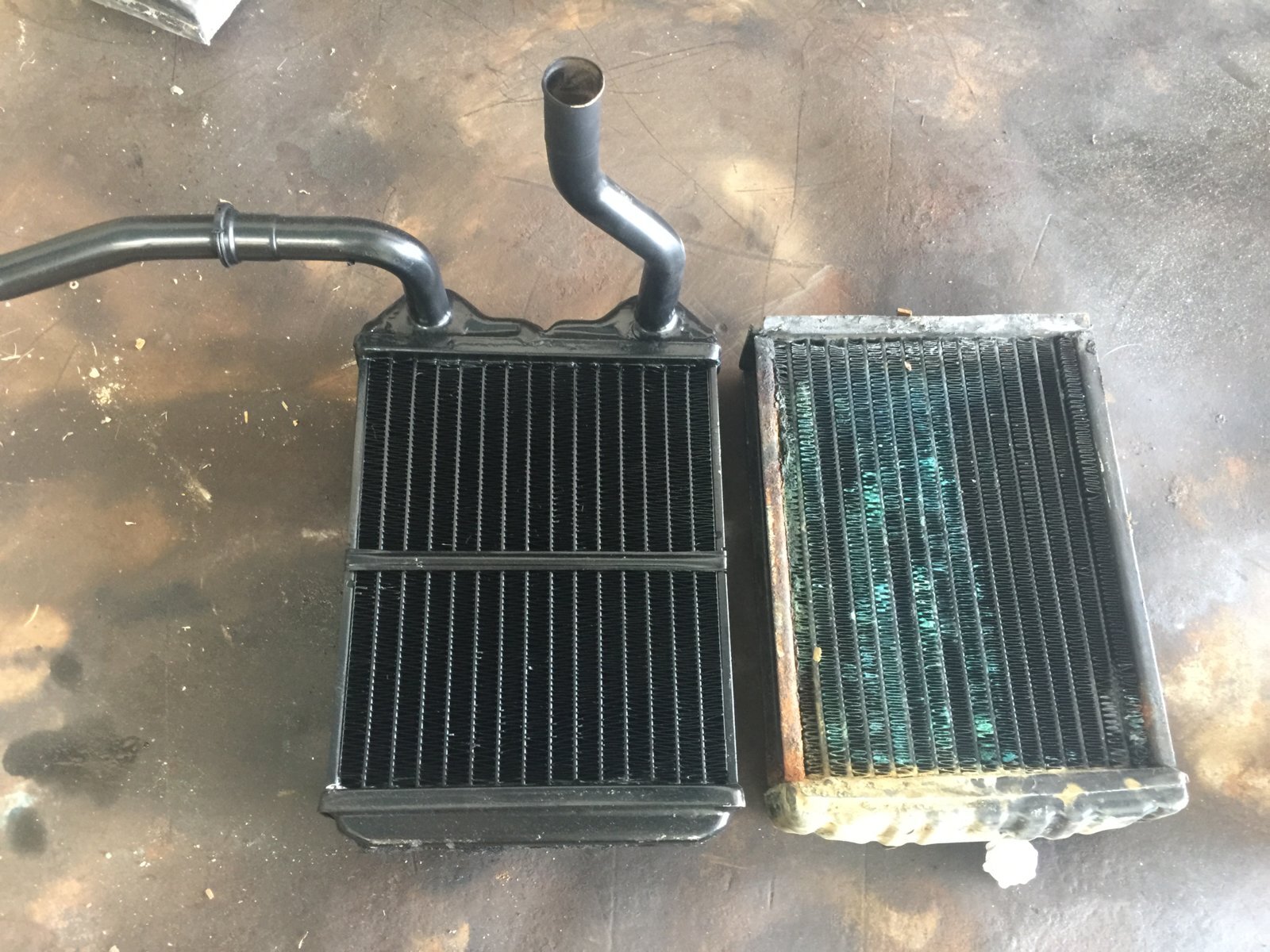

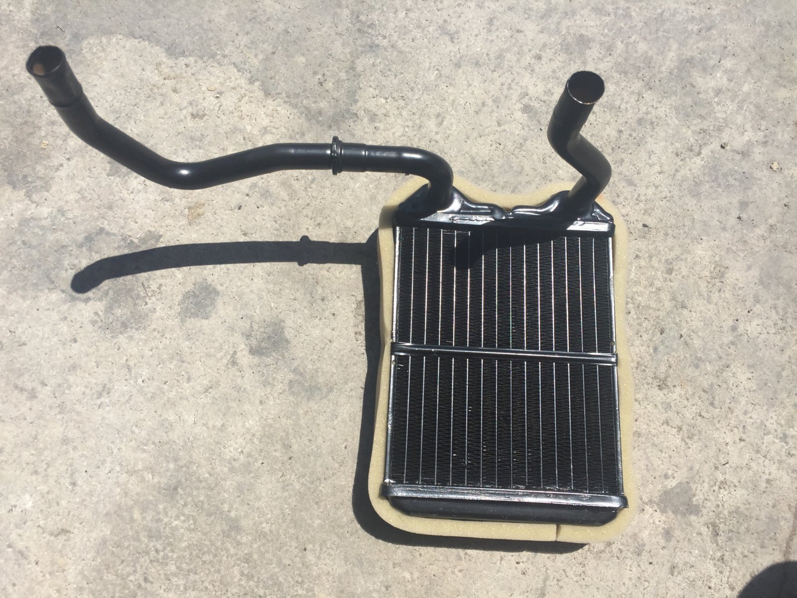

At least it is the heater matrix that's leaking, makes it all worthwhile.

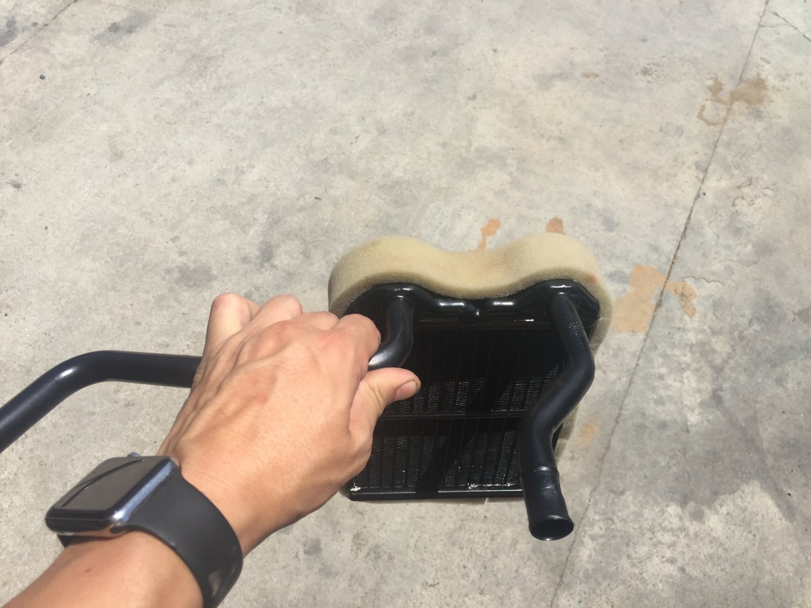

Good to hear you can get it re-cored so quickly. Good luck with it.
It's a pity about the dash cracks, as I'm not sure of any remedial solution for that.
Thank you Richard didn't get much done today but hopefully will get most of the car back together tomorrow. I haven't attempted putting the dash back yet.
No chance of a reasonably priced replacement Dervis, while its all out?
I tried to out source a dash from the uk Clive before but unfortunately the quotes I got were to pricy..... adding to the cost of shipping to & from the uk ran close to £400. So I'm thinking while it's out get a few quotes here to repair it. Works out far cheaper just down to the quality of the work that's the real issue.

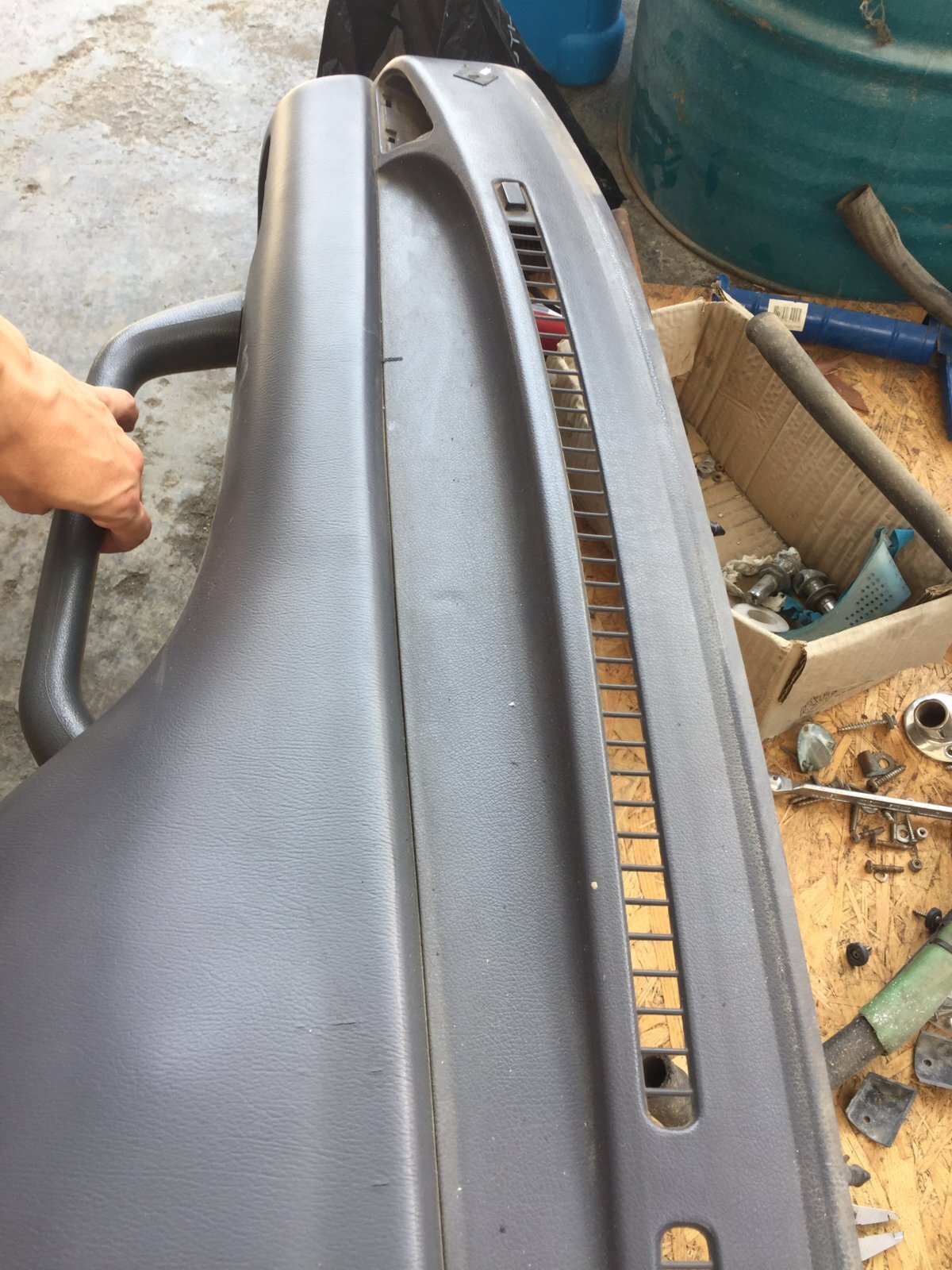

Also sent the dash of to have it retrimmed. Doesn't look too bad being good that's it's only a back section and not the air vents to do.

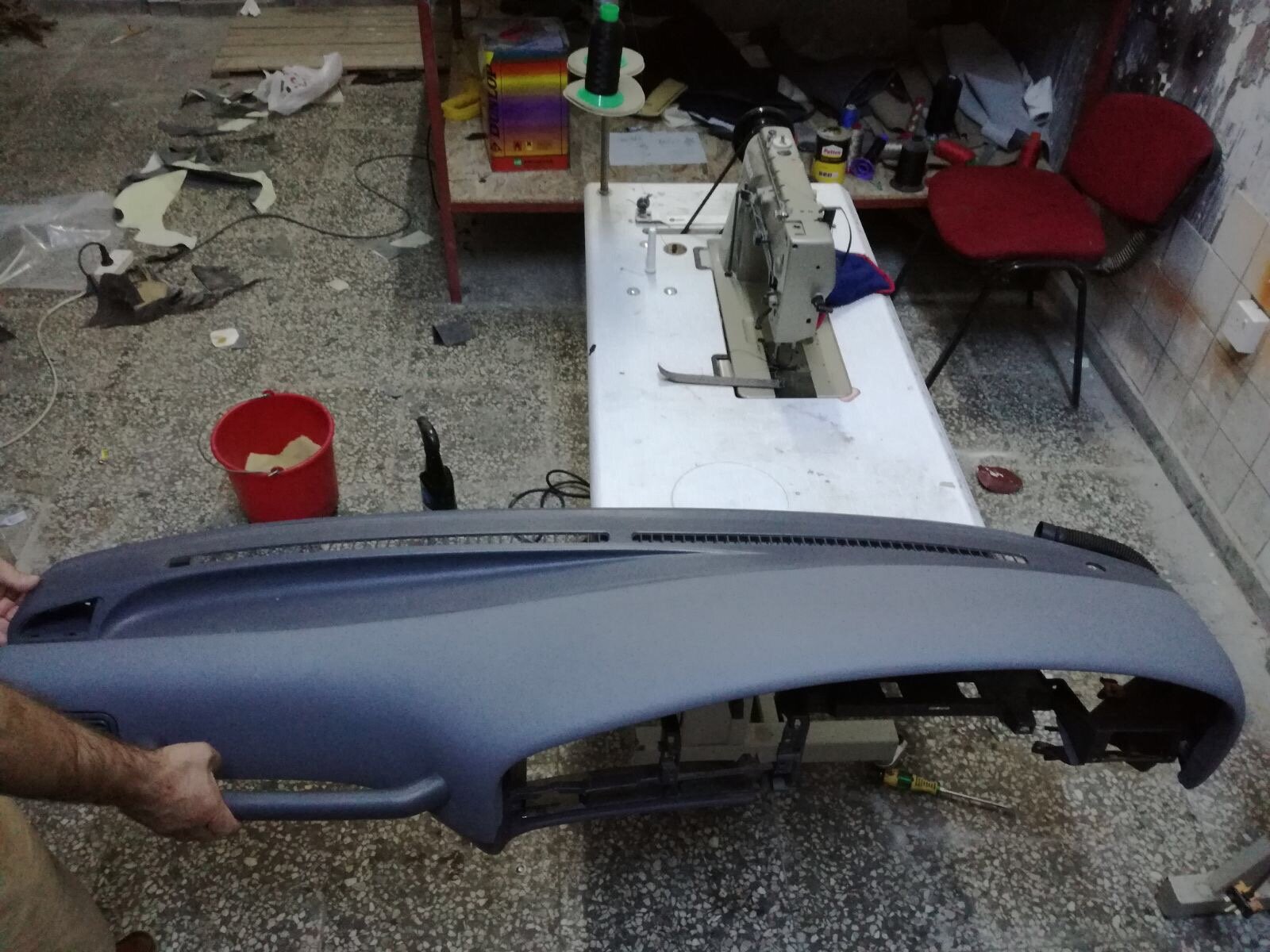

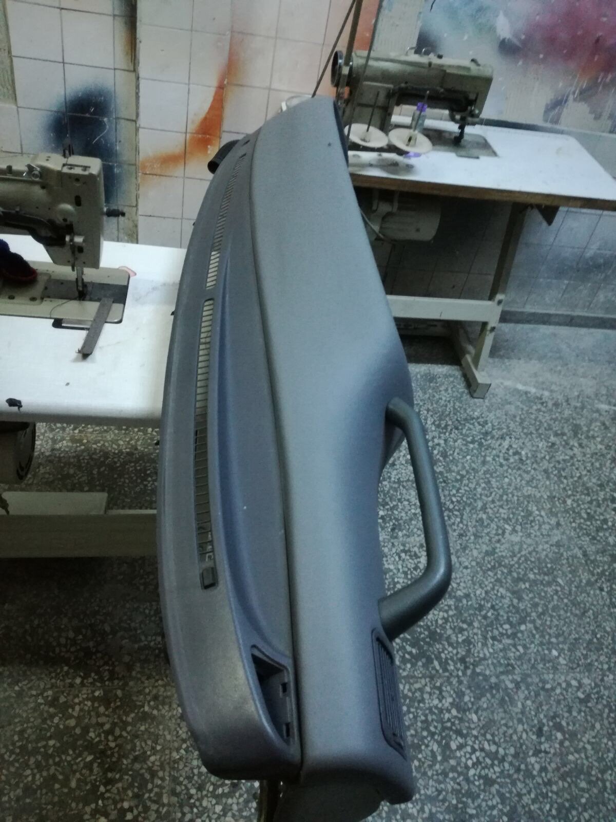

Guys today got the dash back they couldn't match the colour exactly which I knew so the nearest was this. They did a great job time will tell how it fits back and the final look in the cabin.
I've now got a two tone grey dash....lol

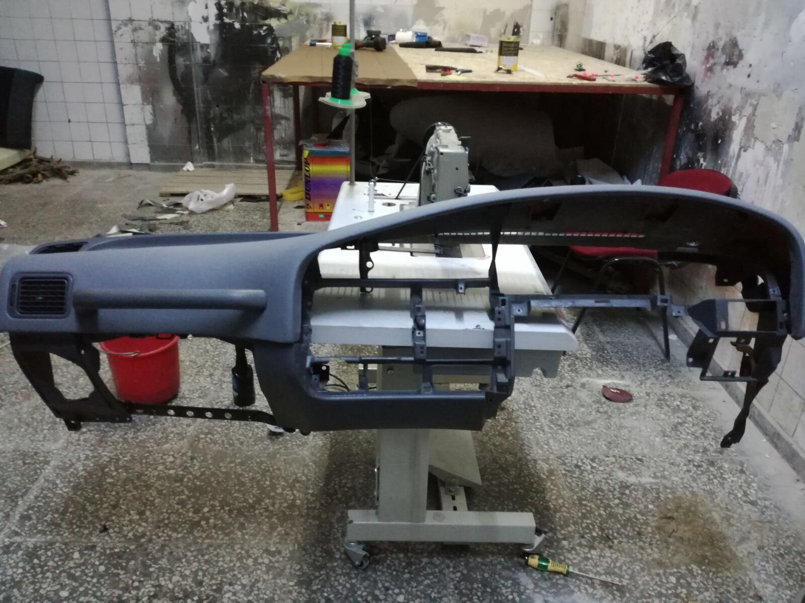

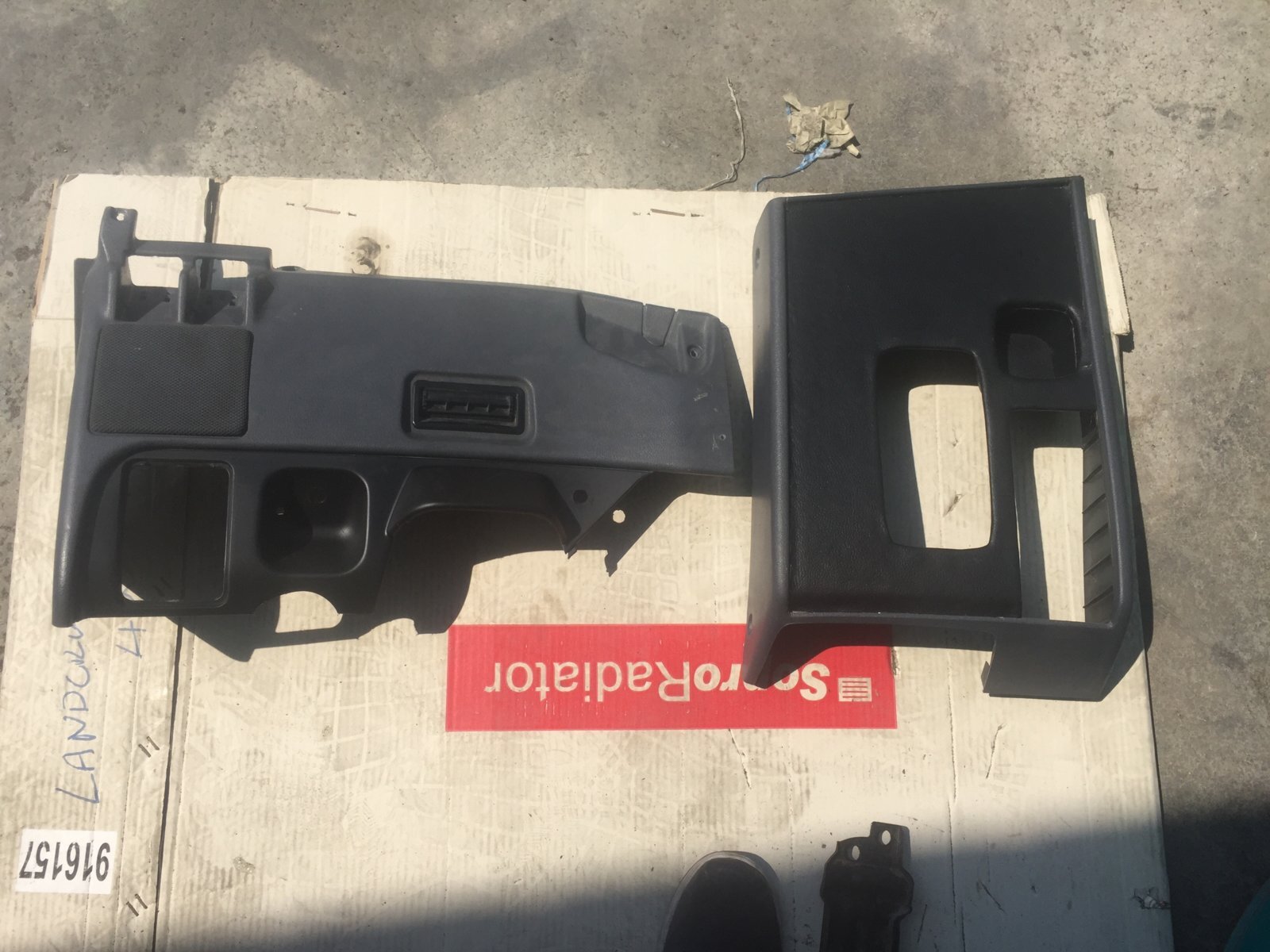

While the dash was being refurbished I took the opportunity to spray the bottom driver side lower dash matt black and also re-covered the center gearstick facia.
Now waiting the electrian to go through all the wiring before reassembling the dash back together.
Very nice too Dervis!
They seem to have made a good job of the dash, the coloured is something else, but I'm sure it will look good... :thumbup:
