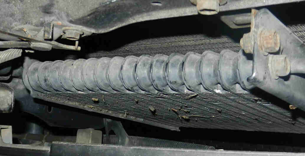

I noticed today there s a small rad in front of the engine rad, is this a standard fitting on a '96 petrol? and would that be for the gearbox ATF?
Yes, Chas - that looks like an ATF cooler :thumbup: And it is probably standard fitment - it looks just like the OEM ATF cooler I have waiting to be fitted one of these days :whistle:
Got one of those little rads in my one as well chas
Thanks Carl, that confirms it. I'm not used to petrols yet but learning :thumbup:
