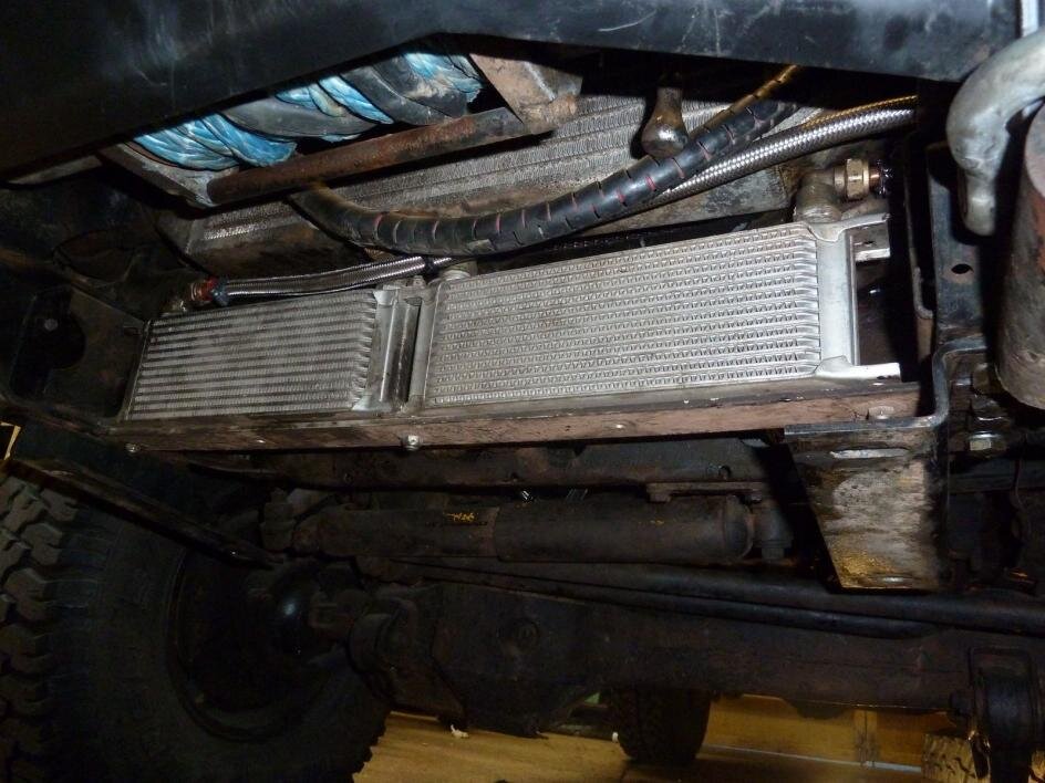

This is how mine are mounted between the chassis rails, the bash plate sits below the coolers.
I have since modified the pipe connections, this was a 'before' pic & I have done about 30000ks in North Africa with no probs
