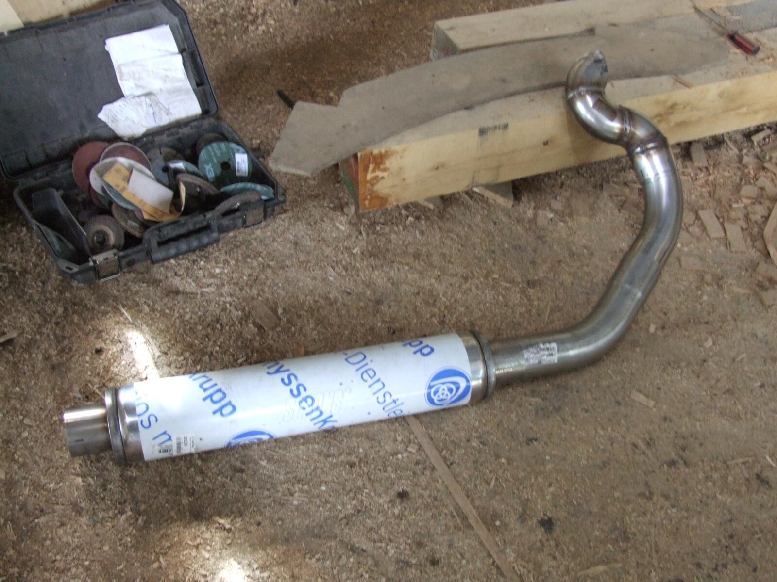

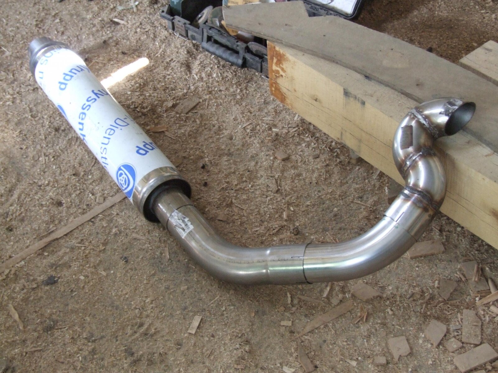

Back in 2009 I made a stainless steel 3" side exit exhaust. 3" dump pipe straight off the turbo and made a flange too.
This is part of it a few years later on. When the 4runner engine died from too much boost and over fueling! It did fly and did over 110mph!! It's from a toyota granvia.
You can see the new turbo flange and the 3" pipework. Also there's a egt probe tapped in pre turbo, to prevent what happened to the previous engine.
You can get all the 3" stainless exhaust components from Demon Tweeks and they are Jetex brand. You could probably get away without the silencer to save a few dollar. But for a bit more noise!
It was quite easy to put together, but needed a bit of modification after after a few 1000 miles.
