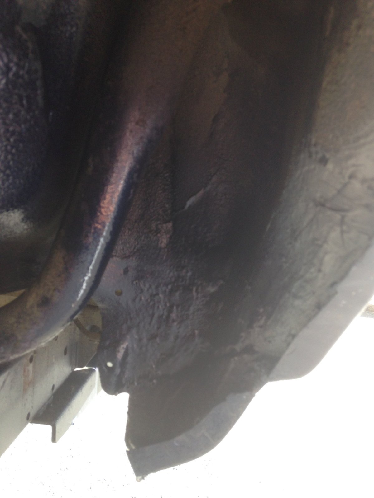

    So, after having it re-sprayed 3 years ago, I now noticed that the lower rear quarters were really rusty, meaning non existent. Off to the body shop we go, and this is the result...
    On the drivers side (yep, it's a left hooker) the tin worm had ventured up into the rear curve of the arch...
    Newly made 1mm thick panels all painted nice and shiny, waxed on the inside, so they might last as long as I do, hopefully.
    Had some pesky dents in the front wing too, kids chucked a rock at it, all pulled out and repainted....
    And, a year or so ago, I went over a log that up-ended and punched a big dent upwards into the outer sill, so that was pulled out nicely and painted too.
    Front and rear repairs inside the rear arches...
    It's not finished yet, the arch cap pings need replacing when the new clips arrive and all that shiny blue will be re-wrapped in cling-film on steroids.
    It's great stuff for scratchy lanes and tracks which I do most weekends, but mighty expensive. Still, the paintwork under it is as new as it was when done 3 years after.

    Thanks guys, he's done a fine job and the price was right. He spent a day and a half on each rear quarter.
    He also fitted Chas' old side sliding window frames using new (still in the sealed packs) rubbers I was lucky to get from Dervis (indigo spirit) at a good price. My frames were damaged and the old rubbers were perished and slit open.
