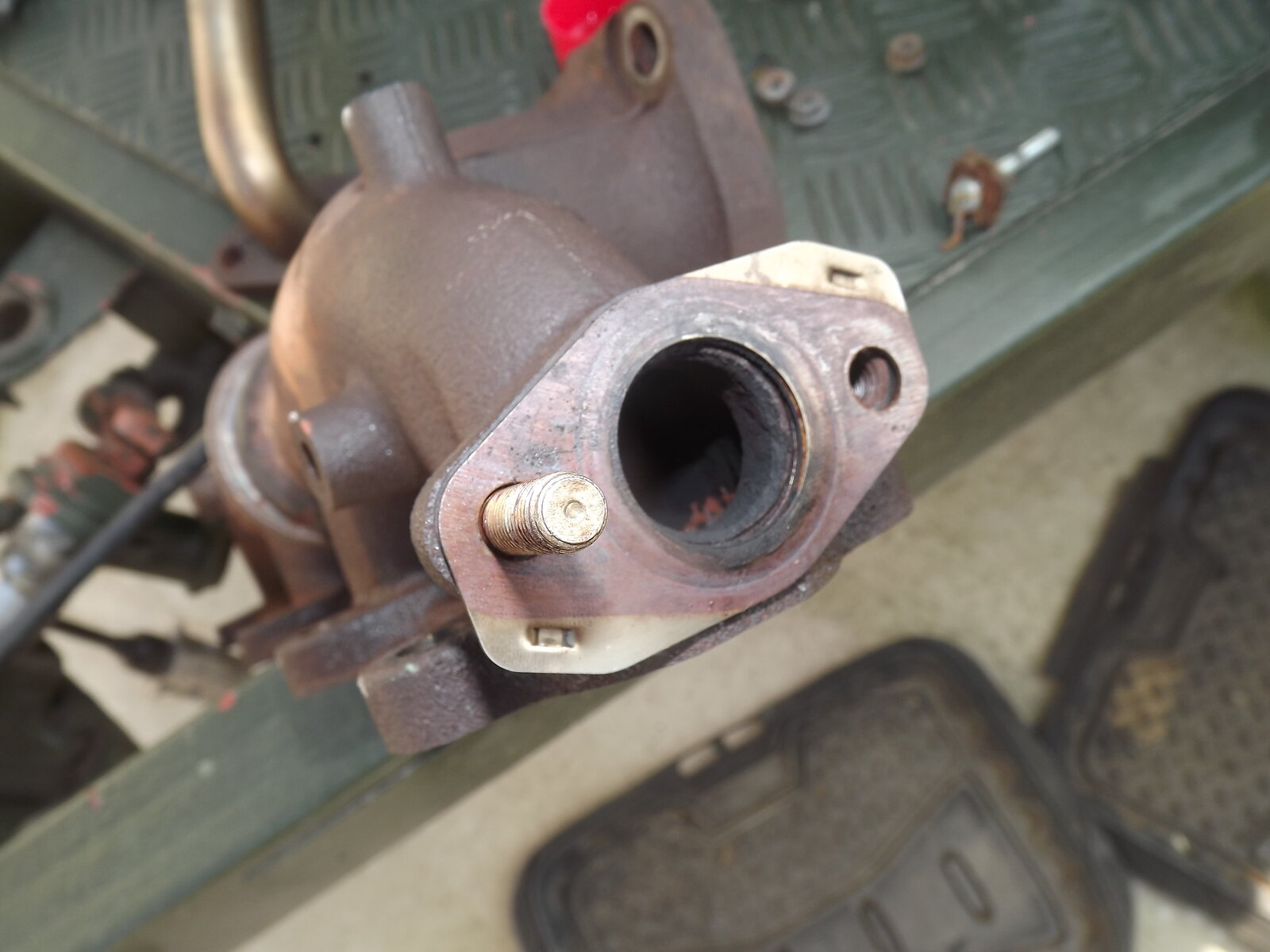

Reverting to page 3 of this thread when EGR removal/blanking was being discussed I gave up trying to undo the egr takeoff on the 16/09/2013 believing it already had a blanking plate in there .
Here is the offending nut which required an E18 metrinch socket lots of penetrating oil and some considerable force to crack even with the manifold removed .
And here is the ill fitting gasket that i assumed must be a blanking plate because who makes a gasket that doesn't fit ... especially as there are 2 of them ?
So i am embarrassed to admit that it looks like i have had an active egr all along which may explain why my intake was always dirtier than i felt it should be , black oil is probably unburnt fuel mixed with dirty exhaust . Nevermind might save someone else buying a turbo they don't need in search of an answer :|
That would definitely explain the build up of carbon on the turbo. Hopefully she'll run better with it blanked now, plus it should also help lower temps a little! :icon-biggrin:
