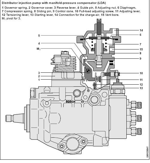

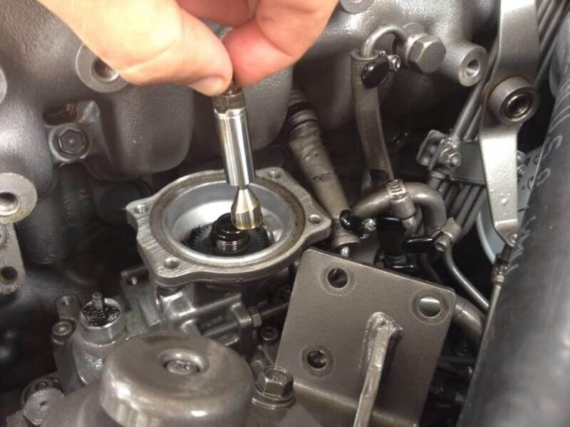

Depends how it calculates i guess :think: would i be right in thinking the boost compensator diaphragm on the manual pumps is little more than an on/off switch ?
If so the obvious improvement while moving into the digital age would be to swap on/off arrangement to a progressive increase in fuel volume during boost thus saving fuel and giving a cleaner burn (more power)
Remember this is a secondary function so fuel volume increases with engine speed regardless of boost .
