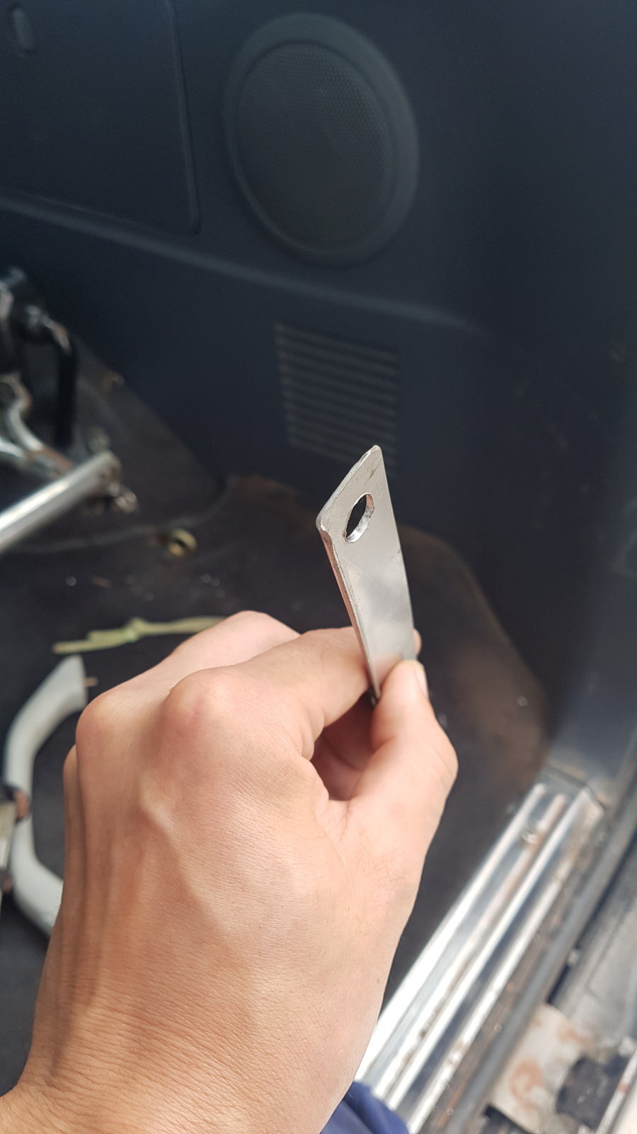

Did some work on the frame for the rear kitchen, I will have to re do some of the brackets though as it doesn't sit flat.
