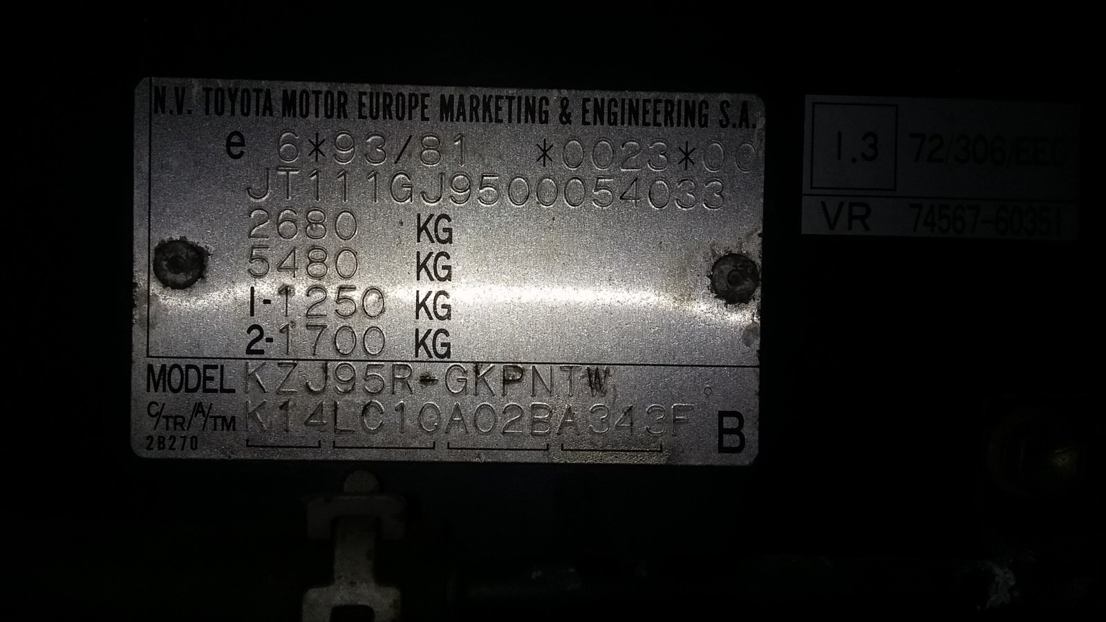

    I thought that the drivetrains, including auto gearboxes were the same for both the 3.0TD and 3.4v6 petrol on the Collies.
    Can't remember the exact number but something like A442f on both?
    Maybe I'm mistaken - won't be the first time! :shifty:
    EDIT : Just been out to look at mine - according to the VIN plate my gearbox is the "A343F"

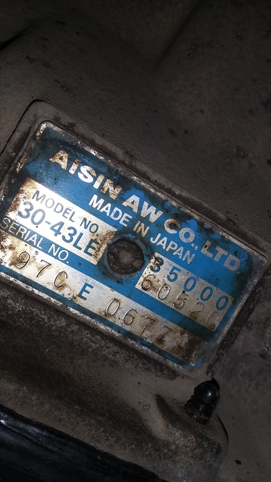

    Here's the plate on my gearbox a 30-43LE.

    Have a look in the engine bay - the build/VIN plate is on the bulkhead to the right of the brake master cylinder. The last few characters of the bottom row contains the gearbox code. Sorry I don't have a pic! :doh:

    Just looked your right a 343f wonder why it says 30-43le on the actual box???
