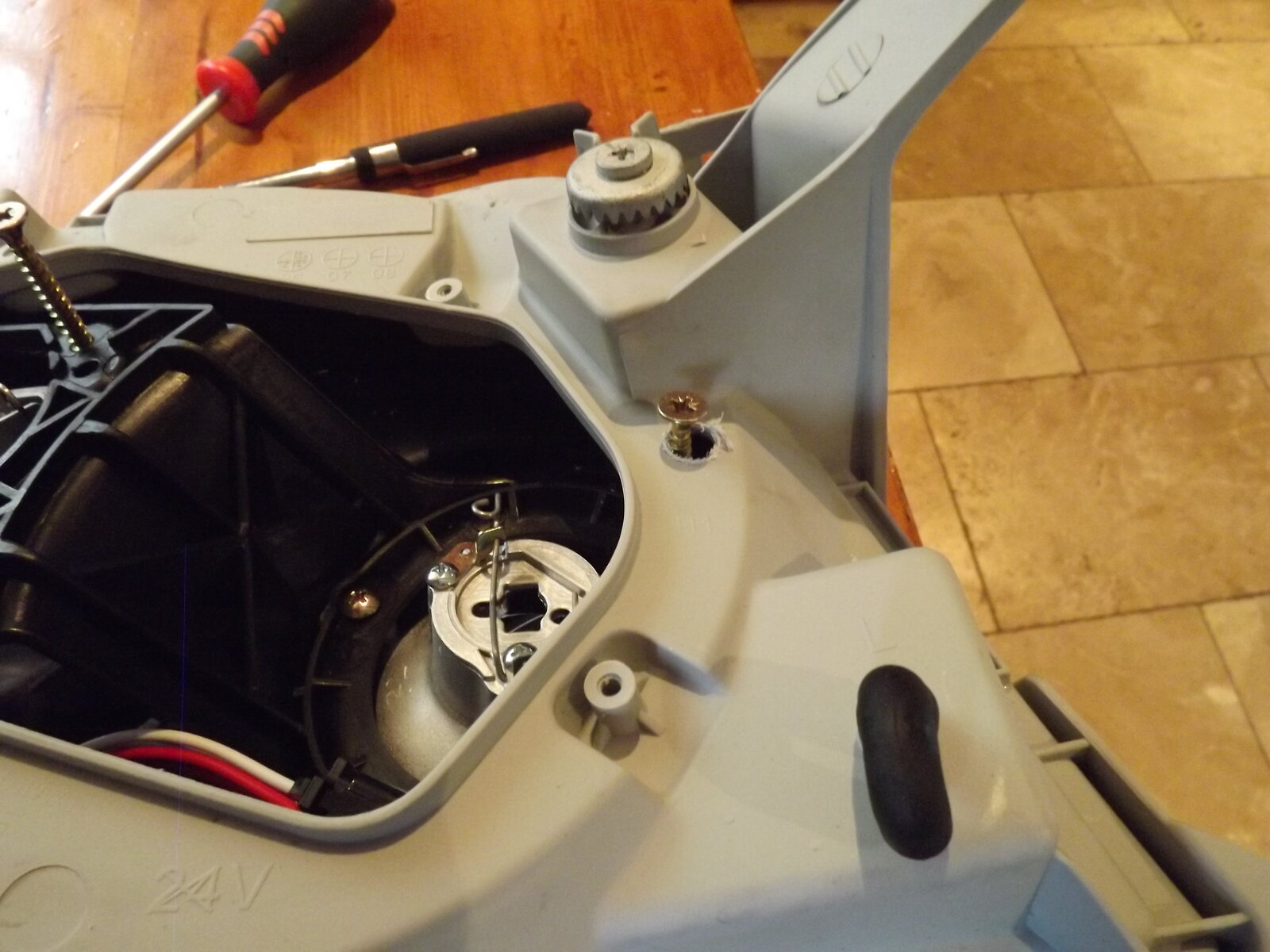

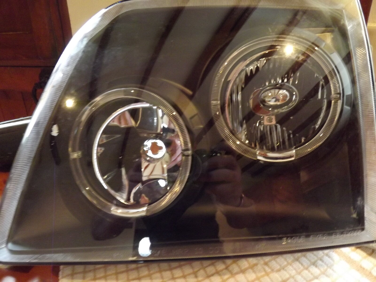

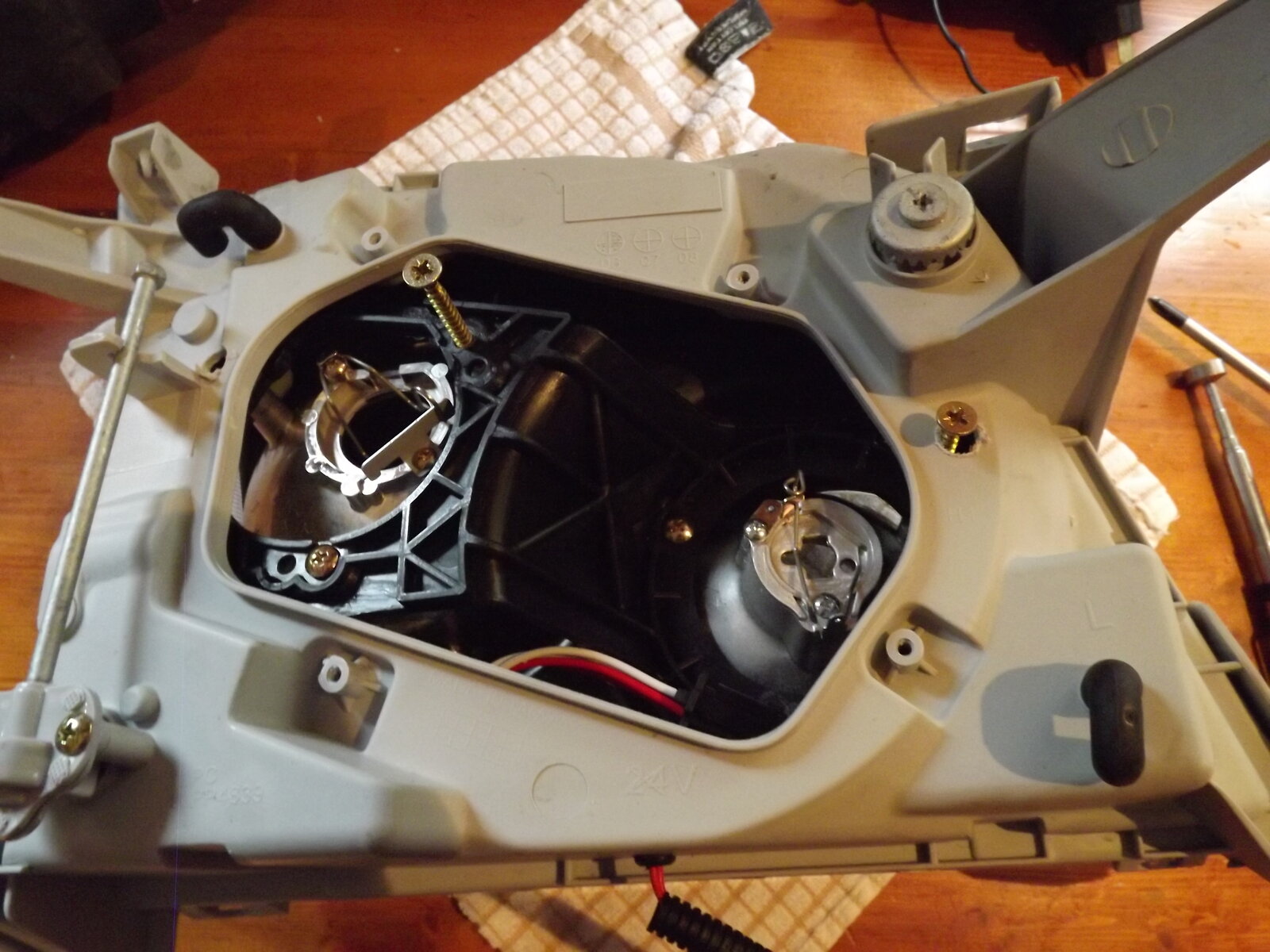

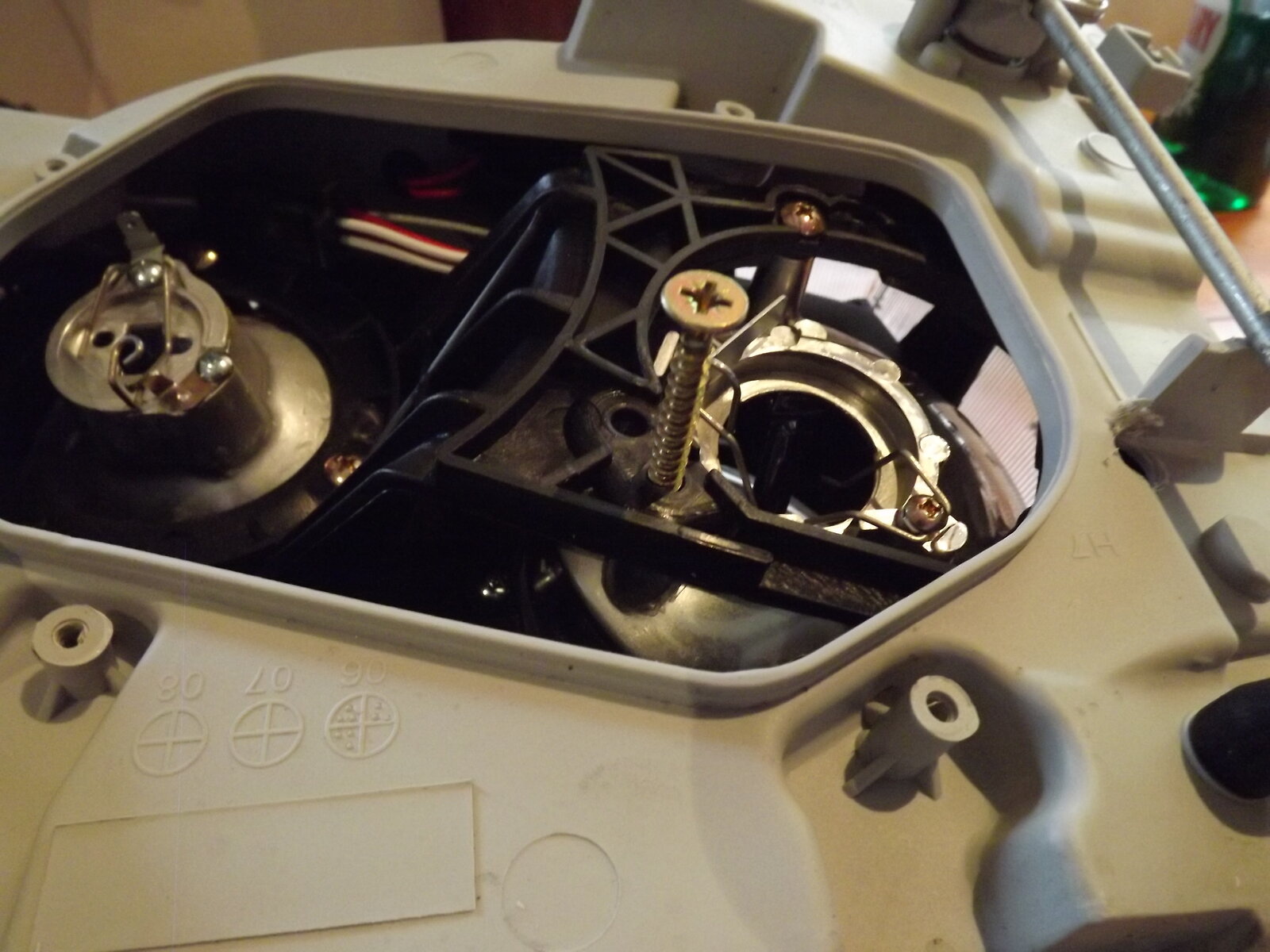

Some pics to take the guessing out of converting Prado 90 , Landcruiser Colorado , KZJ Landcruiser angel eye headlights from LHD to RHD .
Angel eyes LHD to RHD 001.JPGAngel eyes LHD to RHD 002.JPGAngel eyes LHD to RHD 003.JPGAngel eyes LHD to RHD 004.JPG
3 screws hold each reflector in , loosen them all (which will require drilling a couple of holes just to get at the screw) insert a bigger screw (i have used very large wood screws for pic purposes) to give the reflector something to push against while you tighten the other 2 screws to make it solid .
A child could do it the pita is you have to replace the light to see where the beam is aiming and if your not happy remove it to alter the screws . The factory adjusting screws will still work for fine tuning .

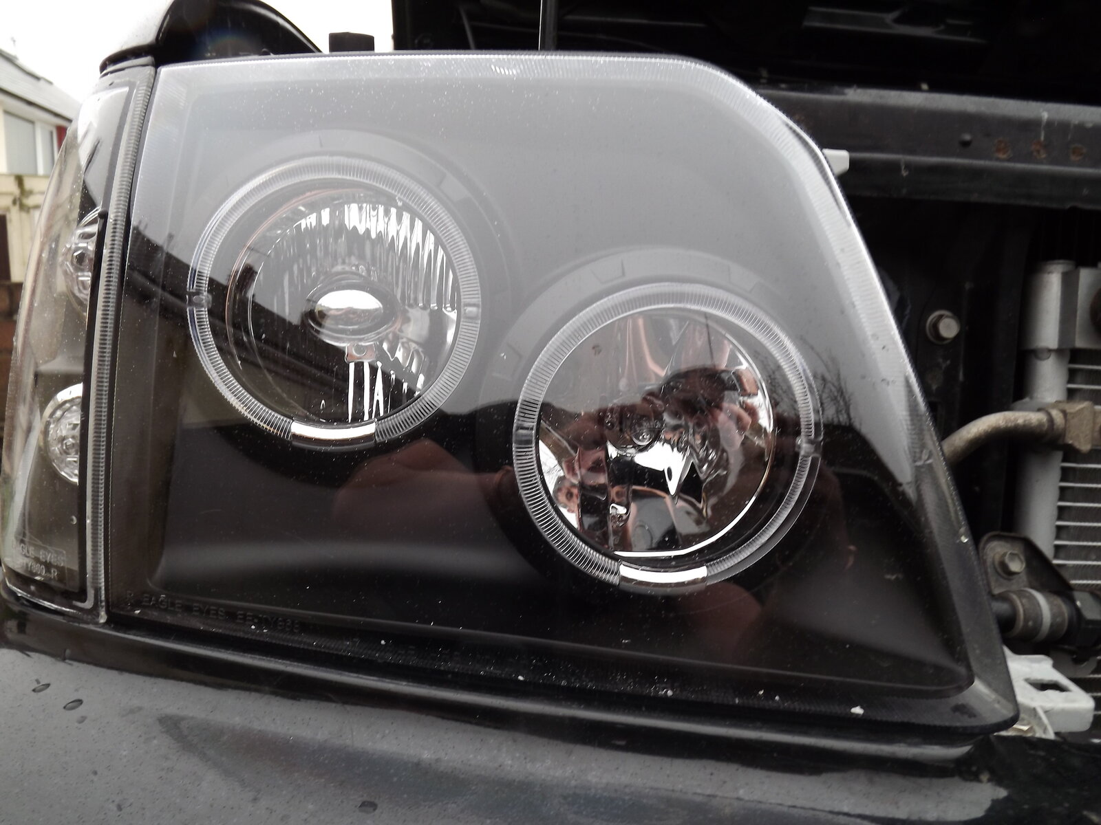

The pics show the max adjustment that can be had with this mod and with factory adjusters set as far to the left as possible for pic purposes , the pic below is i hope very close to the end result .
