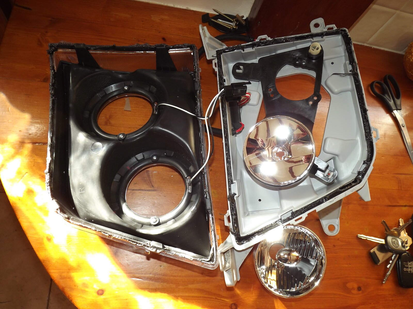

Thinking about this, is it not possible to get the tilt to the left by fitting some washers under the reflector mounting screws as well as blacking out the kick up bits?
I can get the beam left without doing anything fancy but the kick still illuminates the windscreen of oncoming traffic .
I'm making a meal of it as it offers a welcome distraction that can just be thrown to one side when the next unscheduled visit or task presents itself as seems to be the way of things lately . They can only end up better than they would have been as plug and play so its no loss really .
