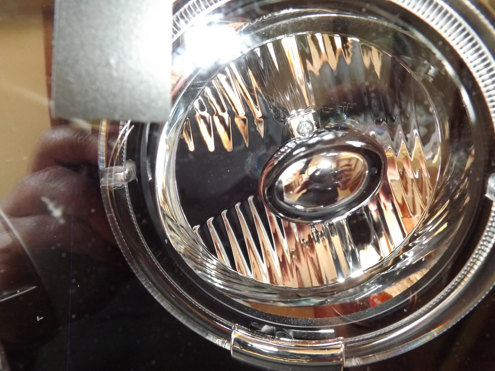

Yeah direction is not a problem but the dip reflector has a kick high right molded into it and no matter how i rotate the reflector the kick remains throwing light where it shouldn't be . It's a bloody nuisance because i can set the light so it annoys nobody .
This borrowed pic explains it better

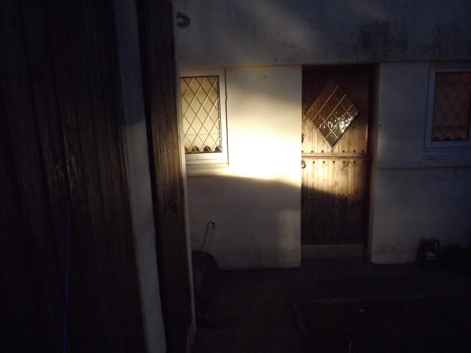

There is enough adjustment to direct beam to the left away from oncoming traffic , its the kick up which is caused by the reflector that is the problem .
See this pic
if the reflector was uniform in pattern giving only a horizontal line on that garage door i wouldn't have a problem .

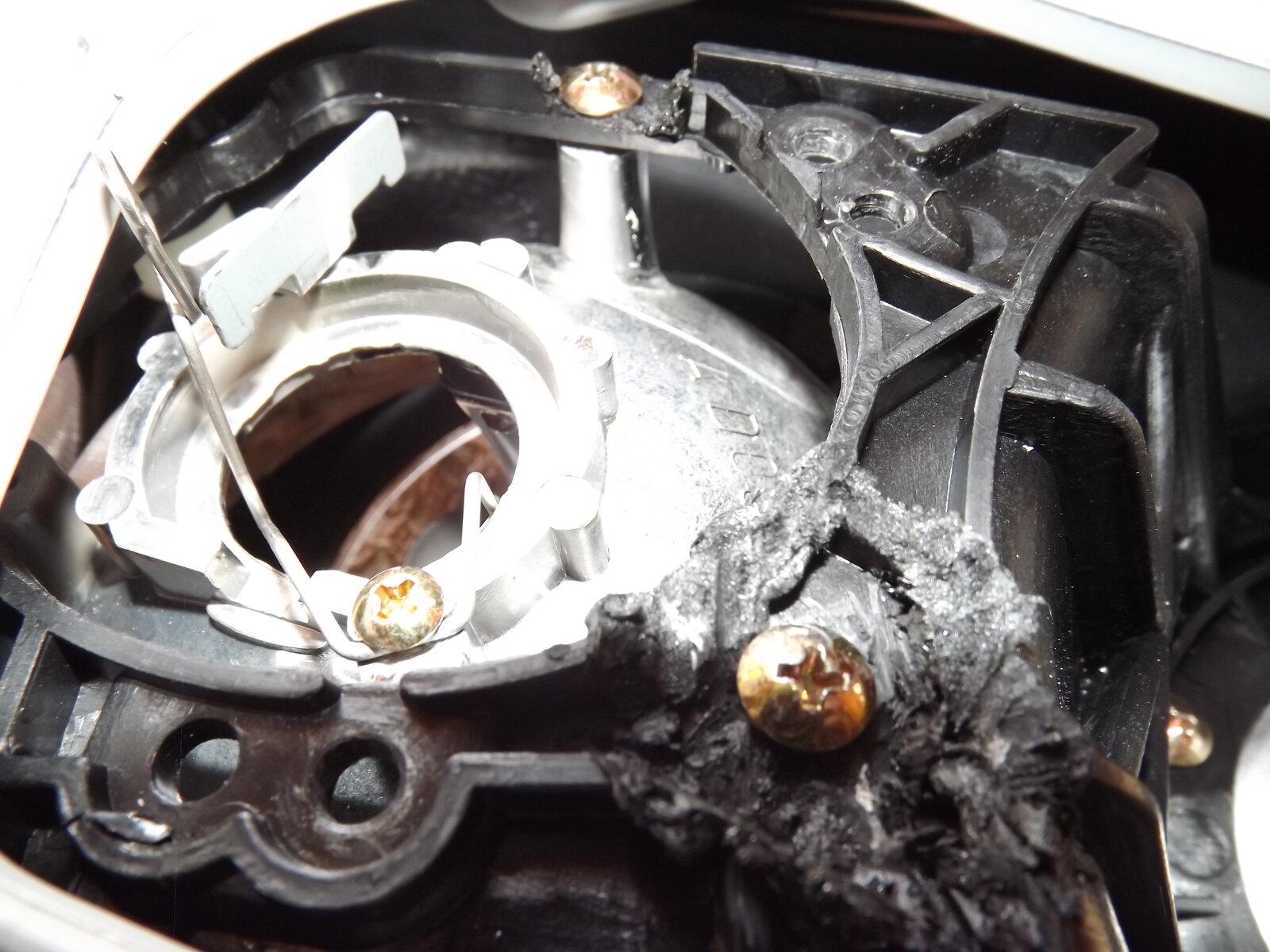

In an ideal world i could just turn the reflector 180 which would i think cause the kick to rise left as it should but the mounting points don't allow this . I have just got home and will have another go at them i reckon the odds are no better than 50/50 the lights will survive being in the oven and splitting so what have i got to lose by drilling some new mounting holes .

This is where i think the smooth part kick up of the reflector should be if it shows in pic ?
Rotate LHD to RHD 001.JPG this is the passenger side light .
I got it there by doing a bit of butchering with a hot knife
