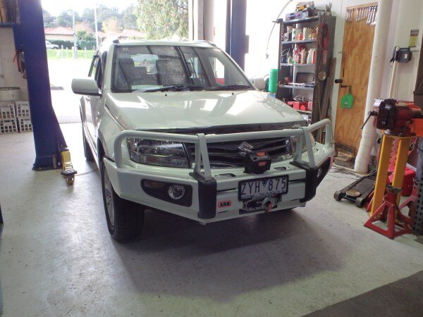

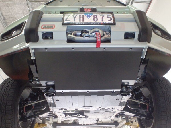

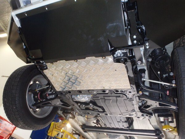

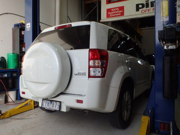

We had a brand new Suzuki in this week that we had to fit a load of bits to.
It had gone to ARB first to have a bullbar and winch fitted.

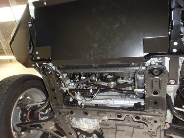

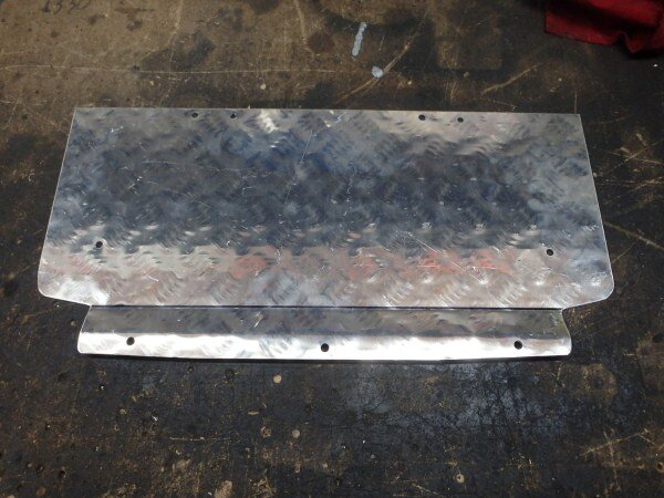

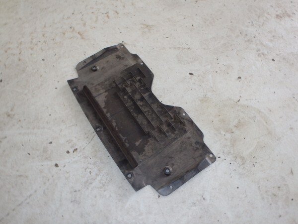

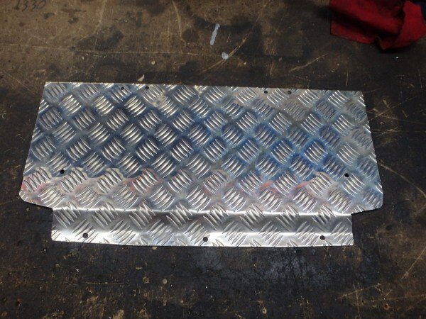

I had to make a bash guard to replace the factory plastic one.

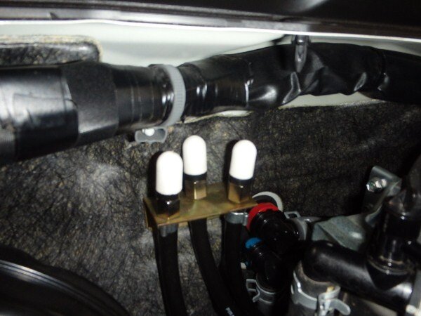

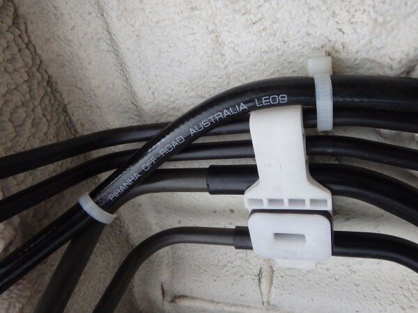

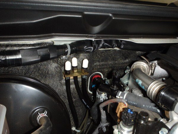

I also fitted diff and GB/TB breathers.

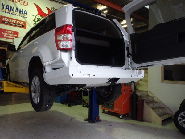

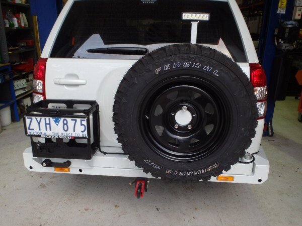

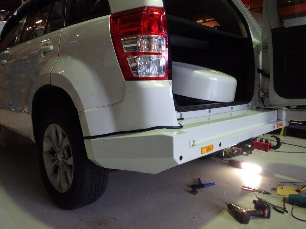

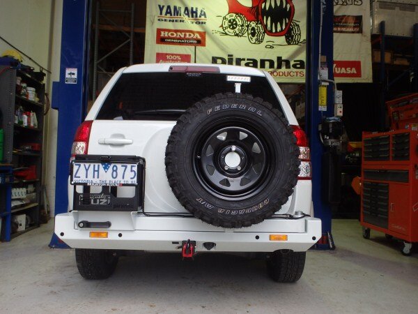

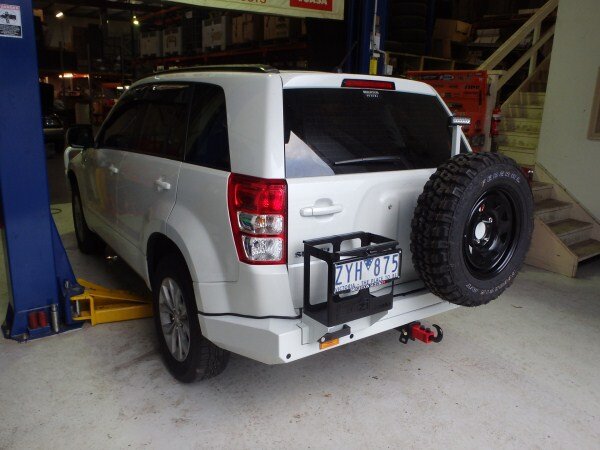

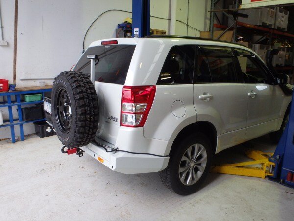

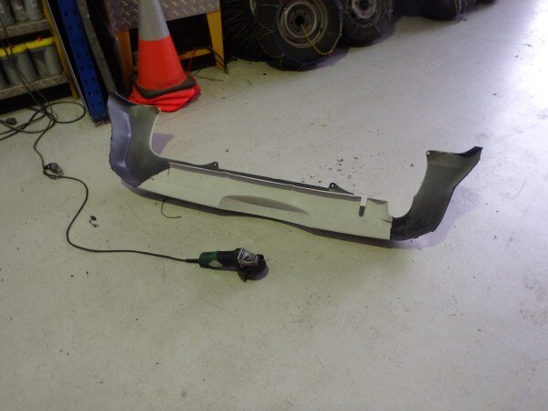

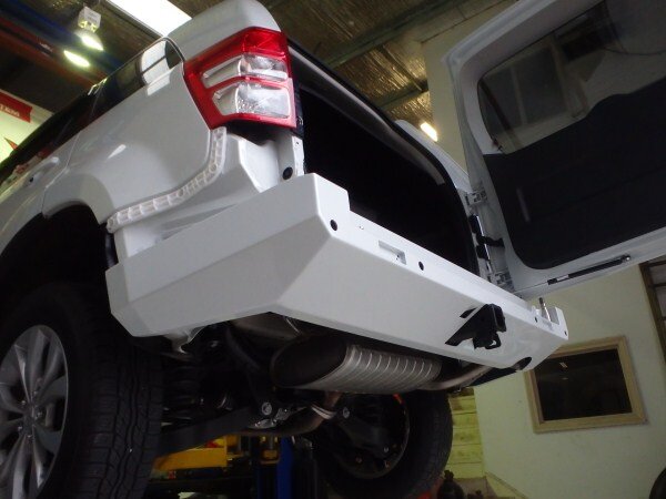

We fitted one of our rear bumpers.
Trimmed the corners off the standard bar.

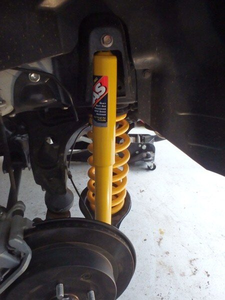

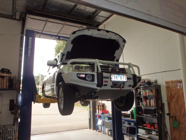

I had to fit a suspension lift next.
The rear was easy.

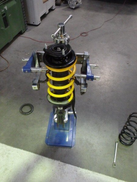

But the front was coil overs so needed the spring compressor.

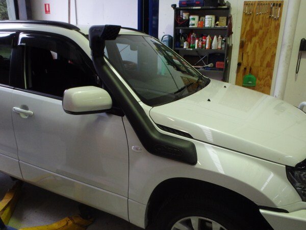

We fitted a snorkel.

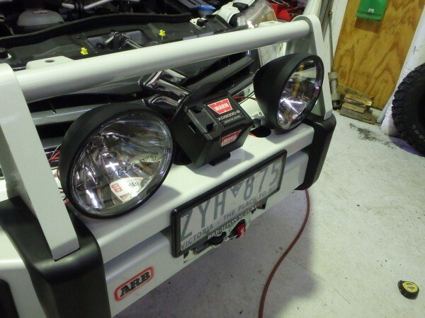

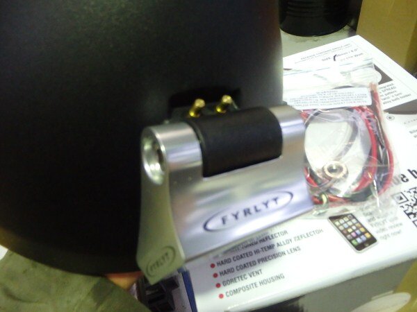

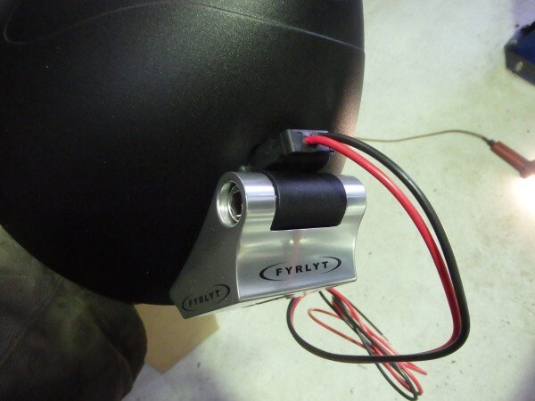

I fitted some lights.
I've not seen these before but I like them!
Aussie made and they have a nice mounting point made from billet alluminium. I also like how the wires/connector just plugs into the back.

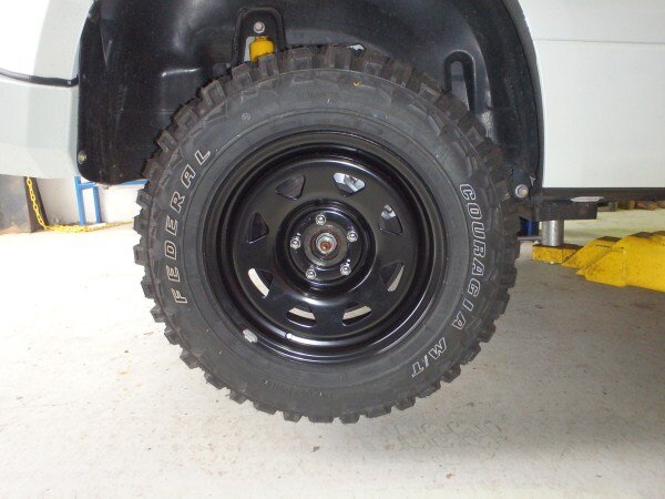

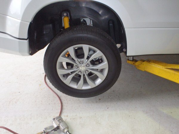

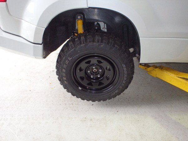

My last job was to change the wheels and tyres.

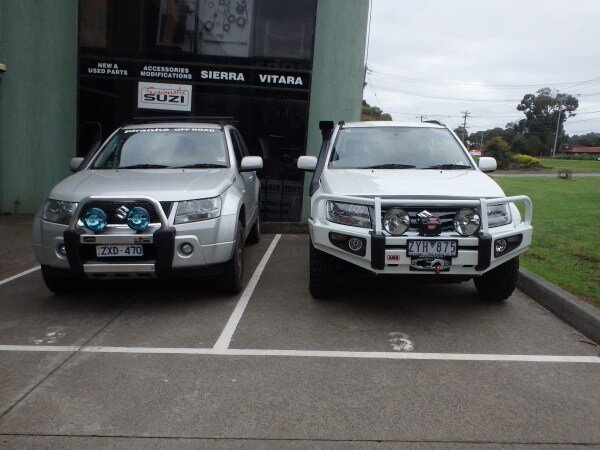

All done.
Parked next to ours for comparison.

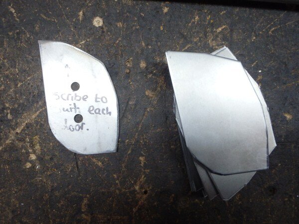

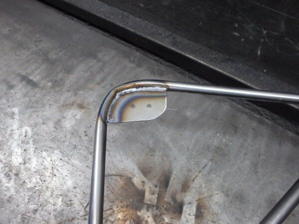

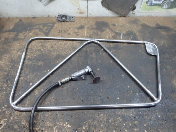

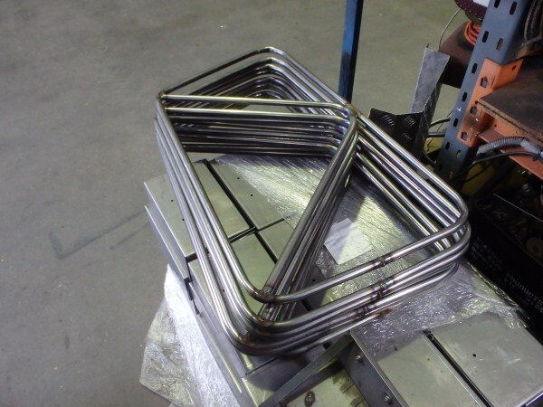

I got the Suzuki tube doors finished.

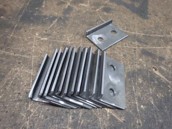

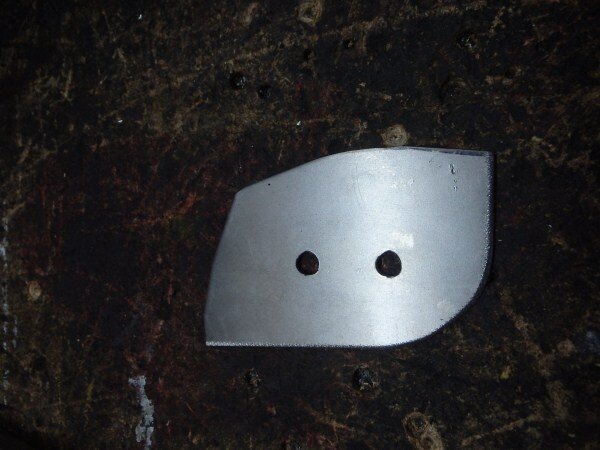

Cut a load of latch mounting plates.
Drilled them.
And welded them in place.

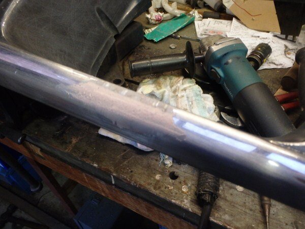

The last job before they were ready for powder coating was to smooth all the welds down and remove any splatter.
I also made the receiver plates for the latches and sent them for electro plating.

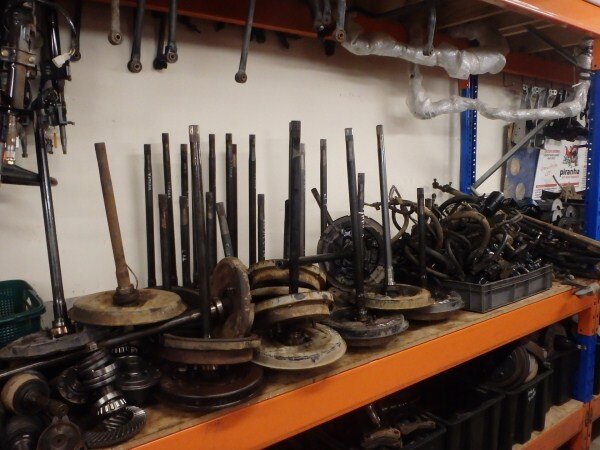

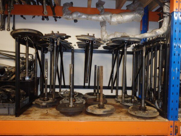

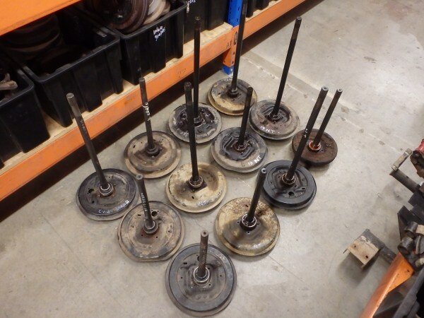

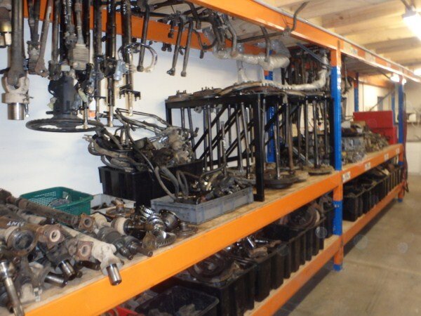

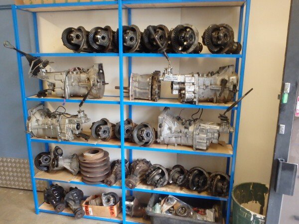

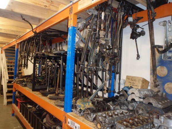

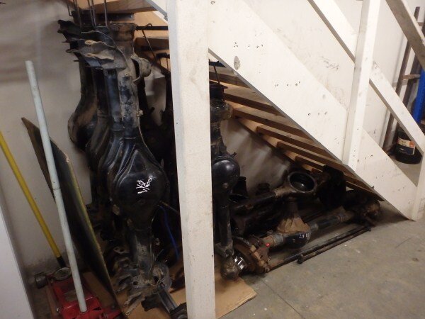

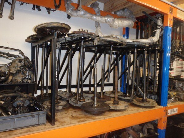

We stripped the diffs and half shafts out of all the Suzuki axles we had as their the bits that sell. I hung most of the old casings up.
And put all the diffs on shelves.

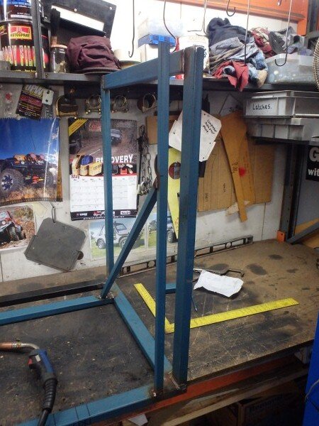

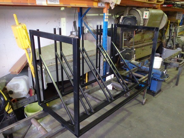

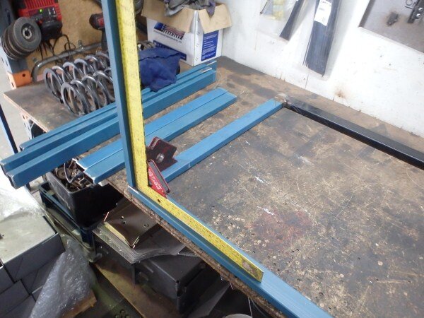

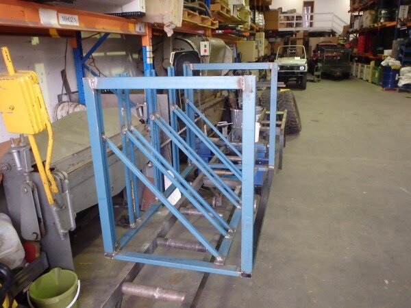

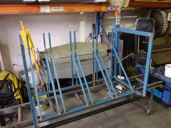

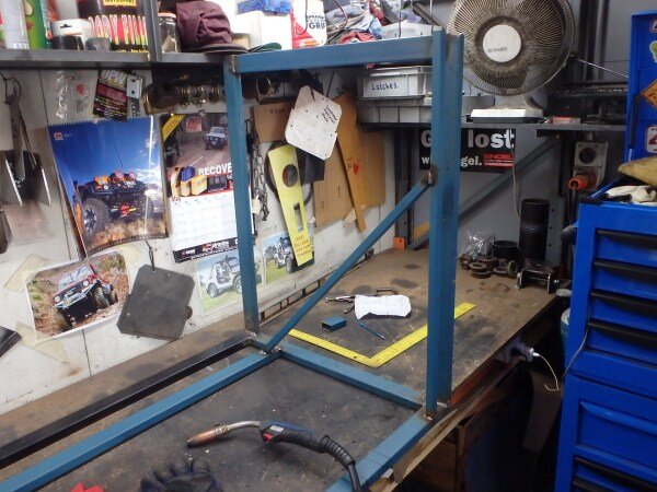

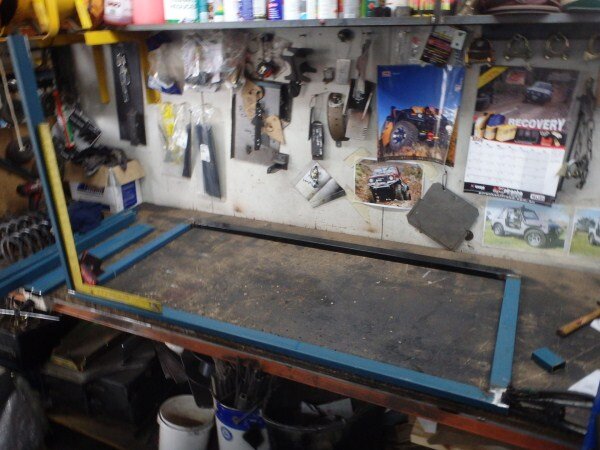

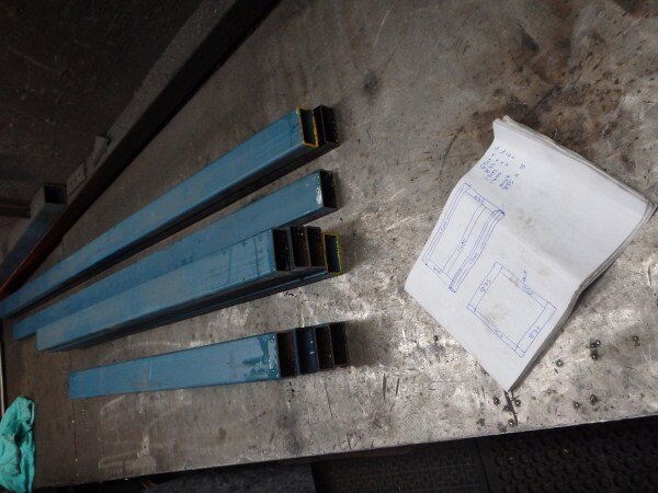

We decided to build a rack to store all the half shafts (or axles as they call them down here.)

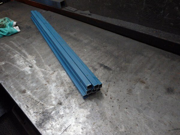

I cut a load of steel.
And stuck it all together.
Cut more steel.
Painted it.
And fitted it.

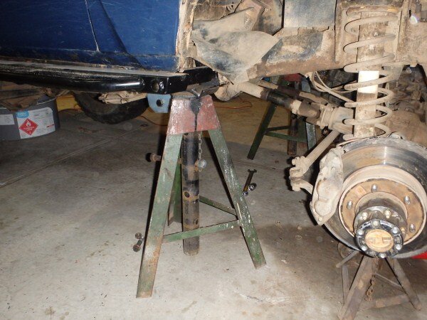

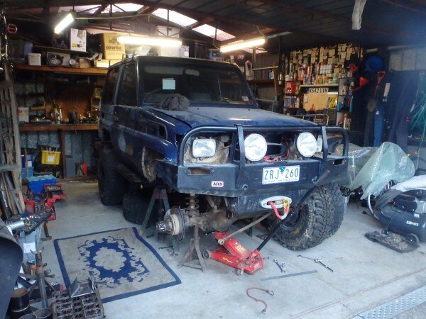

I got LJ safely supported on my big axle stands.

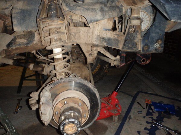

I decided I wasnt happy with the angle the springs and shocks were at after moving the axle 50mm further forward, it didnt look too bad before but with the wheel removed it was now more noticeable.
The springs and shocks desperately needed changing anyway.

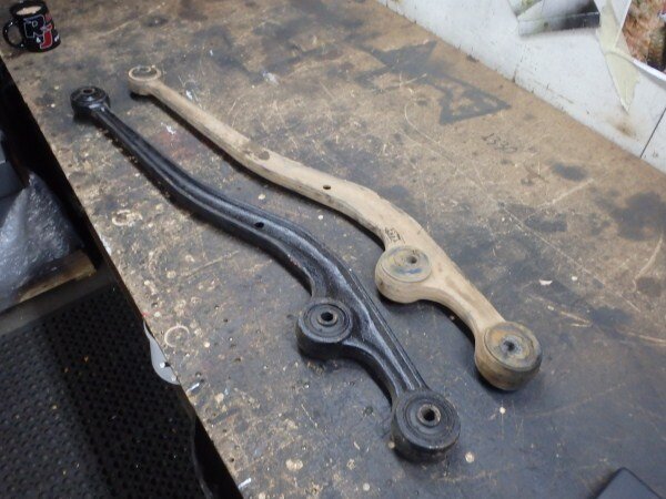

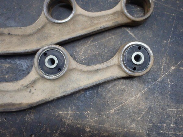

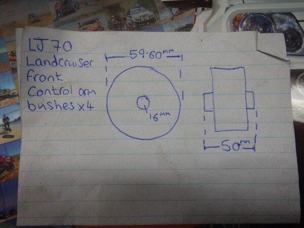

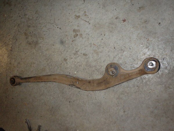

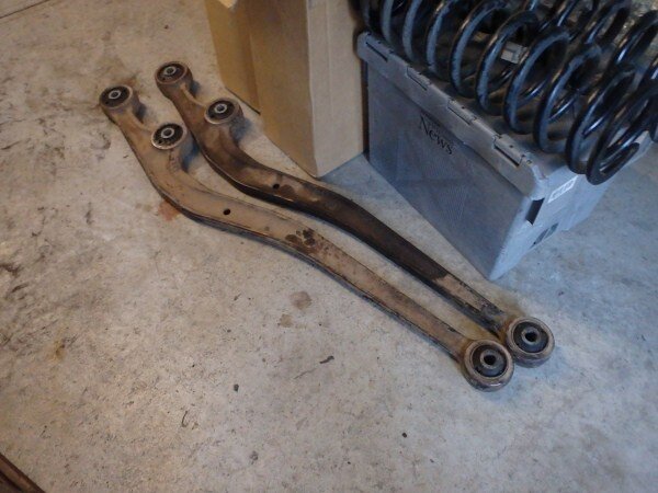

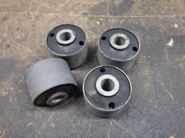

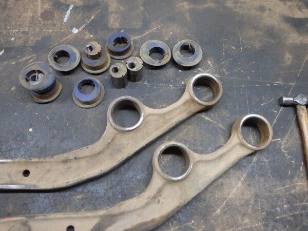

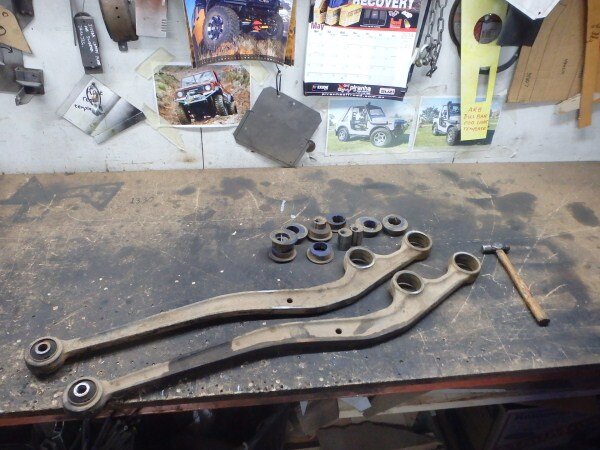

I needed to replace the badly worn Ironman 80 series castor correction bushes in my radius arms.

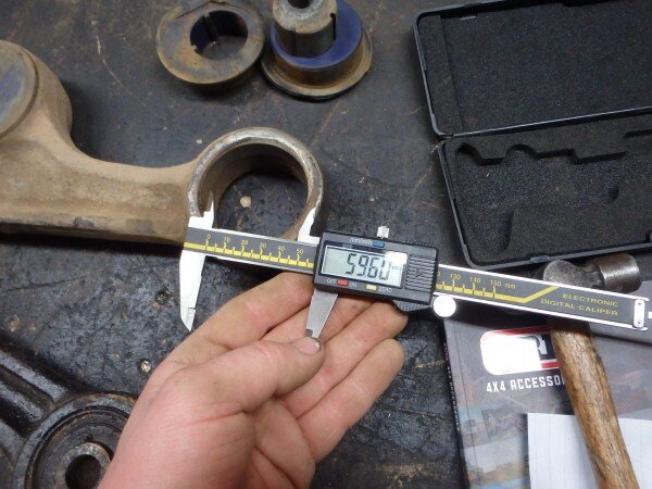

I took a spare arm in so I could measure the bushes.

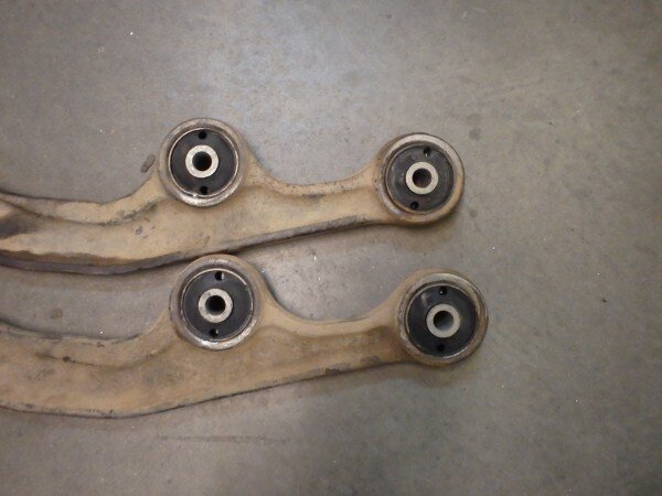

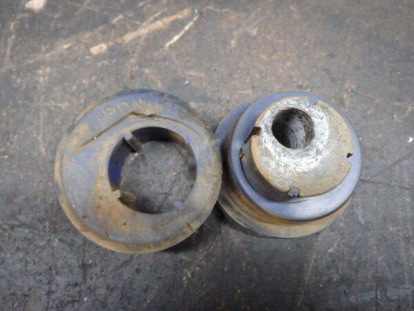

Old Ironman CC bush.
Measured up.
Gave my boss the size.

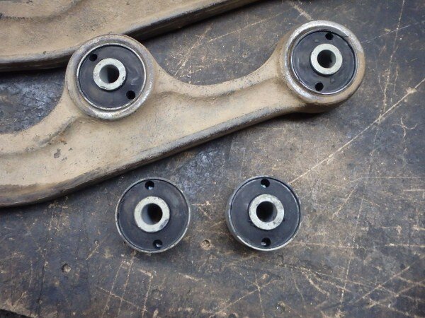

The next day the new bushes arrived.

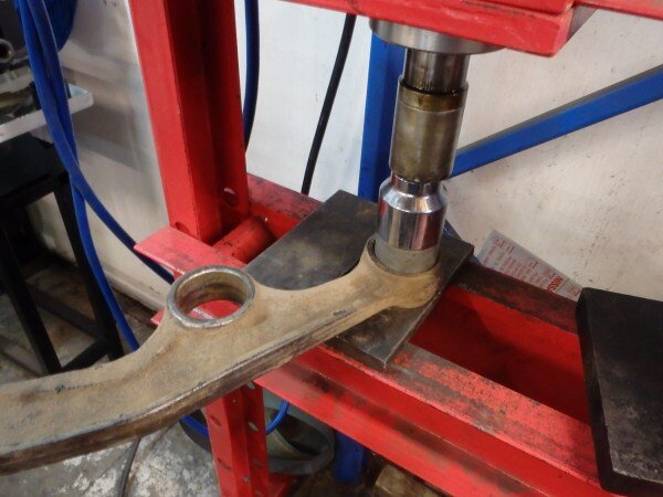

So I knocked the old ones out.
New bushes.

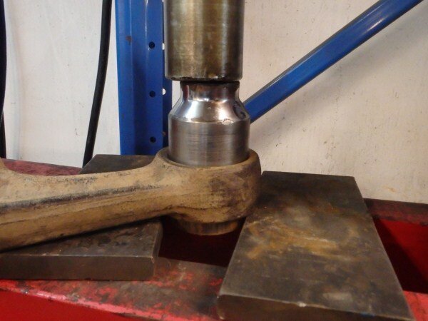

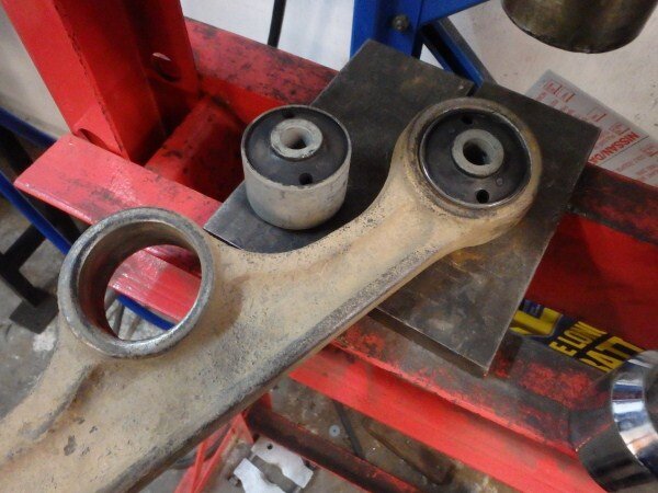

And pressed the new ones in.
I mistakenly put them in the wrong way round as I wanted the indents in the vertical plane for maximum articulation.
So I pressed them back out and turned them around.

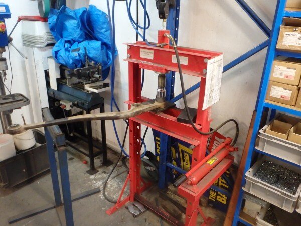

They took a fair amount of pressure to get them in.
All done.

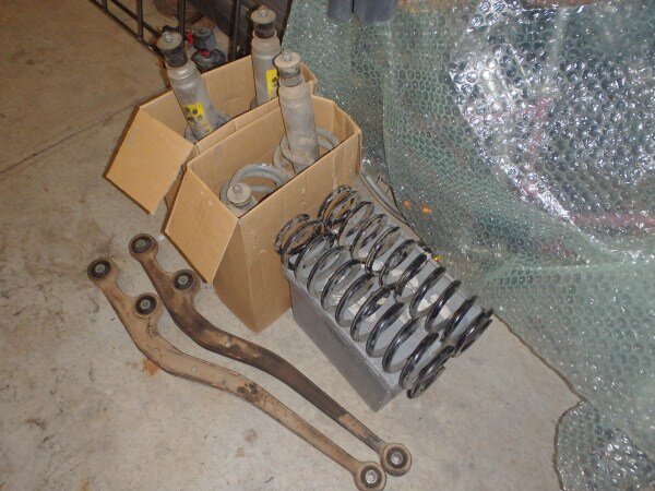

I brought home with me an old suspension lift kit off and 80 series, 79 series front coil springs and my arms with the new bushes.

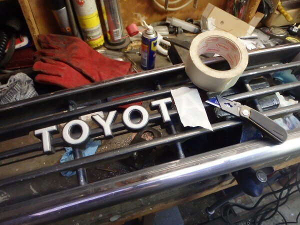

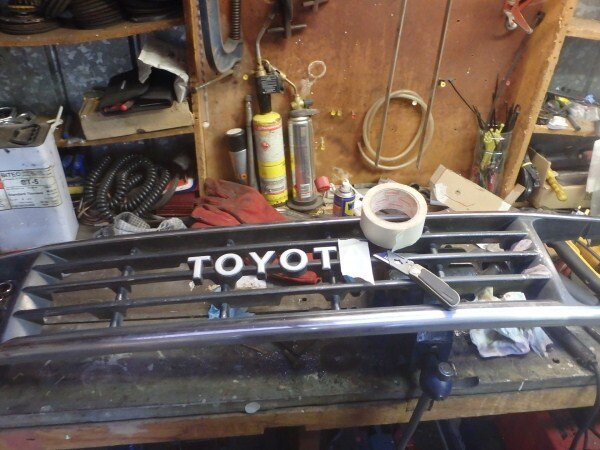

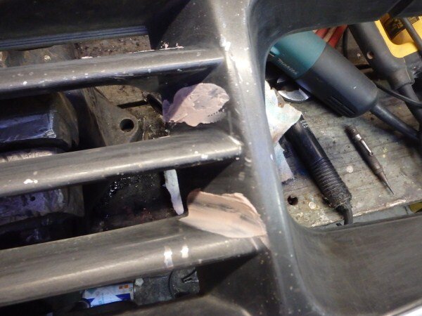

And then did some work on the grill.
Masked over the letters.
Did some filling.
Got it painted with primer.

Sprayed the grill black.
I couldn't decide if I liked the letters black or not.
Removed the masking tape.

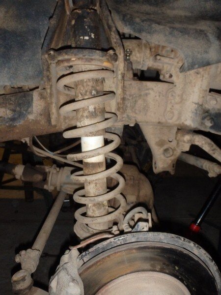

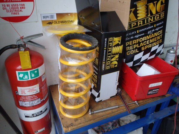

Fitted to LJ was worn out +50mm Ironman springs. Id brought home with me worn out 80 series springs and shocks and some OME 79 series front springs.
The 80 series fronts were almost the right size but was a little too wide to fit the chassis mount.
The 79 springs looked like they would fit better.
I took one my old springs off.
The other springs were only slightly taller but they had thicker coils and more of them.
The 79 spring fitted perfectly on the chassis end but not on the axle.
Because the spring perches were too big.
The bottom shock mount was totally flogged out despite me welding washers onto the axle a few years ago before I painted it.
The pin on the bottom of the shock was badly damaged.
So I decided to cut the spring perches off my axle in order to fit the 79 ones and to move the springs back 50mm. I also wanted to change the bottom shock mount.
Marked where I wanted to cut them and I wanted to do it in such a way that I can always weld the cut pieces back on should I ever need to put it back to standard.
And cut them off.

I will make the brackets at work out of 75mm angle.
I made a start on the other side.
Cut off the old spring perch.
Cut the bottom off the other spring adaptor.
I fitted both springs in place.
Tried the wheels back on.
I marked where the spring perch needed to be.
I wanted to make the bottom shock mounts next. 6mm steel would have been perfect but I didnt have any left. All I had was 100mm x 10mm.
Marked and cut 2 strips.
Marked and center punched wheret he holes needed drilling.
Drilled through with a 4mm drill bit.
Then went straight through with a sharp 14mm drill bit.
So 4 x 14mm holes through 10mm steel all on one 18v Makita battery. :clap:
I found a piece of wood the exact same width as the bottom shock mount.
I clamped the wood in place with a piece of 10mm each side. I had to position them so the spring seat would fit over them.
I ground where the weld would be both sides so that the center piece of the 10mm steel was only 3mm wide where it was in contact with the metal below.
Tack welded it.
Then repositioned it ready for fully welding.
Welded.
This is how the shocks will mount.
Ground the others.
Clamped and welded them.
Next I clamped and welded the spring perch on.
In position on the car.
And complete with springs and shocks.
Tomorrow I need to bolt and weld the new spring perches on and finish the panhard rod mount.
And hopefully get the drum arches cut and bolted on.
Then on Monday make the top bolt on shock mounts and then I can get them and the panhard rod bracket electroplated. :thumbup:

I think the Grill looks best with the chrome "Toyota" look.

I need to know what 80 series rear shocks measure as standard as I'm not sure whether the ones I have are standard height or lifted. All I know is that they are the perfect length and I want to order some new ones tomorrow but obviously need to know what size to get.
Anyone know? :icon-smile:
I had a quick look on line to find the length; I did know of a site that had the length of shocks but couldn't find it... What might work is working backwards; 80 series stock springs give a 2" lift to a 130 series 4Runner/Surf, so I wonder if the length of a shock is the same as a 2" lift shock for a 4Runner/Surf...
I had a rummage in the shed and found my old stock rear 80 shocks Ben, and from the centre of the bottom mounting eye to the centre of the top pin rubbers, i.e. the top mount plate, I can confirm that extended they measure 60cm exactly, fully compressed, they're 43cm.
Although it's not clear from my distorted photo attached, I couldn't find my measuring tape but I transcribed measurements from my toolbox lid...:icon-rolleyes::doh:

Ben, I have full data specs at work so can get those lengths to you. I have to shoot off early though for some photo shoot stuff, but if I get a quick chance I'll text you the normal 80 series front shock lengths used for a std to 50mm lift.
Looking at the pix, it might even pay to cut the dust shroud off the shocks to create more clearance. It's only a metal sleeve, and you're pretty handy with a cutting disc. You can always slip a rubber boot over the piston if you're worried about the hardened chrome but usually not an issue up front.
