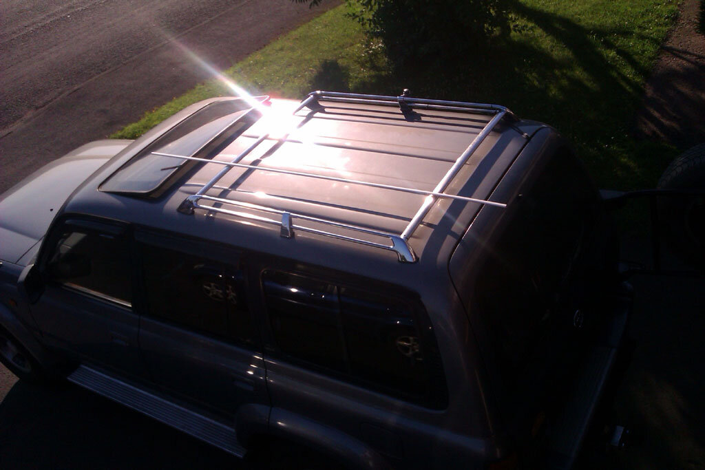

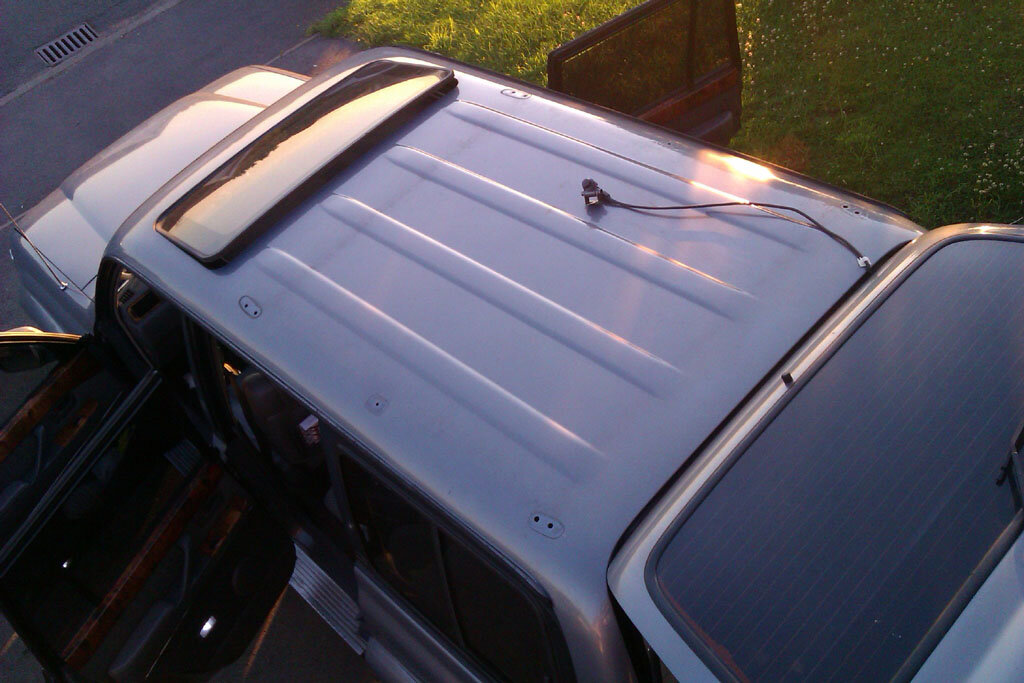

Not wanting to give chance for boredom to set in, this evening I thought I'd investigate just how tricky those bling OEM roof bars are to remove. As a reminder, these are the bars in question.
[attachment=4:1azy32oo]IMAG1118.jpg[/attachment:1azy32oo]

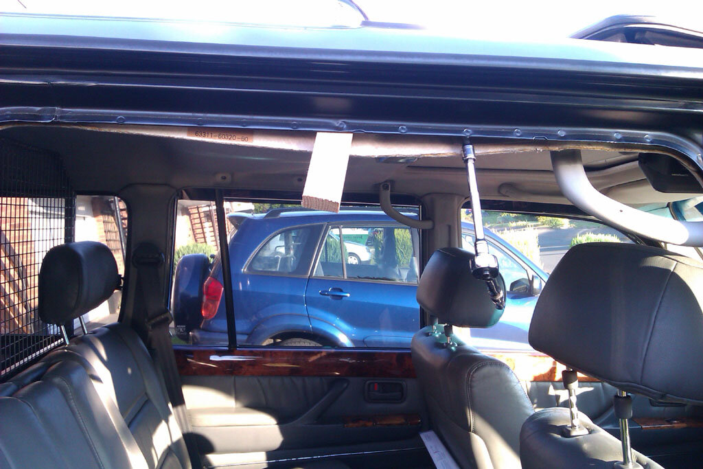

I took the door opening trim off and the grab handle so I could push the headlining in a bit to sneak a look up towards the front nuts. Seeing the nuts I though they don't look too hard to get at but what if they are seized? they would be a right pain to sort out so I'd better check they will undo, I can always do them up again :lol:
[attachment=3:1azy32oo]IMAG1122.jpg[/attachment:1azy32oo]
well that was easy enough, better check the other side and they came off easy as well so I thought I might as well just do the job instead of simply investigating! The middle mount was even easier
[attachment=2:1azy32oo]IMAG1124.jpg[/attachment:1azy32oo]
and the rear was so easy I didn't take a picture but no knuckle needed for the rears. So about 30 minutes after starting my investigation it looked like this
[attachment=1:1azy32oo]IMAG1125.jpg[/attachment:1azy32oo]
I've put some gaffer tape over the holes while I decide how I want to seal them up properly, lots of options there.
[attachment=0:1azy32oo]IMAG1126.jpg[/attachment:1azy32oo]
So start of investigation to all trim back in place and holes taped up was about an hour all told :) That's another 9kg of scrap removed, to go with the 11kg for the spare wheel cross member and hoist and 16kg for each of the 3rd row seats, not a bad weight saving to offset against some of the weight I've added.

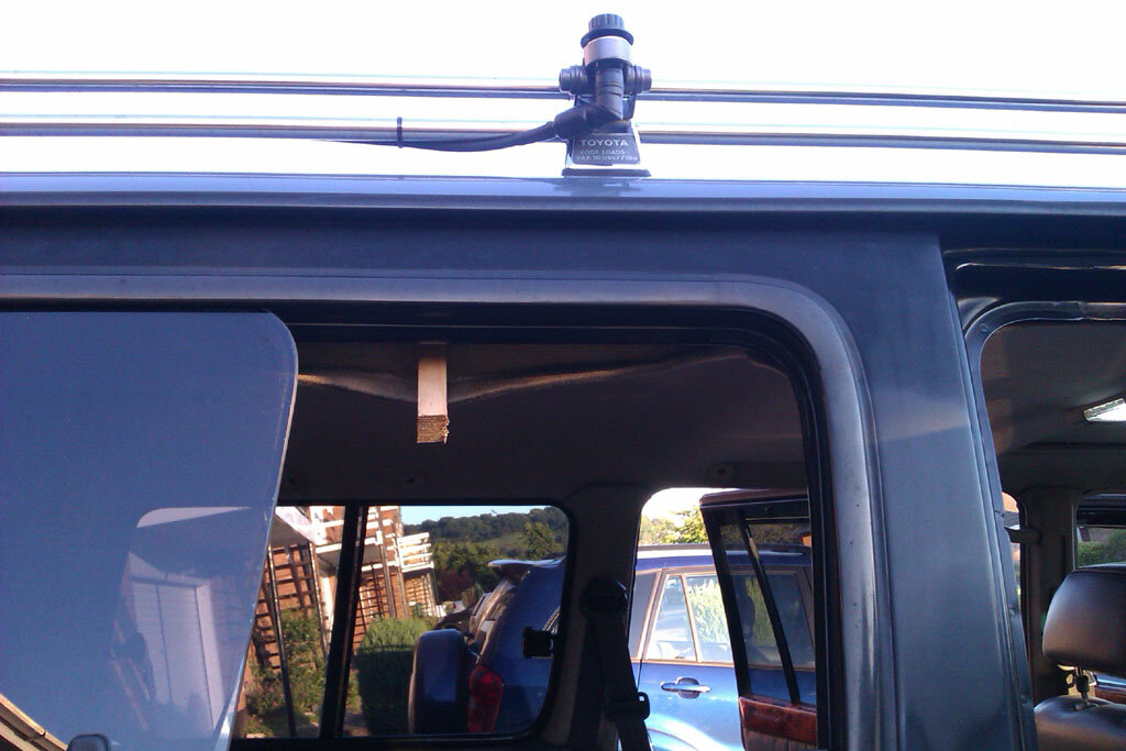

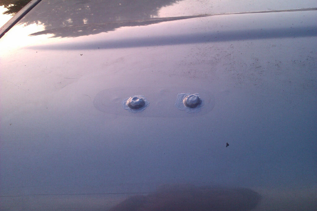

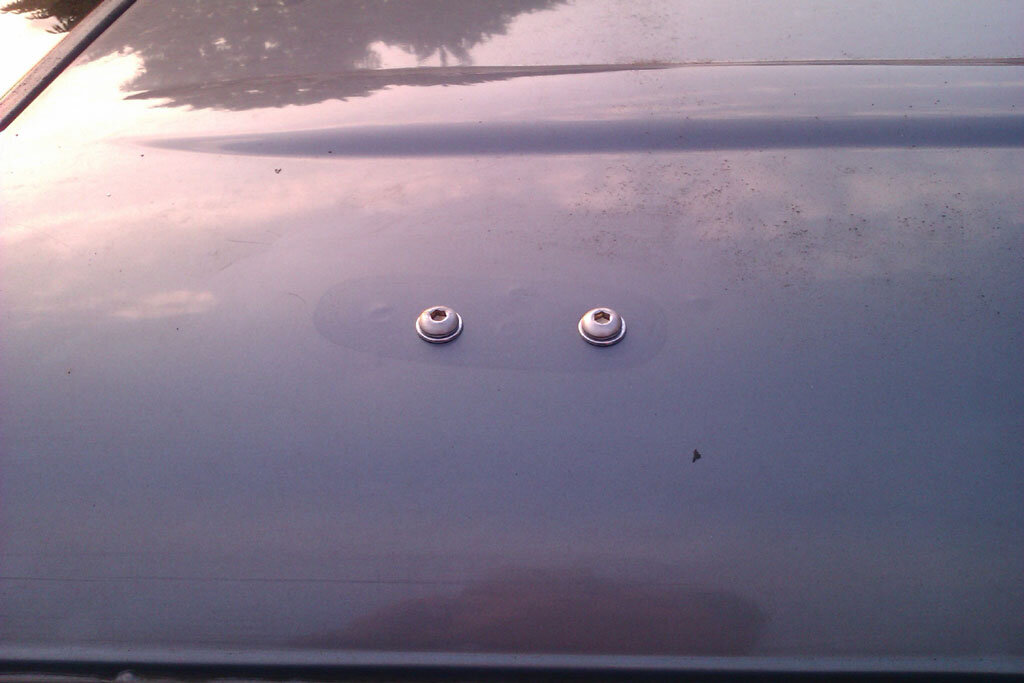

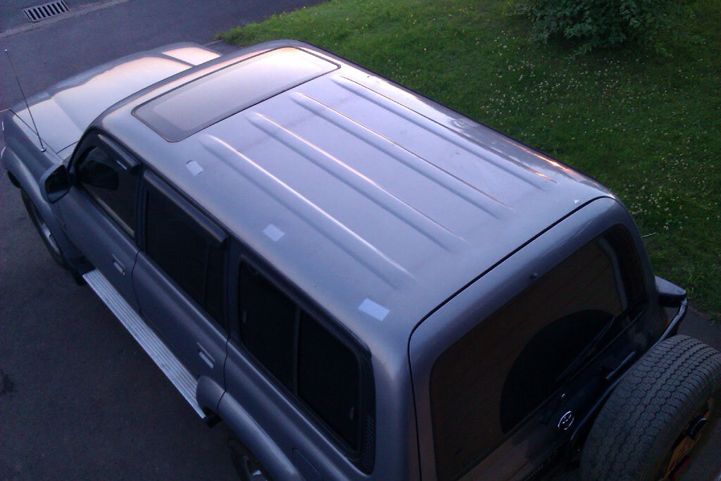

Stuck some rivnuts in the roof rack holes with a dome head bolt in each one
[attachment=1:2pce96ei]IMAG1129.jpg[/attachment:2pce96ei]
then blobed a bit of Acrypol over them to seal them up
[attachment=0:2pce96ei]IMAG1130.jpg[/attachment:2pce96ei]
Could have done something fancier / lower profile but I'm not tall enough to care :)

Jon, bit late now, but I would have perhaps have used the rubber riv nuts for that. No corrosion potential and removable.
Chris
Thanks Jon Lincomb would be great.If i get over your way before i will give you a shout. No need taking it to bits as more work for me putting it back together and time never seems on my side.
karl
I have some rubber rivnuts Chris and I don't feel the top flange is robust enough for a long term solution, very flimsy and unlikely to age well in that exposed position IMO. No worries about corrosion under the Acrypol, not unless I submerge the truck :) I could have just bridged the hole with the Acrypol but wanted something even more solid plugging the hole and I couldn't be bothered to weld them up.

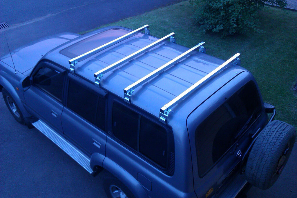

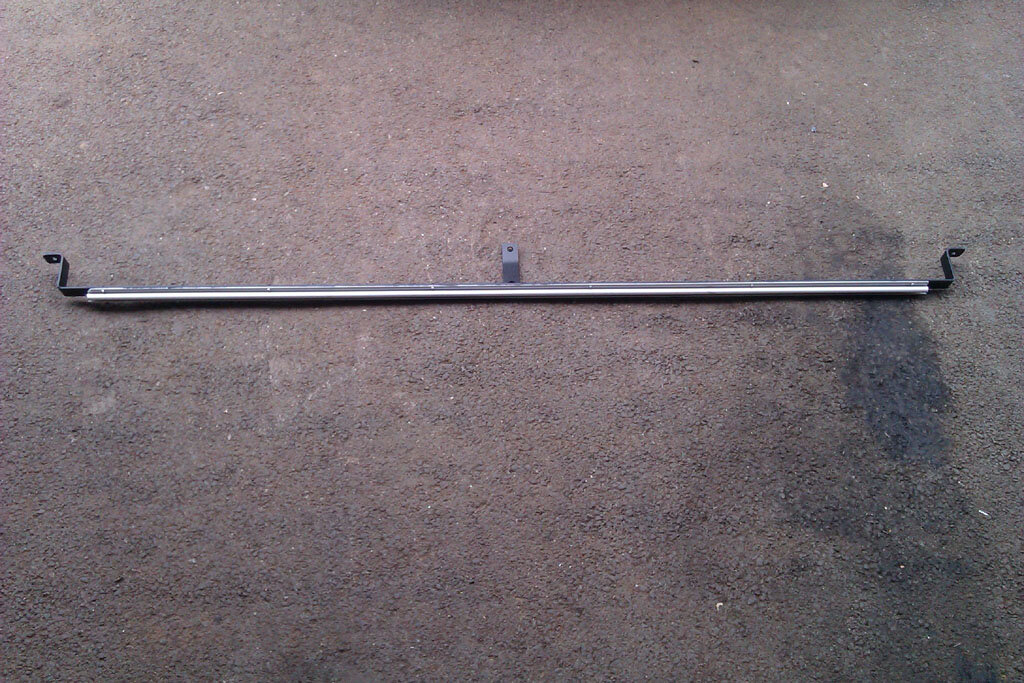

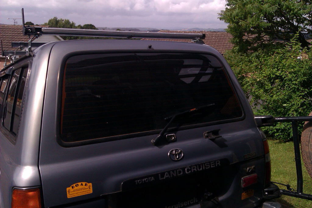

been fiddling with the BOAB roof bars, the gutter drops at the back so I'll need to make a spacer to level up the rear bar with the rest. They'll only need to be on when there's something on the roof :shifty: How wide are most peoples roof racks? I've cut these bars down to 1360 to stop them sticking out too far.
[attachment=0:knp8jqtn]IMAG1132.jpg[/attachment:knp8jqtn]

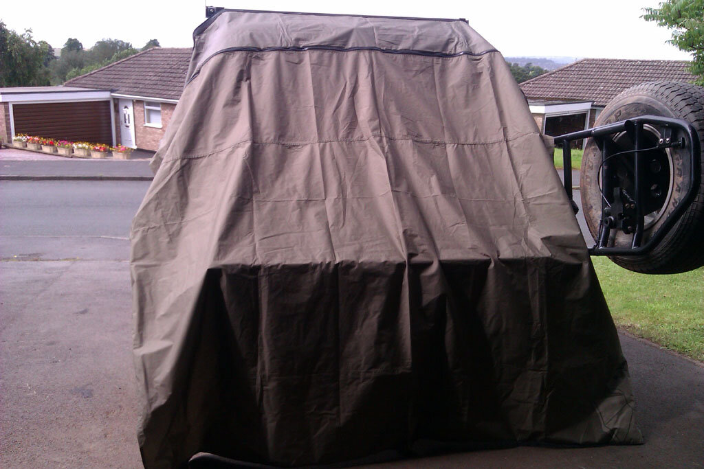

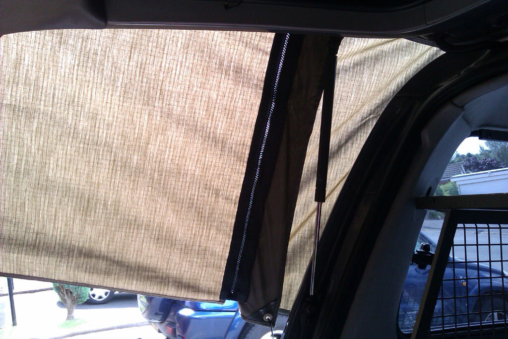

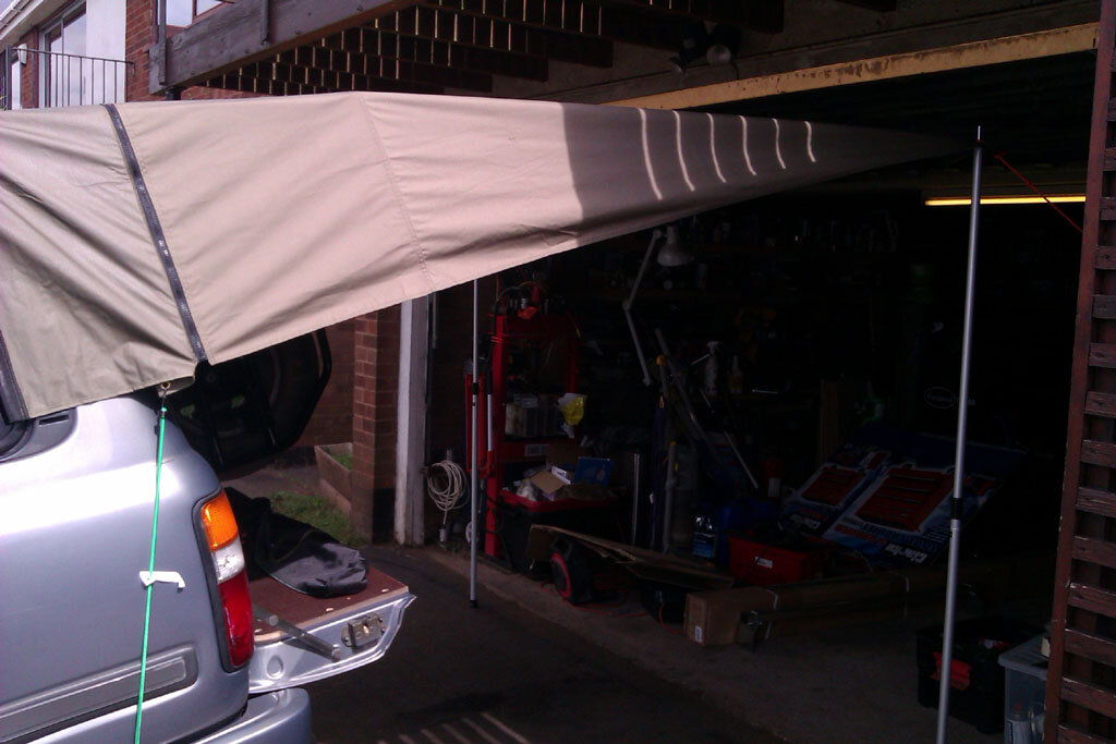

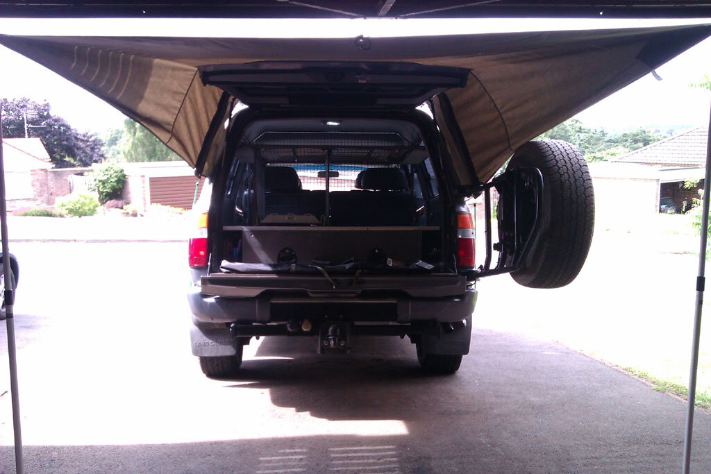

Got a FoxWing, mounts, extension panel and RV5 caravan connector from BOAB in the week. The FoxWing is great when there's space to put it out but sometimes the pitch is too narrow or you're just at the side of the road and the FoxWing isn't going to work so I like to have something to put over just the back of the truck for those occasions as well. This is something I trialed on the 100 but with an RV1 caravan connector because they were going cheap but those are a bit short. This time Chris at BOAB compared sizes for me and it turns out the RV5 caravan connector has exactly the right length zip.
Mounted a 1.2m length of awning rail onto a length of steel
[attachment=5:2axa7d8b]IMAG1134.jpg[/attachment:2axa7d8b]
bolted that to the rear roof bar
[attachment=4:2axa7d8b]IMAG1135.jpg[/attachment:2axa7d8b]
zipped the FoxWing extension panel onto the RV5 caravan connector and slid it into the awning rail
[attachment=3:2axa7d8b]IMAG1138.jpg[/attachment:2axa7d8b]
stuck the poles under
[attachment=2:2axa7d8b]IMAG1139.jpg[/attachment:2axa7d8b]
makes a good space and saves carrying a normal tarp as well as all the FoxWing stuff
[attachment=1:2axa7d8b]IMAG1140.jpg[/attachment:2axa7d8b]
because of the orientation of the zips either the caravan connector or the extension panel have to be used reversed. I reversed the caravan connector for this test and then realised that means the zip joint isn't covered and might drip when it's raining so probably best to have the extension panel reversed instead.
[attachment=0:2axa7d8b]IMAG1141.jpg[/attachment:2axa7d8b]
